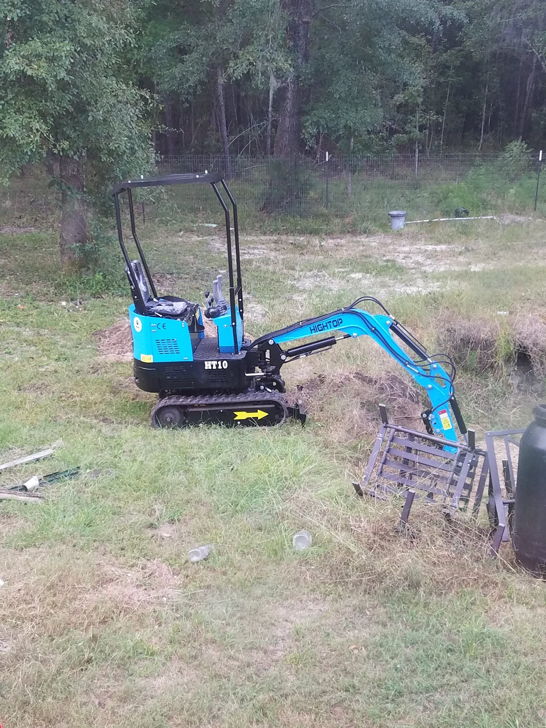

I received mine this week. Minus the frustrations dealing with Vanguard Logistics (CFS), it was pretty painless process. Everyone always suggests buying as many attachments as you can, but I figured I didn't "need" some of the other things like a wider bucket or a tilt bucket and now i've already got things i wish I would have bought those for.

Congrats. Did your Hightop come with hyd oil cooling and return filtration?
Protect your boom cylinder hoses by flipping the cyl around. Newer units have 30mm boom cylinder pins. Mine are only 25mm.
   / Importing and modifying a new mini excavator from China #315
Yes, it has the cooling and filtration on it. Feel like i need to add another fan in there to "try" and keep the engine from heating that whole compartment under the seat so much.

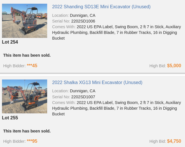

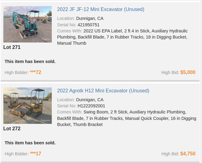

Twenty-nine of these just sold at Richie Brothers in Dunnigan CA. Around 5000 + tax and fees. I registered for the auction but missed it somehow. Probably best to miss as I do not need one anymore.
