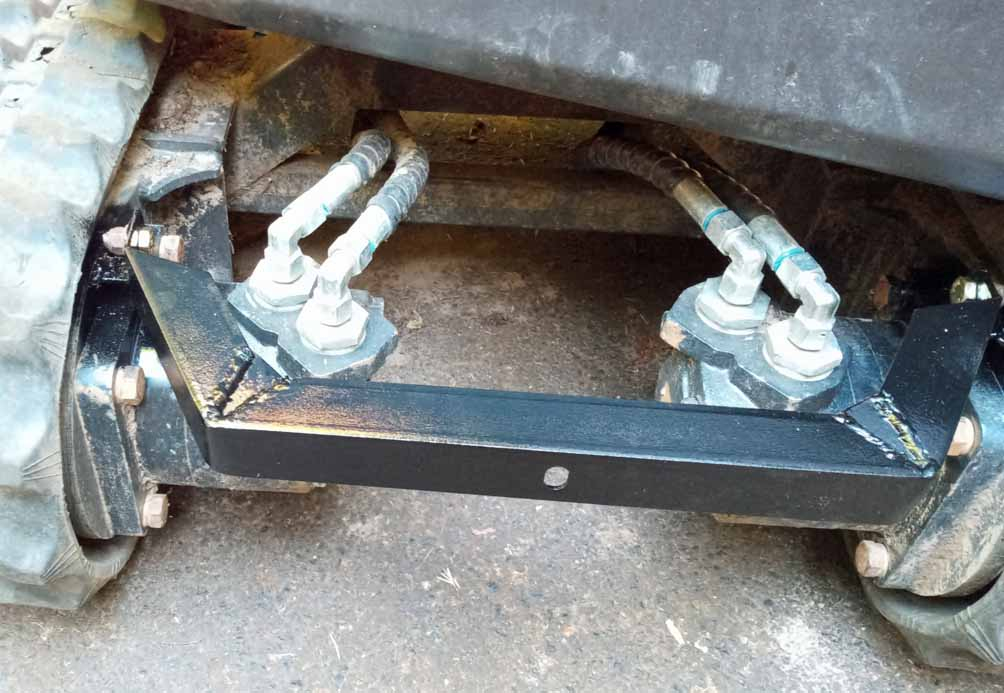

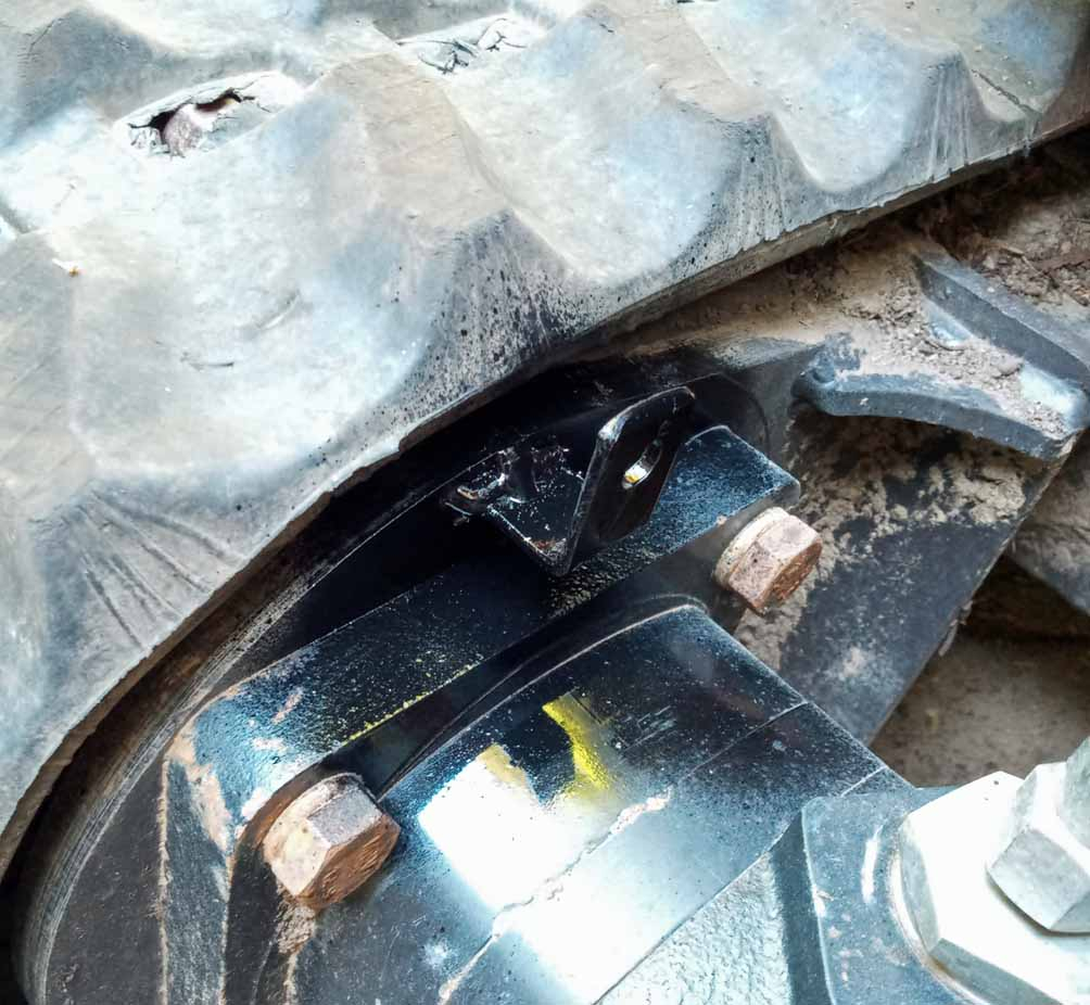

I recently completed this improvement, a guard for the wheel motors.
Whenever working on steeper slopes, as I have been doing, you will need to operate in a blade-downhill posture. That means that any rocks you dislodge will likely roll down and hit the wheel motors and their plumbing. There is no protection from that. In a few cases, I tried using a piece of plywood, but that is not ideal. I have taken a few hits, but so far, no serious damage.
With my luck, the next 10# rock is going to bend a fitting.
I welded ears onto the base frame of the undercarriage. I considered using the motor mounting bolts, but I would have to remove the tracks to get at the nuts. BTDT. No fun.
The guard is just a piece of 1.5x1.5x1/8" angle steel, salvaged from the shipping crate.

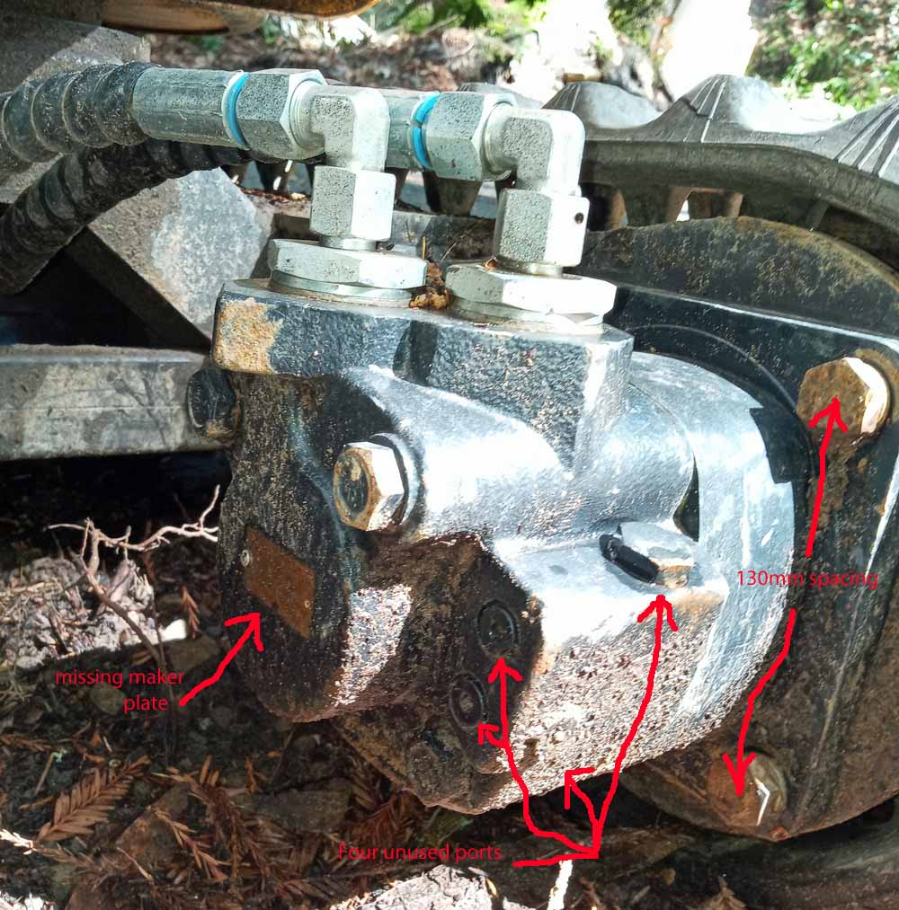

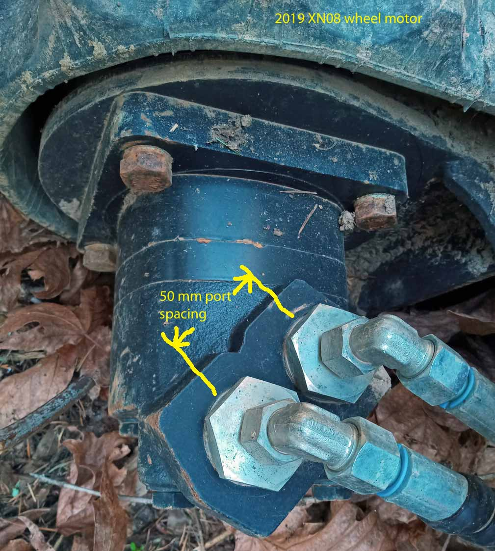

Another improvement found on some of these machines are wheel-braking valves, which are essentially cross-over relief valves on the return side of the hydraulic motors.
My unit does not have these, and that allows the unit to travel too fast when going downhill. This is not really an issue if the tracks are not directly-driven by the hyd motor. In that case, there are planetary gears in the final drive, in a gearbox full of oil. That is the way larger excavators drive the tracks.
My motor does not have a maker plate, but it does have unused ports. I fantasize about adding braking valves.

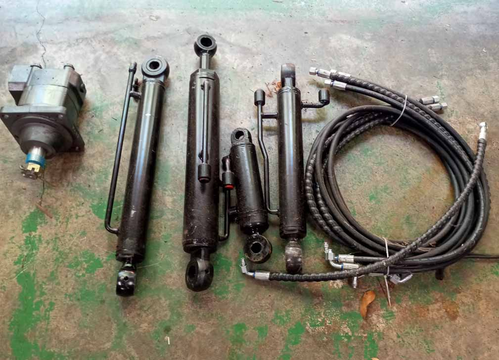

I bought a lot of spares, which seem to be of decent quality. Selling them off now. I even bought an extra 8-spool stack valve, the most expensive part of the whole machine.
