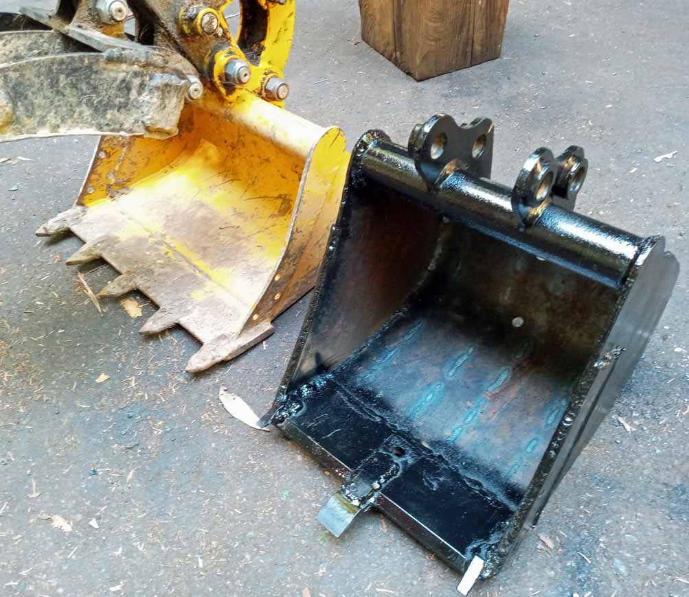

Congrats. Hope you get a good machine. Jason has sold all his inventory. He is supposed to bring a unit over here again for me to test and adjust RV pressure setting.
I have recently completed making of a new-and-improved bucket, which I will share with factories. I will start another thread about the fabrication.
