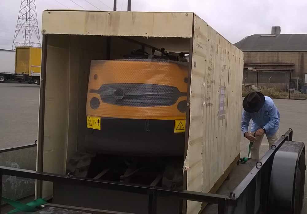

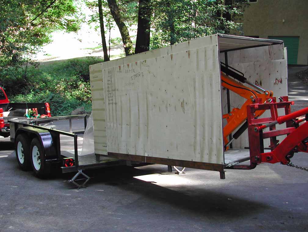

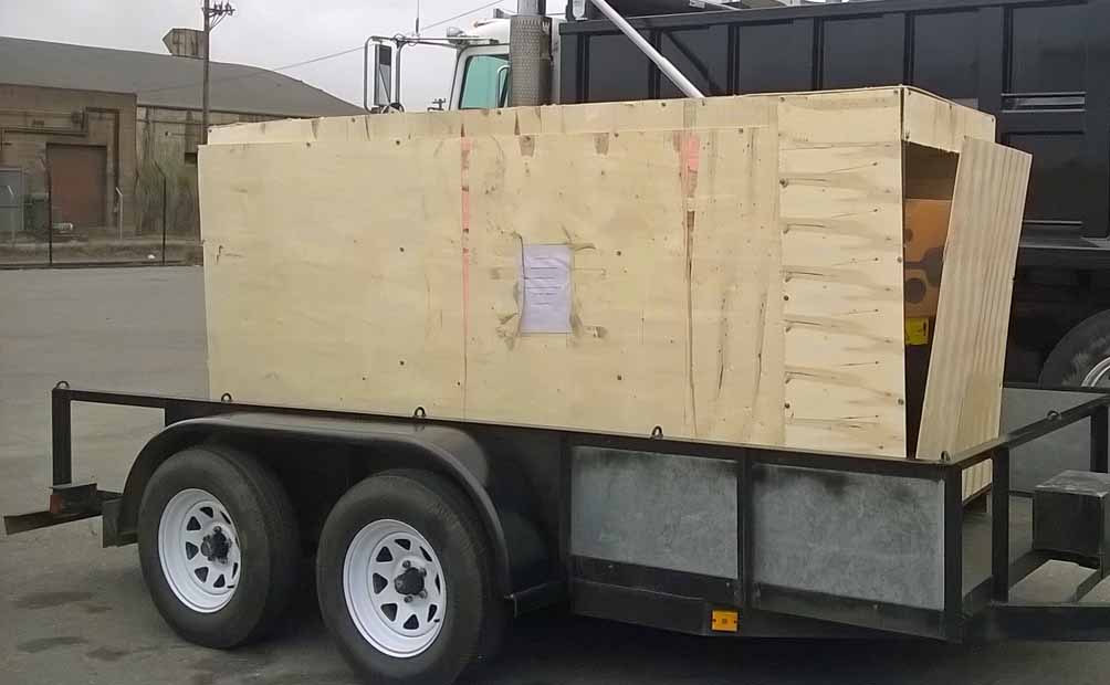

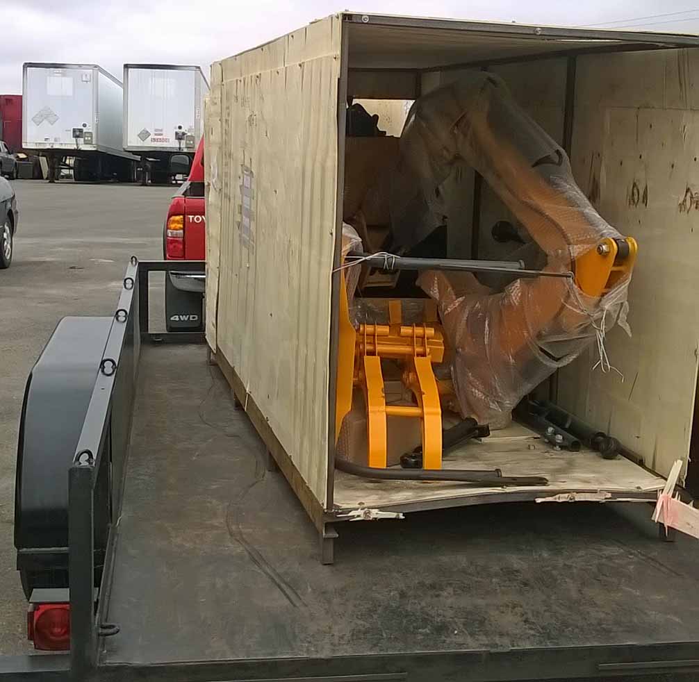

But back to my XN08. Since I received my unit partially disassembled for shipment, I did not fully assemble it
until I finished all my mods and testing. Complete pix and 5 videos on my Utube page will be linked at the
end of this thread.
