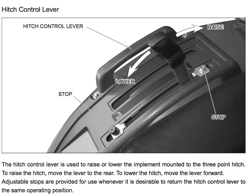

Interesting. Not the way my dealer explained it. Maybe it was unclear to him, too. If I hold, it moves slowly. I'll have to experiment now to see if I can find that spot.
Bruce
Mine did that to when I got it, thought it was like you said and just had detent's, did a little research and found out there's more to it (otherwise why have tractors without it) found mine out of adjustment.
Once adjusted it will go up about 1/4-1/2in at the ends and stop, even if I'm holding it against the stop, that's why the stops are adjustable.
My dad's older bx has non adjustable stops but no inching valve.
I've found a lot of salesmen (and dealer techs) don't know their product very well.

Position control means there is feedback to the 3pt control as to position, it allows one to repeatedly drop the implement to a predetermined point, also allows it to compensate for leakage. It's very handy if you are doing things like spreading and can constantly drop the box blade to say, 3in above grade for example.
My tractor has a 1/4inching valve, basically it's has a detent that allows approx a 1/4in of movement, other then that it operates similar to a single acting valve where it holds one you center the valve.
I wouldn't buy another tractor without it.
Excellent explanation. Lot's of misguided information above for readers trying to understand the topic. :)

Close but on #4 it is just a stop you can pull the lever against to only allow the small adjustment, if you bypass the stop it acts like a normal valve, no need to bump it unless you want to.

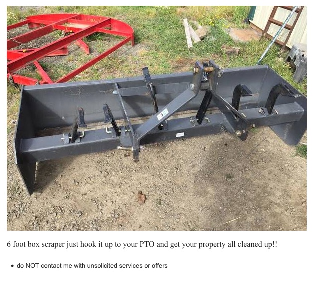

Ive been wandering lately what difference position control on the 3 pt. hitch makes. I've noticed that the B seriers tractors now have it, but the bx series still do not. My main use would be box blading or using a land plane to smooth out areas of the yard . I also plan to get a tiller and wasn't sure if it affects that or not. Thanks
Position control is very nice for tilling and mowing as it allows you to repeatedly return to a specific height simply by remembering what number you were using.
For example, I mow in 4. I do not ever have to look back at the mower to set height.
Once I'm in the field, engage PTO and set 3ph to number 4 and mow.
With a quarter inching valve, every time you lower the mower, you have to look back to see and set the mower height.
It is helpful with a box blade but not as much. A quarter inching valve works well with a box blade.
With a box blade, top and tilt is more important then the type of 3ph valve.

Position control has absolutely nothing to do with detents.
Position control is closed loop.
A quarter inching valve is open loop and has no feedback.
