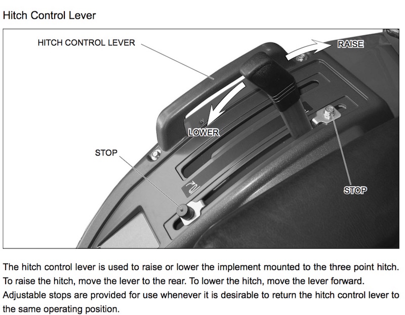

Well mine stays in place due to friction just fine. Hard to believe any control lever would NOT stay where you put it???? But there are no detents or markings.
Hmmmm, I suppose I could just draw some markings on a piece of tape and stick it on.
If that image is representative of your tractor then you have a position control valve.
As you mentioned, you can just add markings.
I dont have an image handy, but mine looks similar to that image just with the numbers 1 - 8 between the upper and lower symbols.
/ importance of position control #64
Found an image online of the L Kubota position control lever.

Also as was stated you have position control per your picture.
