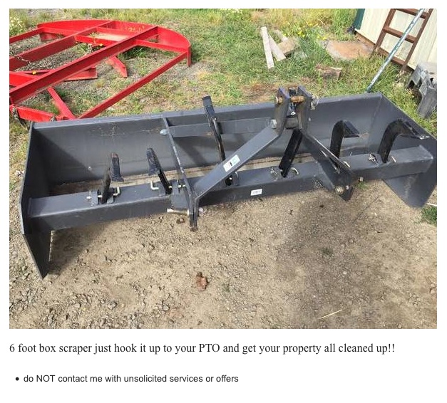

Maybe it's like the people that misuse terms and it gets ingrained in them. My biggest pet peeve is the people that call a 3 point hitch a PTO.
Off topic, but this would be fun to watch on the PTO. From a CL ad.
