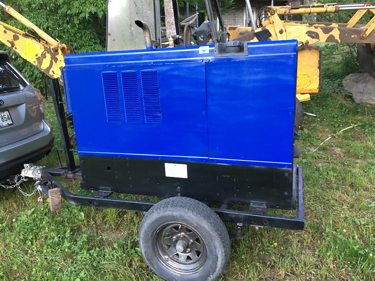

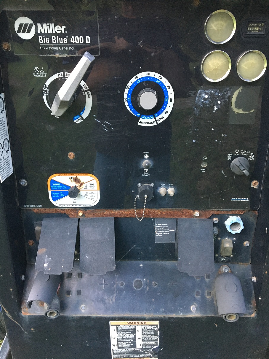

Got to brother in laws....brought home a "Miller Big Blue 400". On its own trailer, diesel engine... my other guy has been sending me a text saying he needs to get here to assess the situation (yes!)...
So again, one way or another something is going to happen. I'll happily buy a welding helmet if that's what it takes. I've got some other things I could practice on (if I end up doing something.....I am after all.....kind of stubborn)
If my guy comes, then the sooner the better! I don't yet have the rebuild kit for the cylinder so I'm not losing any time that would not otherwise be lost so I'm still pretty patient about it.
Heck, maybe we'll all have another several days we can yack about this while the ball sits in place... (sigh).
Lest anyone become concerned about the loader bucket hanging in the air while this is being worked on... it's not. You can see the large rock I placed there as my support for it.

Hope you're not asking me what size.... First, It's going to be metric. The sheared bolt itself appears to be about 1/4, maybe slightly larger on the shaft.
The OTHER end of the cylinder has the same pin and bolt system to attach.....so I have a perfectly sized bolt that I can sacrafice. All I'd need to do is take the threaded rod (for the OTHER end that is intact) to store to get a nut for it.
