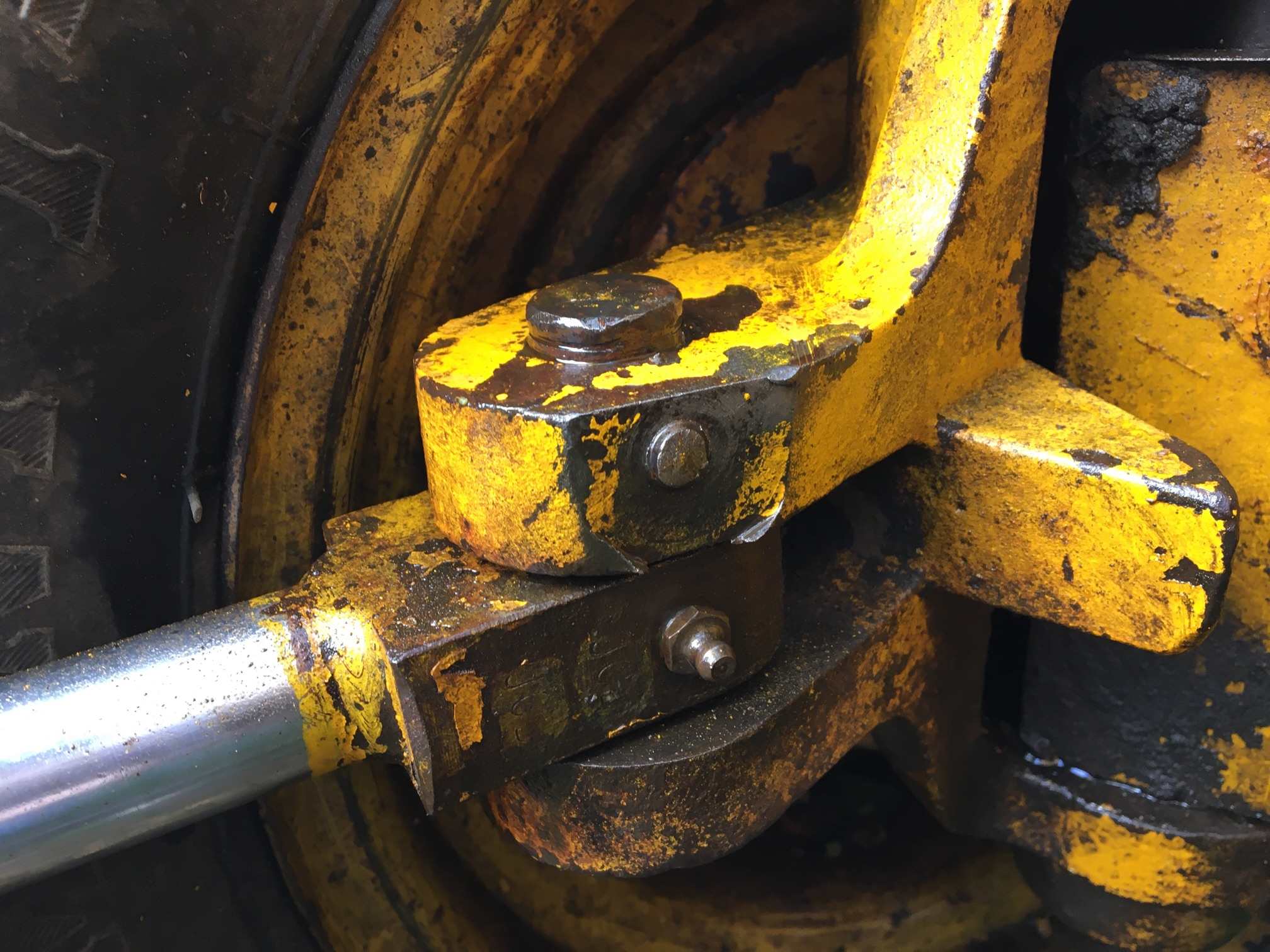

If the third picture is a photo of the bolt head that got twisted off, then it's the funniest looking bolt I've ever seen. Looks to me like a piece of all-thread with a jam nut spun down a few threads to lock it in place.
Anyhoo, you are going to need lots of heat and a set of left hand drill bits.
No, that is the assembly that holds the OTHER end on. It (evidently) consists of a short, what I will call, threaded rod ONLY. The pin goes into hole to hold the cylinder in place, then this "set screw" screws in from the side (as per the early pictures) and goes into the pocket that you see on the pin. Then you use the jam nut to lock it on the structure.
I don't care how this looks..... machine is from 1987 and visually, beat to snot (though it runs like a swiss watch).
Notice the grease zerk. I've owned this thing for probably close to 20 years now. I can guarantee you that has never been greased in 20 years. Notice how, if you swing the cylinder out, the zerk hides away to the INSIDE. I never even knew this existed. Another reason I have to get this off (slightly bent rod is first reason) but, I want to get the zerk to the outside so it can be greased.... at least once every 5 years!!
Right on...I'm stackin' the wood you're cutting.
I think you're right...someone had the cylinder off once upon a time and they put it back together wrong (grease fitting inaccessible).
Yup, that's a set screw. Makes the job a whole lot easier as it's not threaded into the pin but simply sits in a dimple. This means you only have to drill a short distance to get to the dimple and yes, if it is a true setscrew then it's a Grade 5 or 8 equivalent. If it's all-thread then Grade 2.

Your idea to cut a slot in it and try an impact driver might work. The problem with trying that is if it doesn't work it may become difficult to get a flat spot to center punch it for drilling.
Personally I would grind it just enough to get it flat, center punch as near center as I could get, then drill a hole all the way to the shaft. After that, work the outside with a hammer and chisel. If it doesn't come loose then keep going up on drill size until you almost hit threads. Getting dead center and drilling all the way through the bolt is key to success whether you tap it out with a chisel or pull it with an extractor.

Been spraying it with Penetreat for couple weeks now.
After a couple of weeks I would change formula (to PB Blaster, Kroil, ATF & acetone, etc.) just out of frustration.
Heating the male part (the "set screw" or "bolt") expands it and makes the fit tighter. Heating the female part ("yoke") would enlarge the hole and make the fit looser. Problem is that conduction transfers the heat from one part to the other so there is little relative motion. Several (many) heat/cool cycles MAY do something to loosen the rust. I would try to heat the yoke with the torch and then cool the bolt. A trick I have tried is to freeze water in a short, straight length of tubing about the diameter of the male part and hold the "icicle" against it using a dowel as a plunger. (Heat from my hand holding the tubing melted the ice enough to allow it to move.)
This presupposes you have a way to turn the bolt. Grinding a slot as suggested may work. I have sometimes drilled 2 small holes, say at 9 and 3 o'clock, and then used a small center punch to alternately drive down on the left and up on the right holes. The impact of so doing seems more effective than the more even force of a screwdriver, bit with breaker bar, etc.

A bit of a (meandering) update.
I've hit it with a center punch to attempt to start a dimple..... the punch got blunt on me.
I've tried to drill on it.... perhaps I'm expecting too much too soon.... but the bit didn't scratch the "bolt"
I've banged on it with a chisel to try to budge it. After all, I KNOW it's not in much of a tension mode since it simply tightens into the pin.
I've heated around it (only have MAP gas)
I said I've sprayed it with Penetreat.... I got that screwed up. I sprayed my LOGS on my home with Penetreat..... I used PB Blaster on this.
Oh, and I like the ice idea! I have tried heating around it and then squirting PB Blaster directly on the bolt hoping that would do what (I think) your suggesting the ice to do.
I don't have the fix kit yet to rebuild the cylinder so I'm still on "down time" but right now, this thing is nothing more than a yard ornament in the front yard and you might imagine what the wife is starting to say.....
Also, things to do around here and I can really use the bucket.
I'm chasing my tail right now. Know a guy with a fabrication shop several miles down road. He said he could come by and do it.... then h as disappeared and I hear crickets.
My wife's brother has a welder AND he's coming here (from New Orleans).... I thought this weekend but it might not be for two more weeks.
So I debate all that verses just buying something and moving on. I found a stick welder but I concluded it wanted to be plugged into a 50 amp circuit. I don't have one of those and am unsure the issues of putting it into say a 30 or 40 (I have several open slots in my garage and can add one quite easily, in fact, I probably already have some breakers laying around)
Got to thinking just this morning..... can I go RENT one!!?? Then I again, chase my tail.... money to rent verses a bit more to just buy.....
If I don't get something done soon, this might turn into the Pallets in the Field thread..... :eek:

Sounds like either a grade 8 bolt or an actual set screw. Either will work harden if your bit is dull, and then it's almost impossible to drill with anything short of carbide. Speaking of which, a masonry bit (not chisel point) can work in a pinch. I'd try the slot and impact screwdriver bit. As far as welders, be aware that welding outside with a wire machine limits you to flux core wire
if there is much of a breeze. Stick welding a nut on what looks to be a 3/8" bolt is going to be tuff for a novice. Welding a washer and then the nut to the washer is easier.

Go to the hardware store and get yourself a cobalt bit or two. I would start with a 1/4".
Do not put constant pressure on as you drill. Release pressure on the drill periodically. Use a slow to medium speed that won't overheat the bit and metal. Don't let the bit bind and break off in the hole. If it starts to catch slightly increase speed and reduce pressure.
Try to drill all the way to the pin.

OP, the way that bolt is stuck in there it has a large heat sink. That welder may not have the guts to weld to that. I don't think anyone aside from a experienced weldor should attempt welding to this bolt, too easy for a beginner to make a mess.
I would grind it concave so a center punch won't drift off center. Then with better quality tools, center punch, drill (with left hand drill if available), square ez-out. If that won't do it, clean up the flammable hydraulic fluid nearby and bring in a professional weldor to weld on a washer then a nut on top of that.
