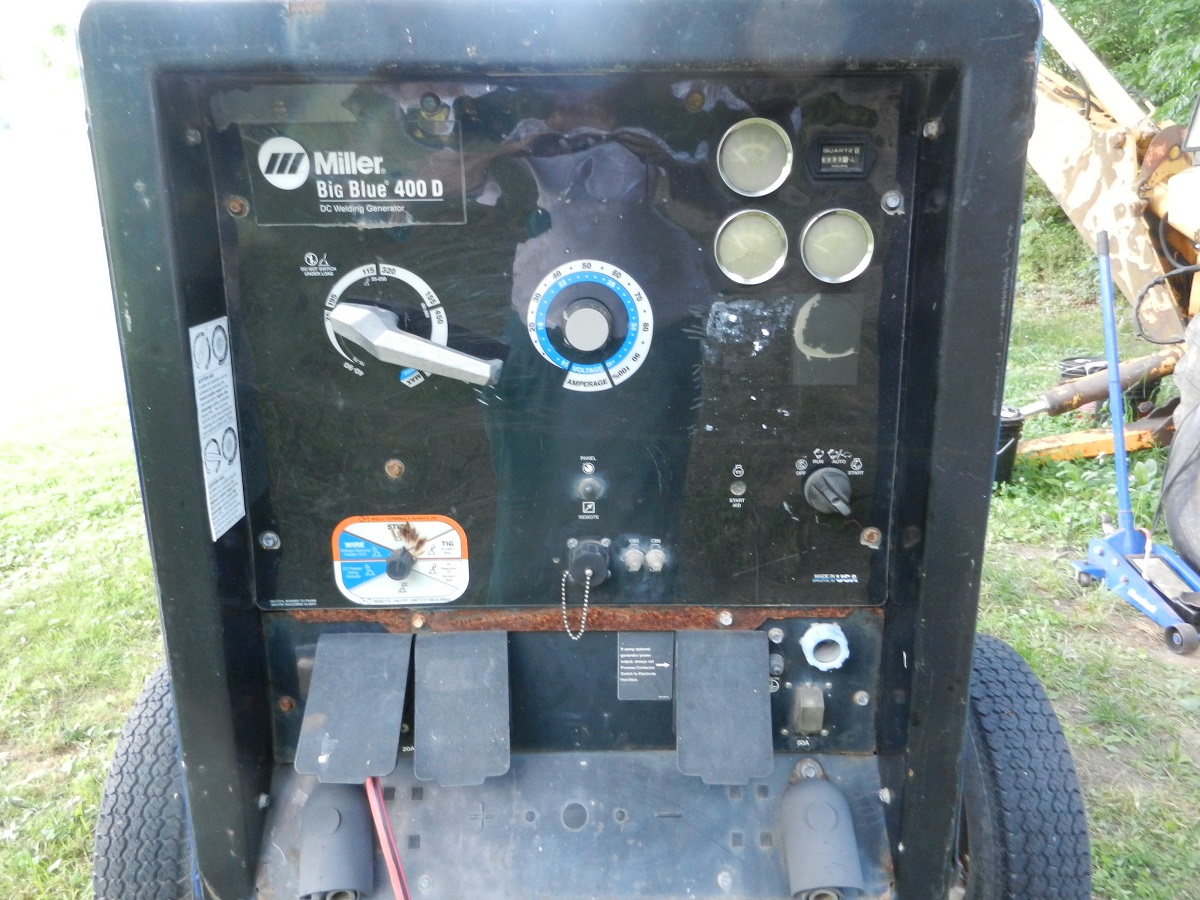

3. We have a Miller 400 amp welder there that is also a generator so we've got most/all of what we (he) needs.
4. He's going to first, attempt to weld the nut and see if we can back it out.

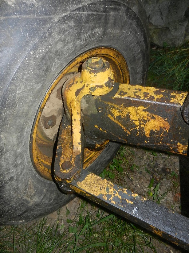

Worked on this thing most of yesterday AND today.
My fabricator buddy came over. Brought his rosebud torch.
1. We tried to drill out that bolt. (I forget the name, Beetle plug? something named after an insect) Anyway, snapped & shattered about 4 bits before we went to the second plan.
2. Second plan was to cut the pin above, below so the bent arm can now be removed and we'll figure out the sections AND how do we now remove the drilled and still stuck lock bolt?
3. Ended up cutting the pin out. Lower section was able to be banged out finally (FINALLY!!) decided to remove Pin that connects two front wheels for steering purposes.... had to heat it, bang it......finally twisting it, broke it free and got it out.
4. I finally took front tire off so we can have free space
5. Nothing going on with the pin....I made a comment of why not remove Kingpin (which really needs to be replaced AND I happen to already have the replacement kit)....so remove king pin, take entire knuckle over to his shop where he's got his serious tools.

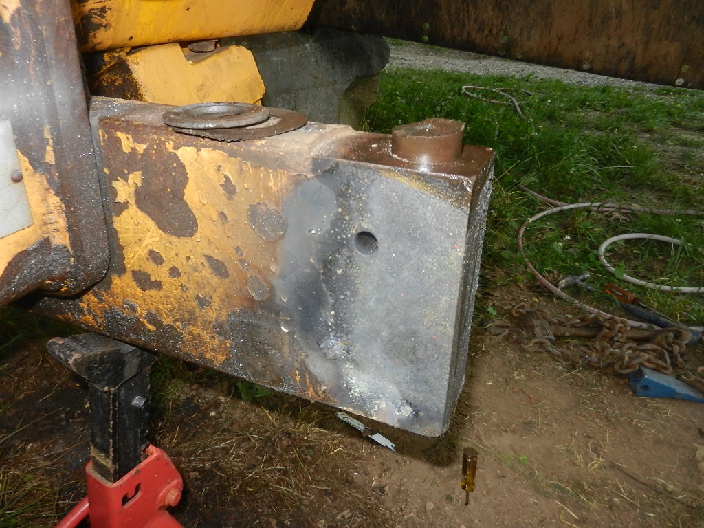

6. Started on the King Pin....Applied loads & loads of heat to the axle and the pin just laughed and laughed at us.
7. Spent probably 3 hours with a 7" grinder, Sawzall (carbide blades), 4" grinder (WITH 7" cutoff wheel.... I know I know.....)
8. FINALLY got the king pin cut on top, cut on bottom and got knuckle off (drove it over to his shop)
9. Before we cut the Kingpin, he welded a spare loader bucket tooth I had to the top of it to see if we could rotate the Kingpin.... brought my neighbors John Deere (?? about 40 HP) and attached my chain to the now, perpendicular tooth.... he pulled forward and rather than rotating pin, it pulled tooth off, TWICE. THEN I decided to just cut the SOB.
10. Left as much as I could of the Kingpin. My pal is going to get some steel that he has, cut a matching circle, WELD this entire thing as contrasted to the tooth for my loader bucket (this part is pending)
Hopefully the bar will be 5-10 feet long for a lot of leverage....

This welder my brother in law brought over... has been a life saver. It's been used more for the generator than welder. I didn't have to use the contraption I (so crafty) made with the 8-3 wire and 20 amp circuits. It's probably a good thing we didn't need my contraption.

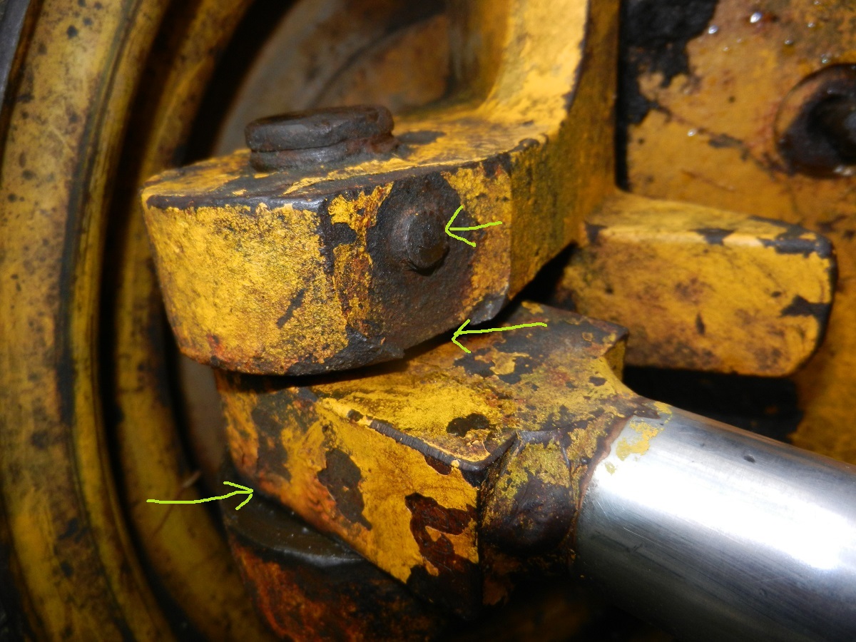

They were calling this a grub screw. It turns out it's just a (let's say) one inch length threaded allen screw. You tighten it with an allen wrench into the pocket on the pin that actually does the holding. Then, you have a jamb nut on the outside that locks the grub in place.
Hard for me to see how the exterior portion of this could be snapped off but, it's certainly gone. Took the same pin out on the connecting rod that attaches the right wheel to the left wheel so they both turn..... and we had to torch that too. I had sprayed some Kroil (on all these parts) and you could just tell it wasn't going to budge until the heat hit it.
I've owned this machine (built in 1987) since roughly year 2000 so I've had it for something like 20 years. All I can factually vouch for is none of these steering pins have been touched/removed by me during my 20 years.
It really is curious to me how that grub pin got sheared off since it's so short.
My guess is that the jamb nut was over-tightened when installed and it cracked the allen screw.
Over the years the crack got bigger until it fell off.
