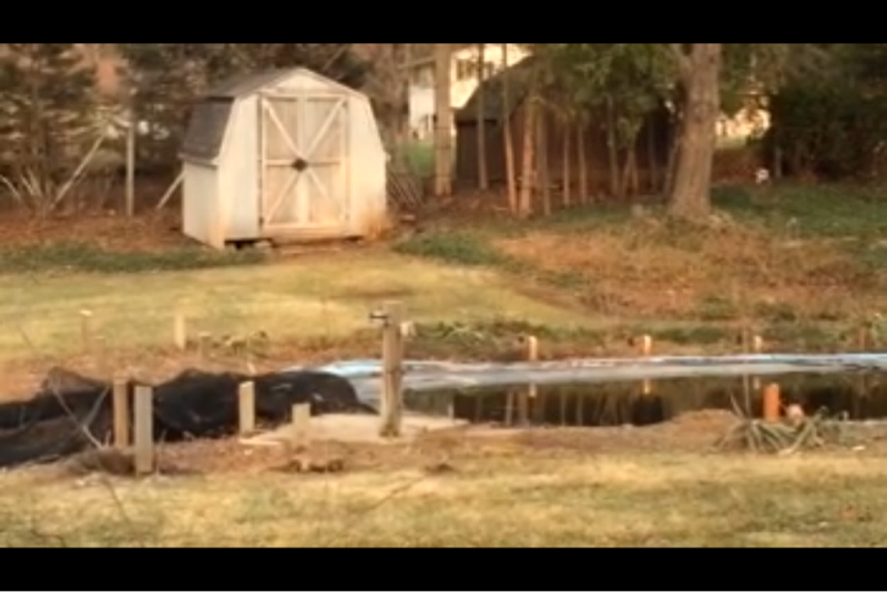

I was contacted by a friend asking to pull some posts. I have only attempted 1 post in the past screwing around and was unsuccessful. Please post pictures or videos of pulling posts and or suggestions. Thank you

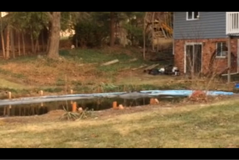

From your photos, you will be working in an area where you will need to be extra aware, near the pond. If water soaks in around he post it may be more difficult with the "suction" action, drive a bar down beside the post, then remove to negate that.

Those look like square timbers that were possibly concreted in. Sometimes the post will pull out of the concrete and then you will have to get a backhoe to dig those out if you want to remove the concrete.
