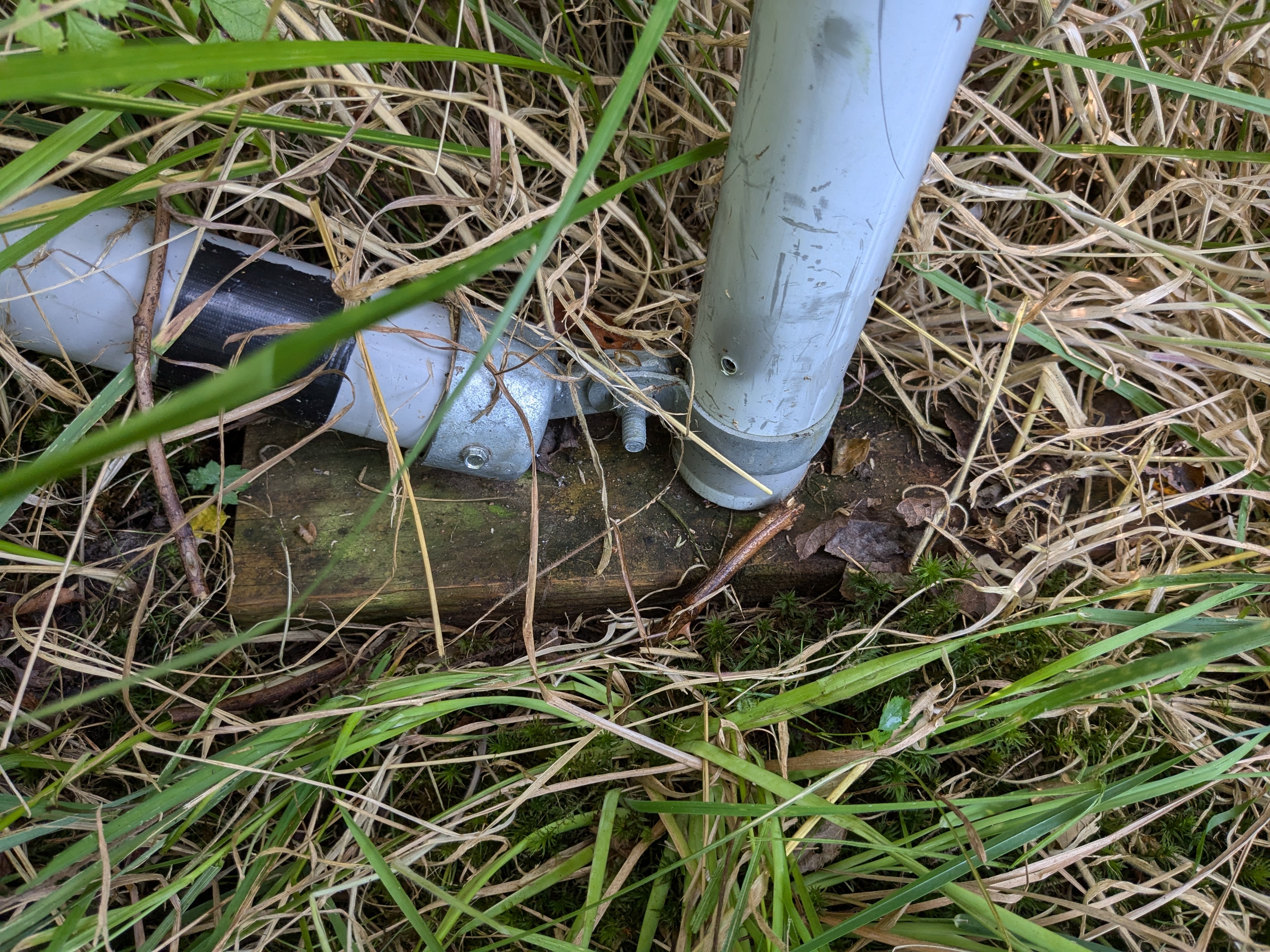

I found it works better if you turn the bracing post 90 degrees so the spade is perpendicular to the direction of pull. The brace post is more stable if you take a 12" piece of treated 2x4 and drill a 1-5/8" hole in it:
Then slip that over the post so it sits between the spade and the PVC. Drive the post deep enough so the wood is resting on the surface:
What I like about these corners is I can install it with a post pounder and a wrench. They are pretty strong. I tension my field fence with a come-along. If I apply too much force the corner post will bend before it pulls out of the ground.

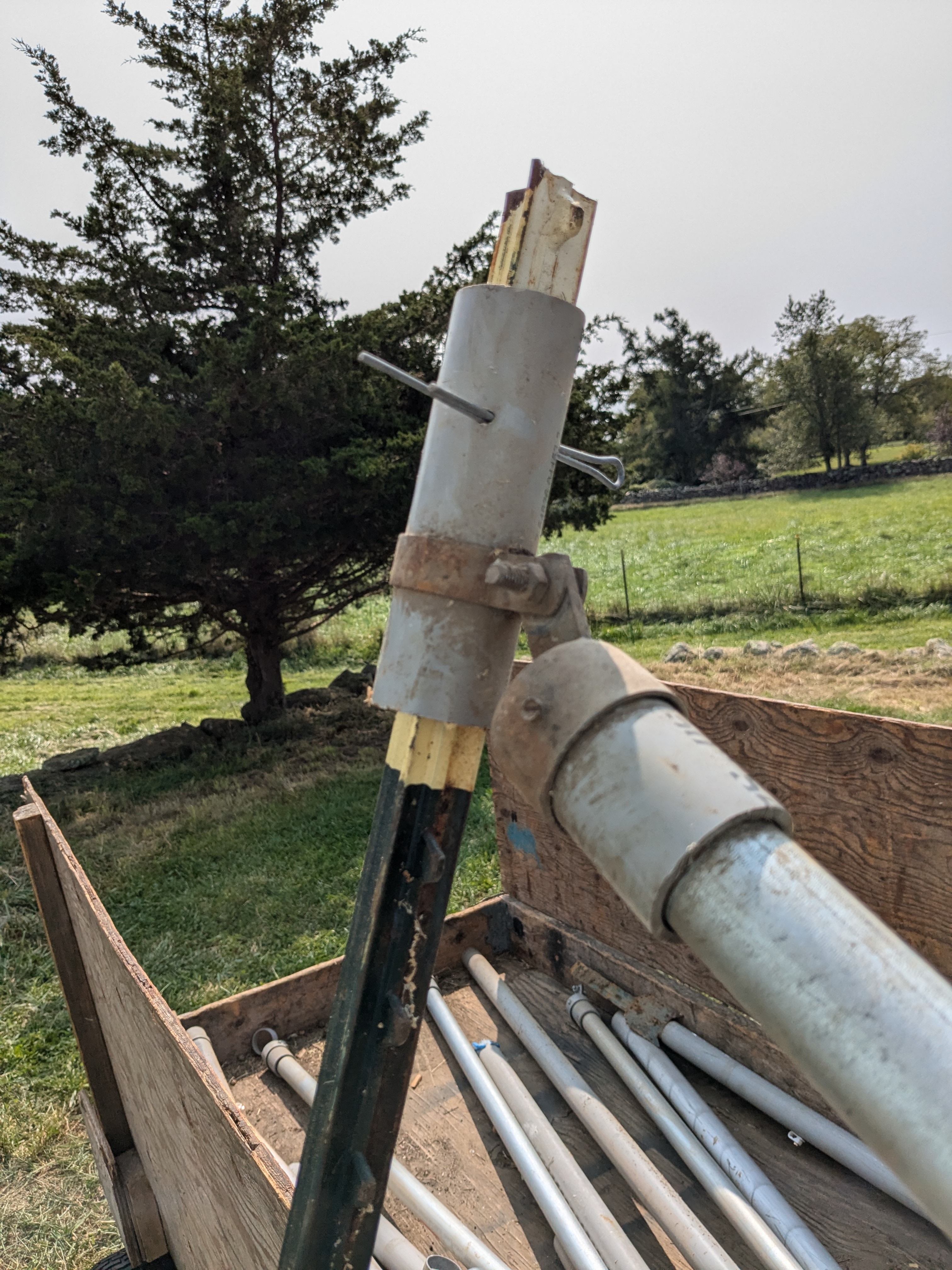

Over the years I've made some innovations. One is that instead of using chain link fence brace posts, I now use 10' pieces of 1-1/4" EMT. It's cheaper and I can get it at any big box store. It fits snugly inside 1-1/2" PVC, so I can make a corner where all of the pieces are clad in PVC pipe. When working with electric fence this means all of the pieces are insulated.
I use PVC electrical conduit rather than water pipe because it is more UV resistant, the white PVC tends to get brittle in the sunlight after a while.
/ Bracing fence corners with T-posts
If I don't need an insulated corner, I only need a few inches of PVC pipe to hook onto. If you drill a 3/32" hole in the pipe, and then put a piece of 12 gauge galvanized wire bent into an improvised cotter pin in the hole, it will hook onto a nub on the T-post and hold securely.
I use a 7/8" sheet metal screw into the cap and through the PVC and EMT to hold it together. But the force is all in compression.

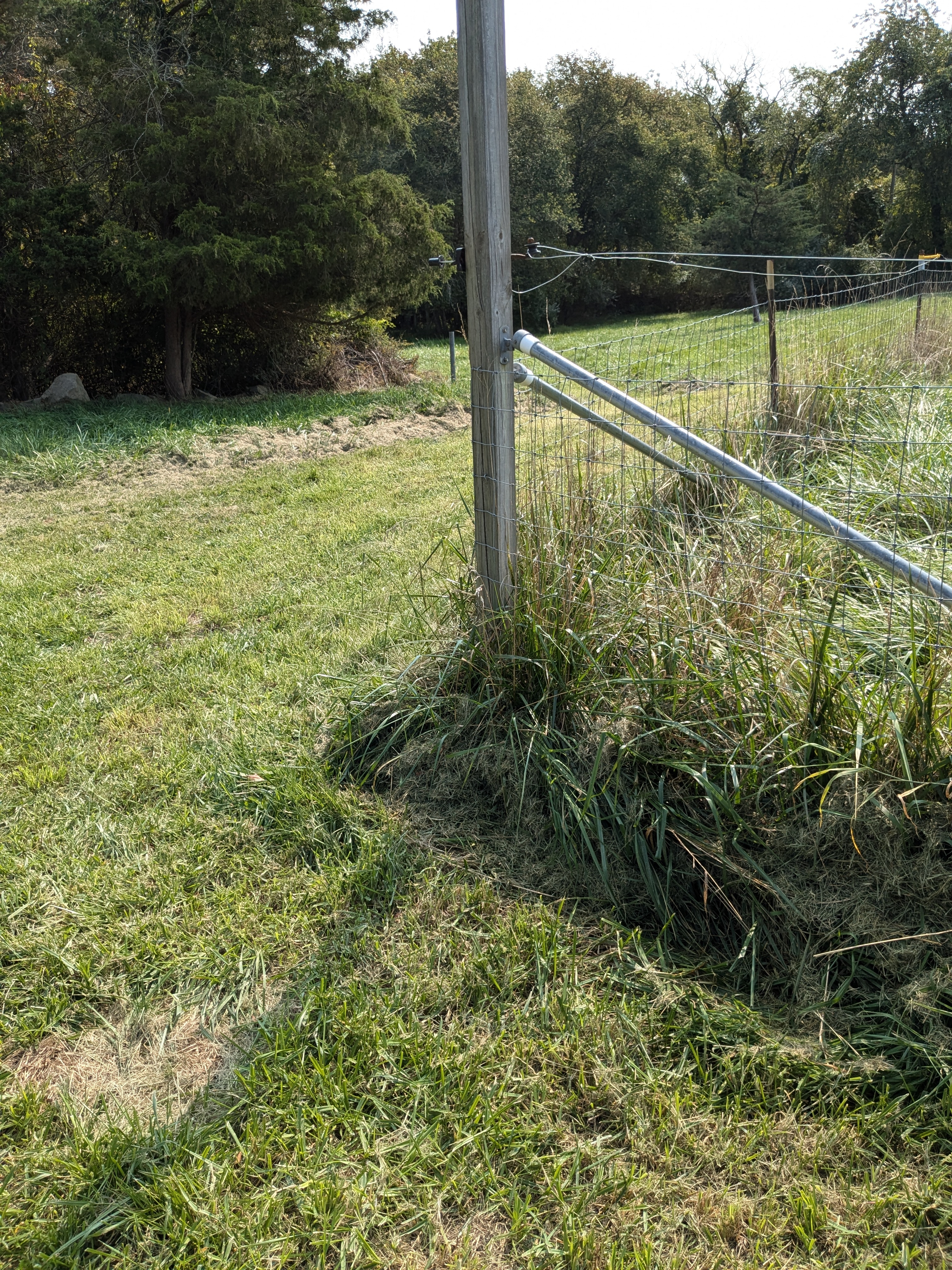

I've also had good results bracing wood posts this way:
The fitting to attach a brace to a wooden post is called a "drop fork bracket," you can see it here:

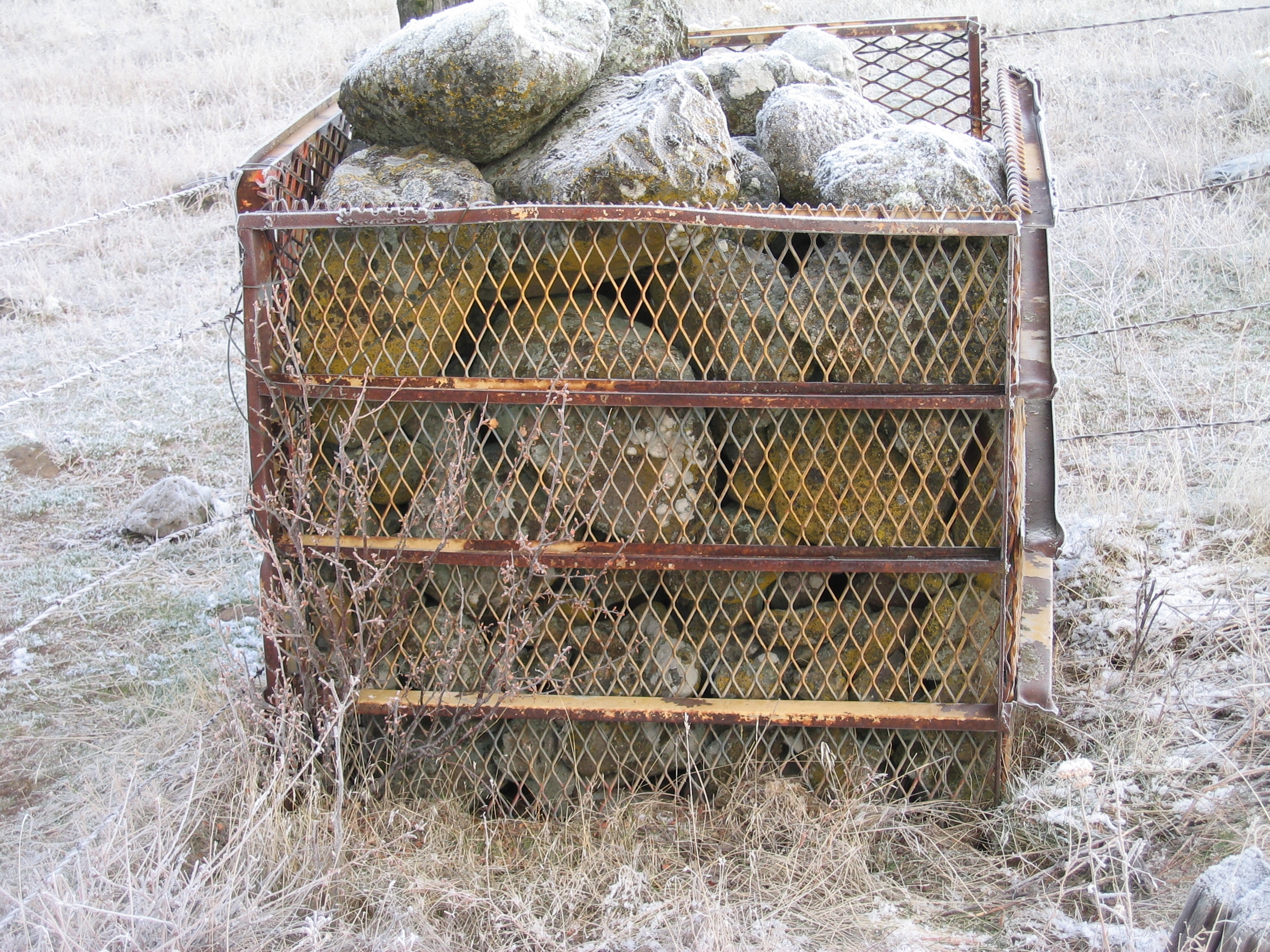

For my corners I use rock filled gabions. This one is made out of 4' x 8' warehouse shelving. Two shelves - folded in the middle - wired together - filled with rock. Calculated weight ~ 6500 pounds.

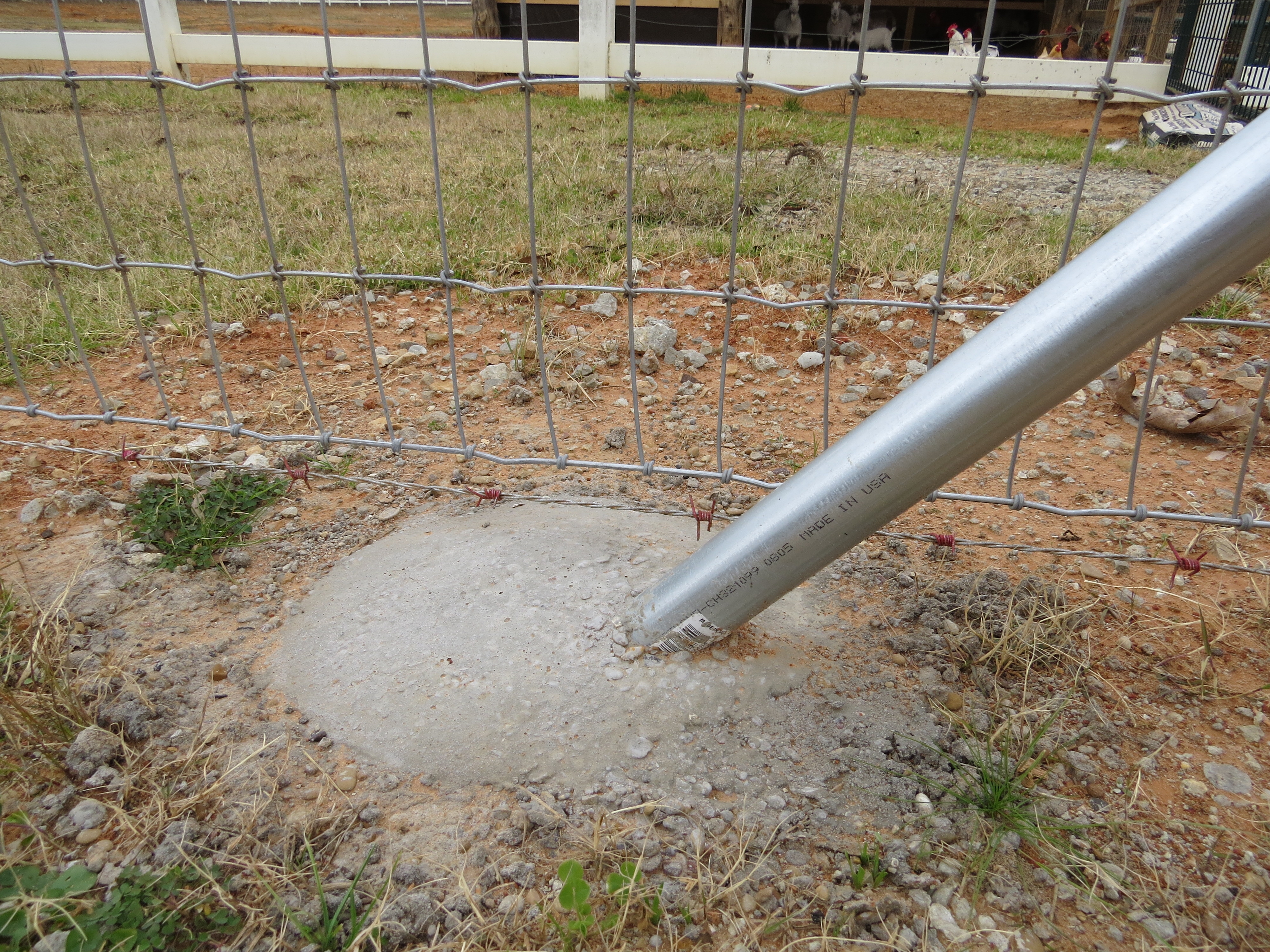

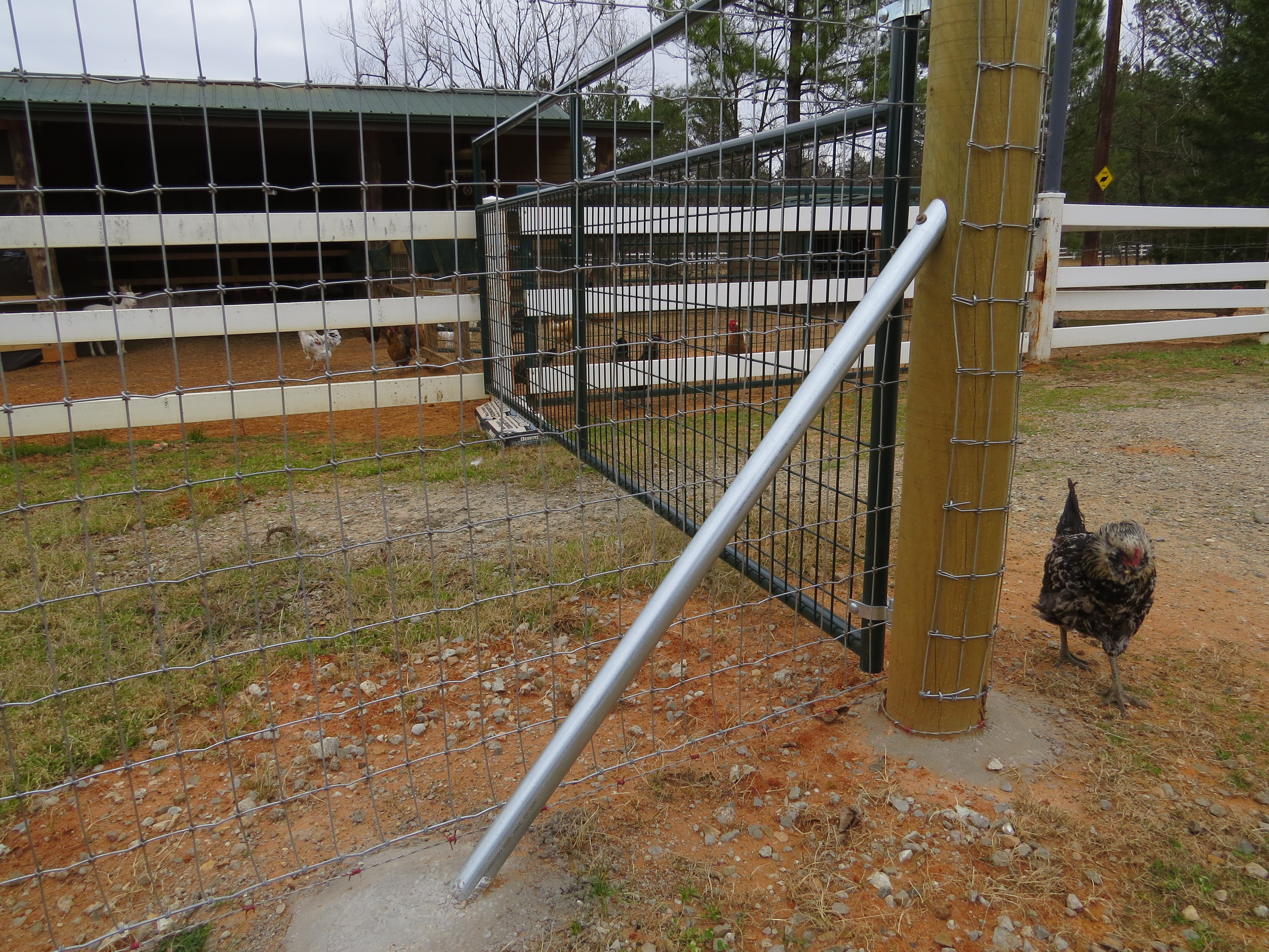

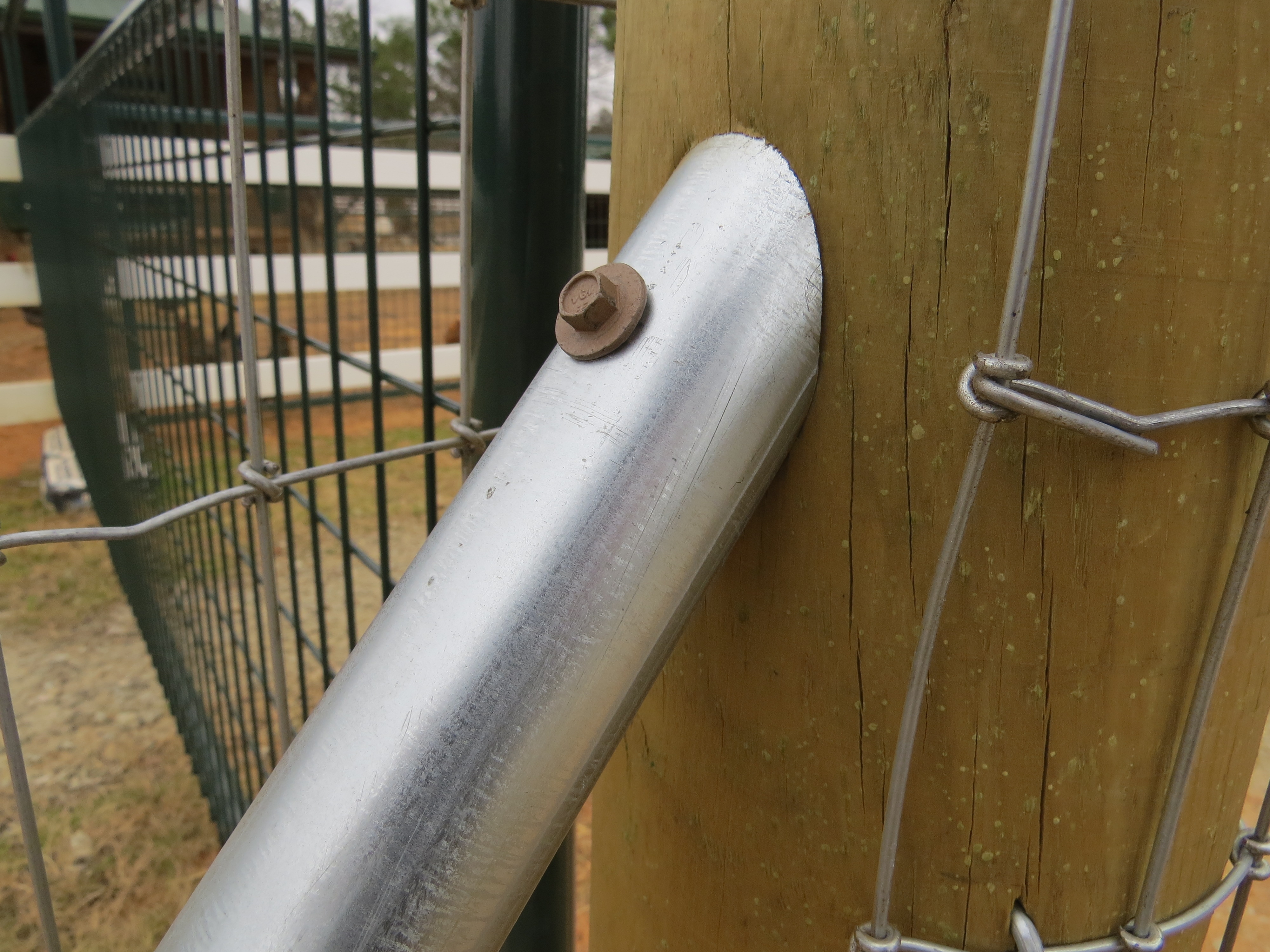

I do something similar, but I'm using 6inch x 8foot treated wood posts in concrete with 1 1/2 inch EMT for my bracing that is also set in concrete and attached with a 5 inch exterior structural screw.
The EMT comes in 10 foot lengths. I cut them in half at 45 degrees, drill a hole through the angle part of the EMT for the structural screw and anchor the other end in concrete.
I always bring the concrete up the post so water sheds away from it. In my experience, posts always rot at ground level, so keeping the water away from the base of the post will keep them from rotting.
My fencing is 4ft 2x4 horse fence. I like the wood posts because I can attach the fence to the posts with barbed staples, that make it very secure.
