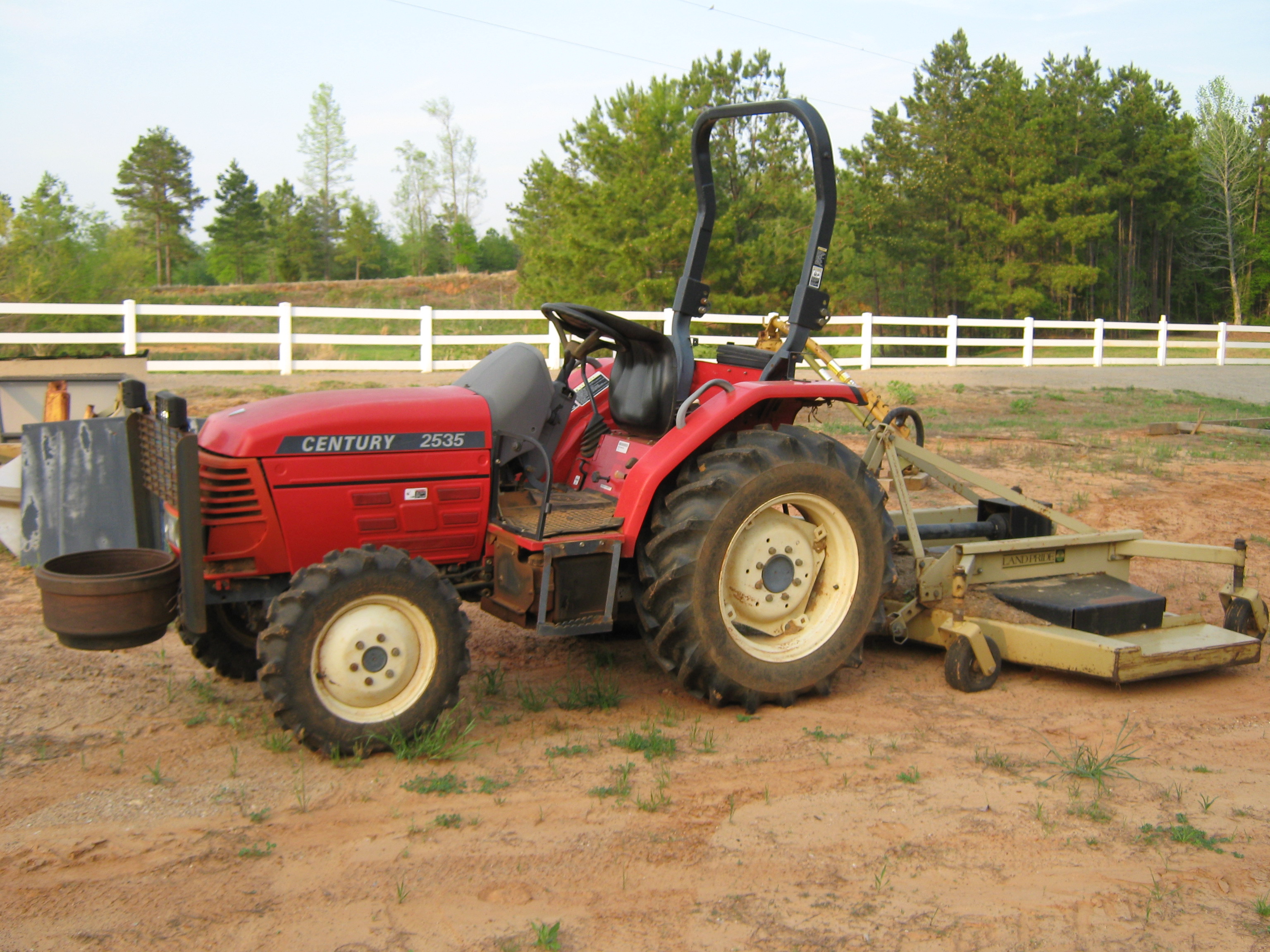

I picked up a brake drum off of a semi truck for free, drilled it for bolts and attached it to the front of my tractor. The I put some concrete in it that I had laying around. Total cost was under ten bucks. Before adding this, when going up hill, my front tires wouldn't have enough weight on them to turn. I would just keep going straight regardless of what direction the tires where pointing. This solved that problem.
/ Ideas for building counter weight
Thats pretty smart, I might be able to find something like that

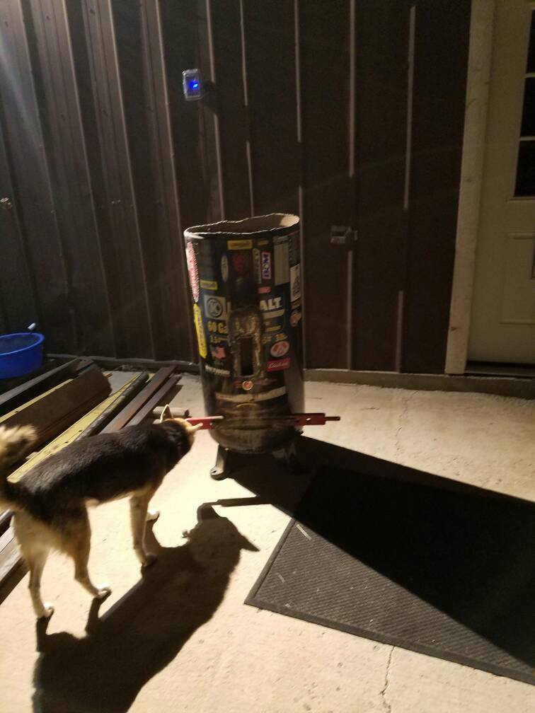

3pt, not front mount, but you get the idea. My 60 gallon compressor sprung a leak so I recycled it. Old brake disks & drums & other scrap steel burried in concrete at the bottom. Dirt on top.

Any more pictures of that build?
It started out like this, then it blew a leak in the bottom.
Shared album - Devin Noel - Google Photos
I dismounted all the parts to put on a new tank. I then cut off the top with my plasma cutter. I then backed it up to the 3pt on my tractor. Drew a line at the approriate height & the same width as the 3pt drawbar. Cut that out so I could put the drawbar in recessed an inch or 2. Deep enough to catch a lot of the tank, but shallow enough to be easy to hitch up. Then I welded the drawbar in using shims & some scrap to block off round bits & holes in the drawbar.
Piled scrap steel, brake disks & drums in the bottom, then dumped in 2 bags of cement & let it settle a lot before wetting it down. I let that set up a bit to help lock in the 3pt drawbar if my welds sucked. I then hitched it up & marked where thetop hook hit. Cut out a slot below that so I could back in, then the top hook would catch. I thought I might need to weld a patch on to reinorce the top of that slot, but so far it hasnt had an issue. I weled up some random scrap into a tall box slightly taller than the slot in the tank missing one side. I then welded that scrap over the hole on the inside. Total crap welds & I covered the holes with aluminum tape as it was handy. Added more scrap & 2 bags of concrete. Filled it enough to lock in the box covering the top hook hole. Filled the rest with sand & dirt.
May make a form around the base & fill it with more scrap & concrete. It would add more weight down low for better stability (for the trator & the ballast box itself when sitting around.
Will try & grab some better photos in a day or 2.
