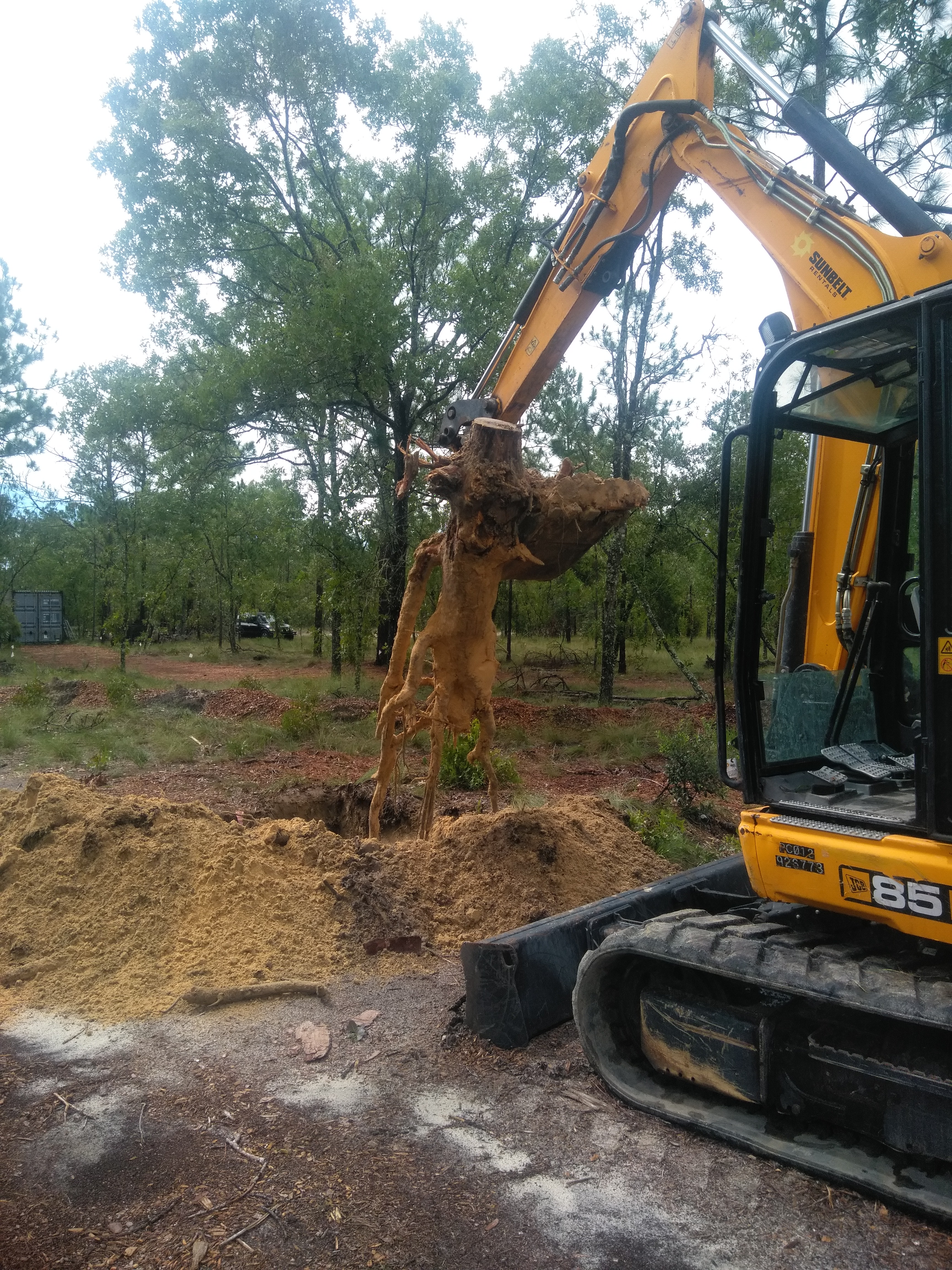

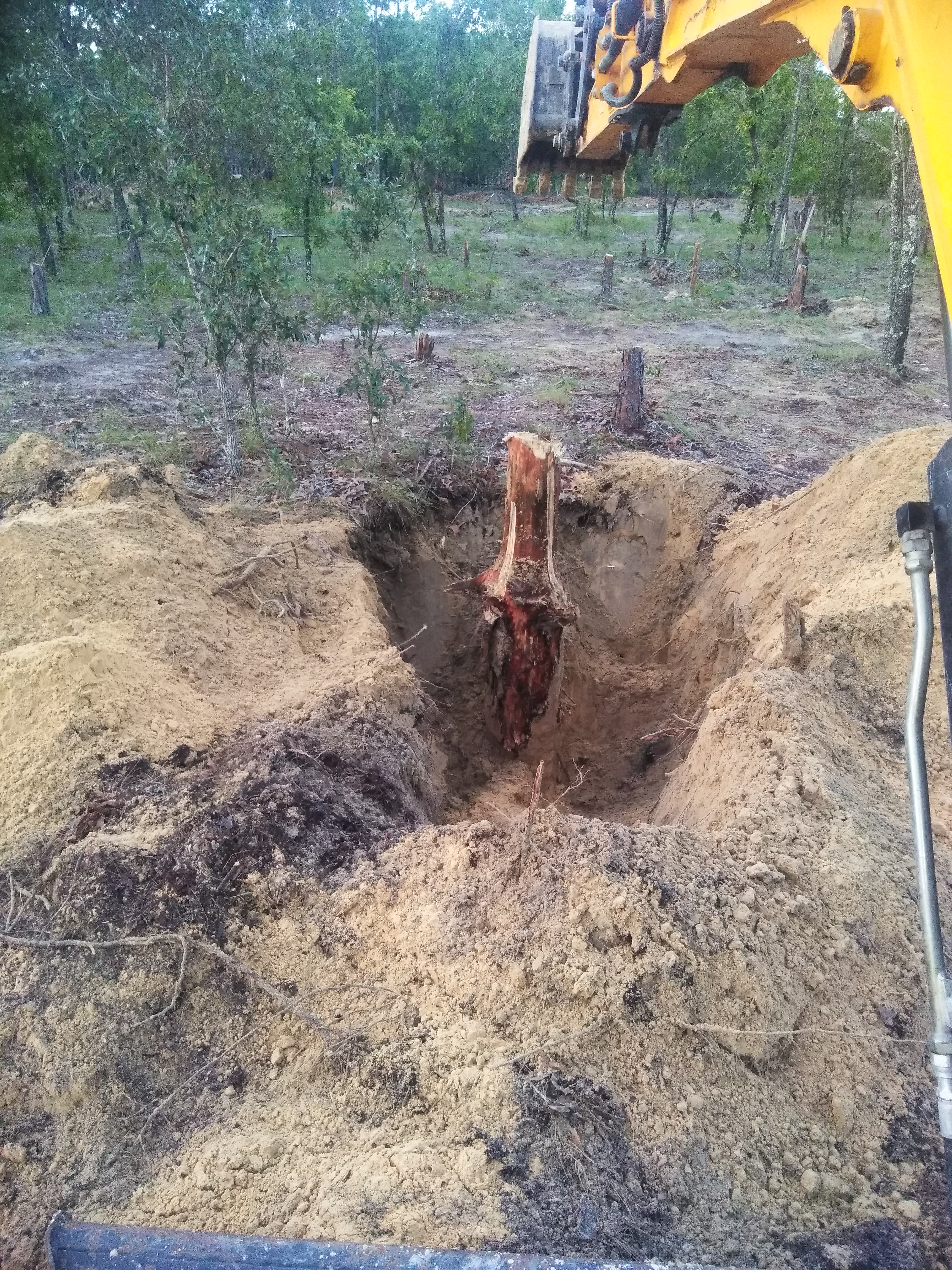

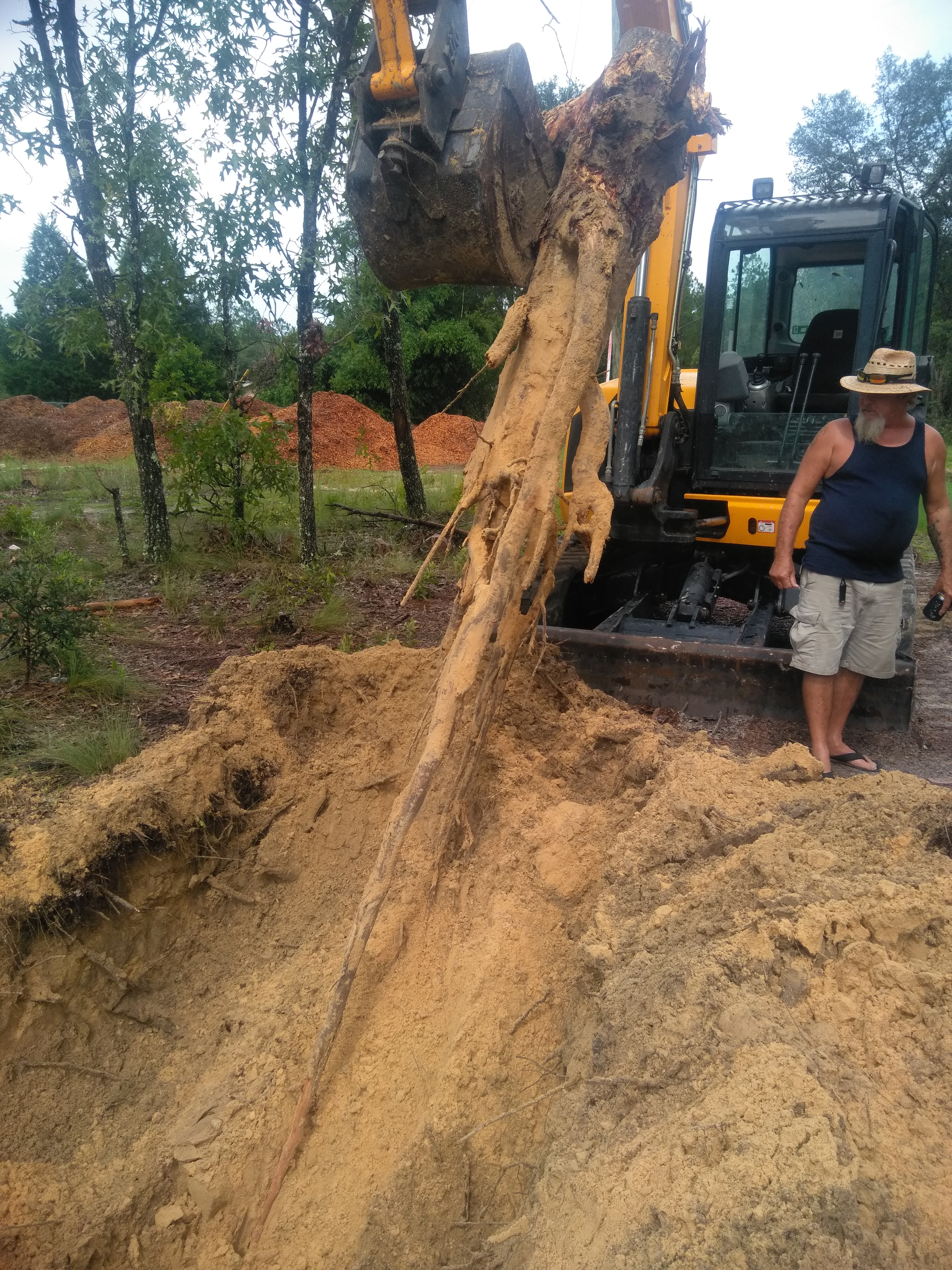

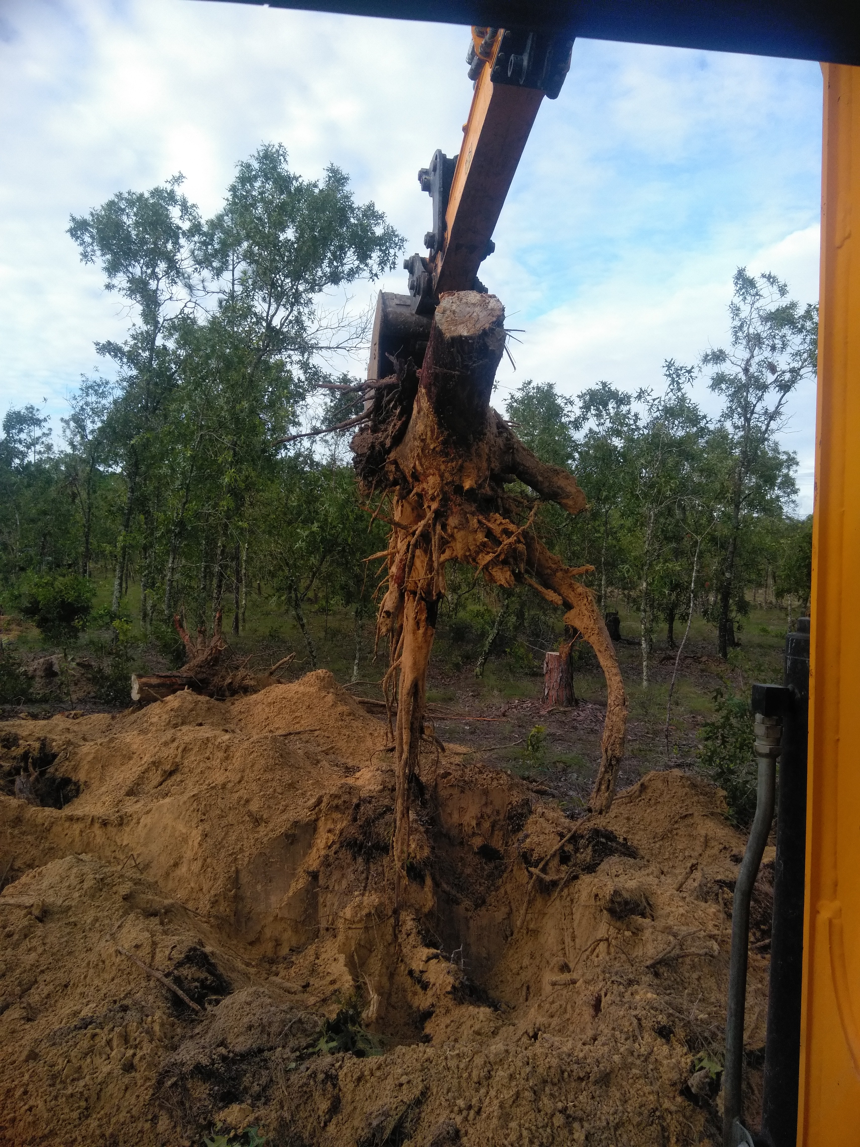

holy moly you have craters, i think you might need a lunar land dozer!!!!
After seeing two mentions of the lunar land dozer I did a search...found nothing...I take it this was a humorous comment? :confused:

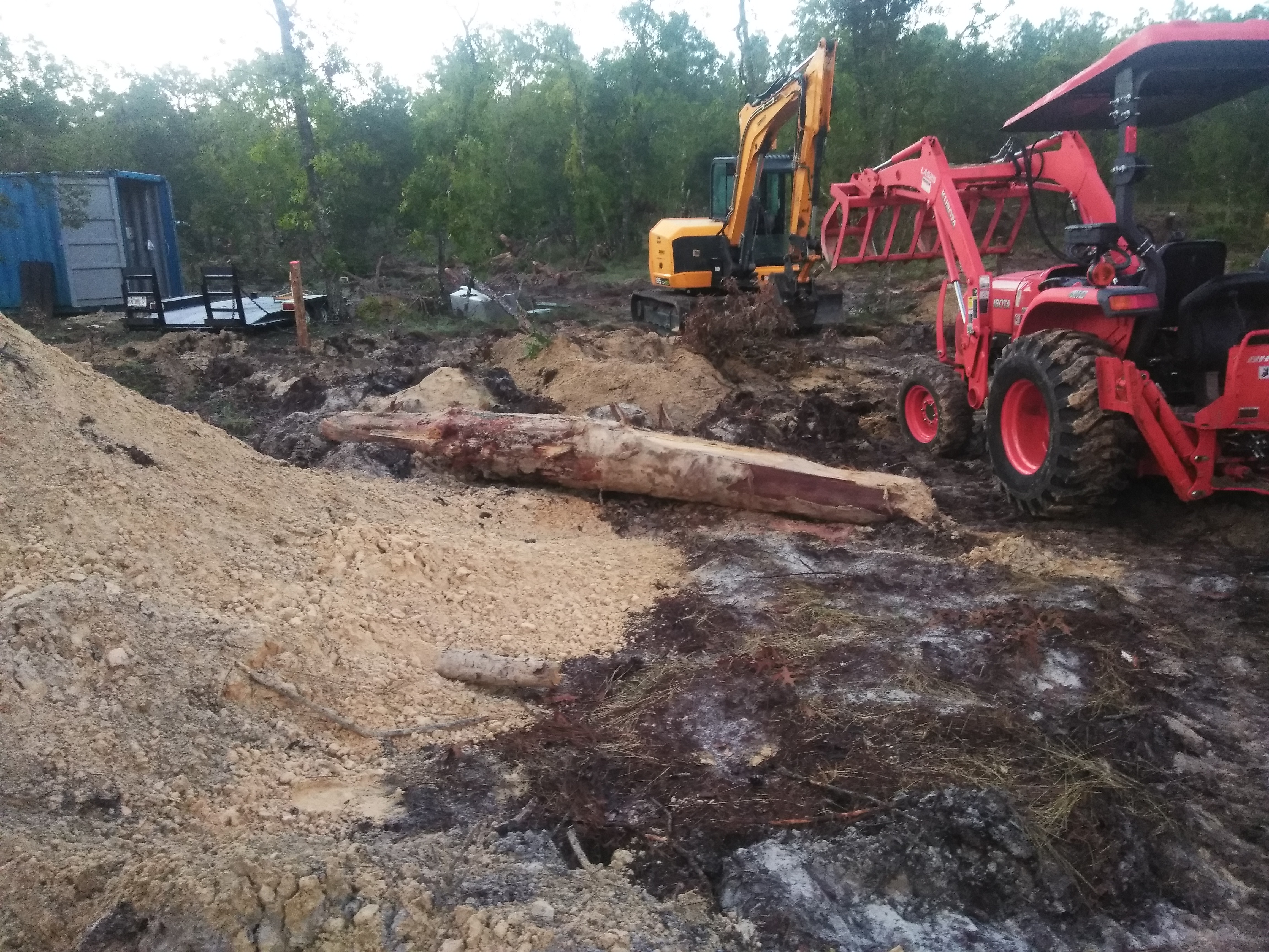

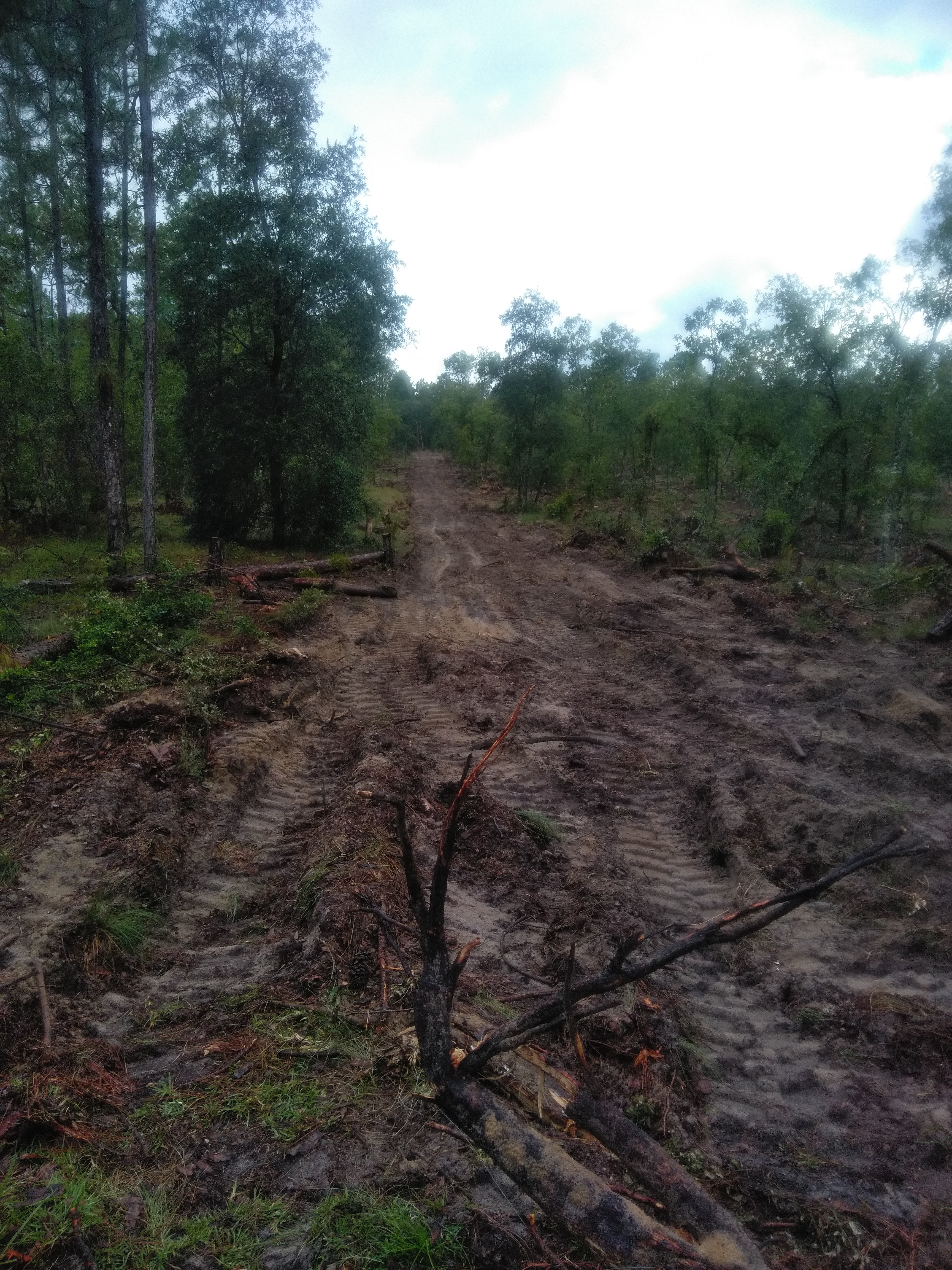

Put your bucket on and have it. Practice will make perfect and you have a large area to practice in. Since you already have the bucket, it won't cost you any additional money, just your time involved.
That's probably the best idea yet. No implement is going to work any better than the operator, and he can't learn without practicing.
OTOH, if you think that you need a box blade then you probably do. ;)

aaaaah but yes an attempt at humor since the craters were the size of ones on the moon from the excavator/root balls, i figured NASA probably had some kind of lunar land dozer that would work good on craters and its probably been sent to the Gov't Surplus auctions by now HA!!! might get it for a song$$$
if its sugar sand it would be like moving moon dust so should work great!!!
id just start with a loader to fill the big holes and finish with a drag - definitely going to need a respirator with all the dust you will stir up

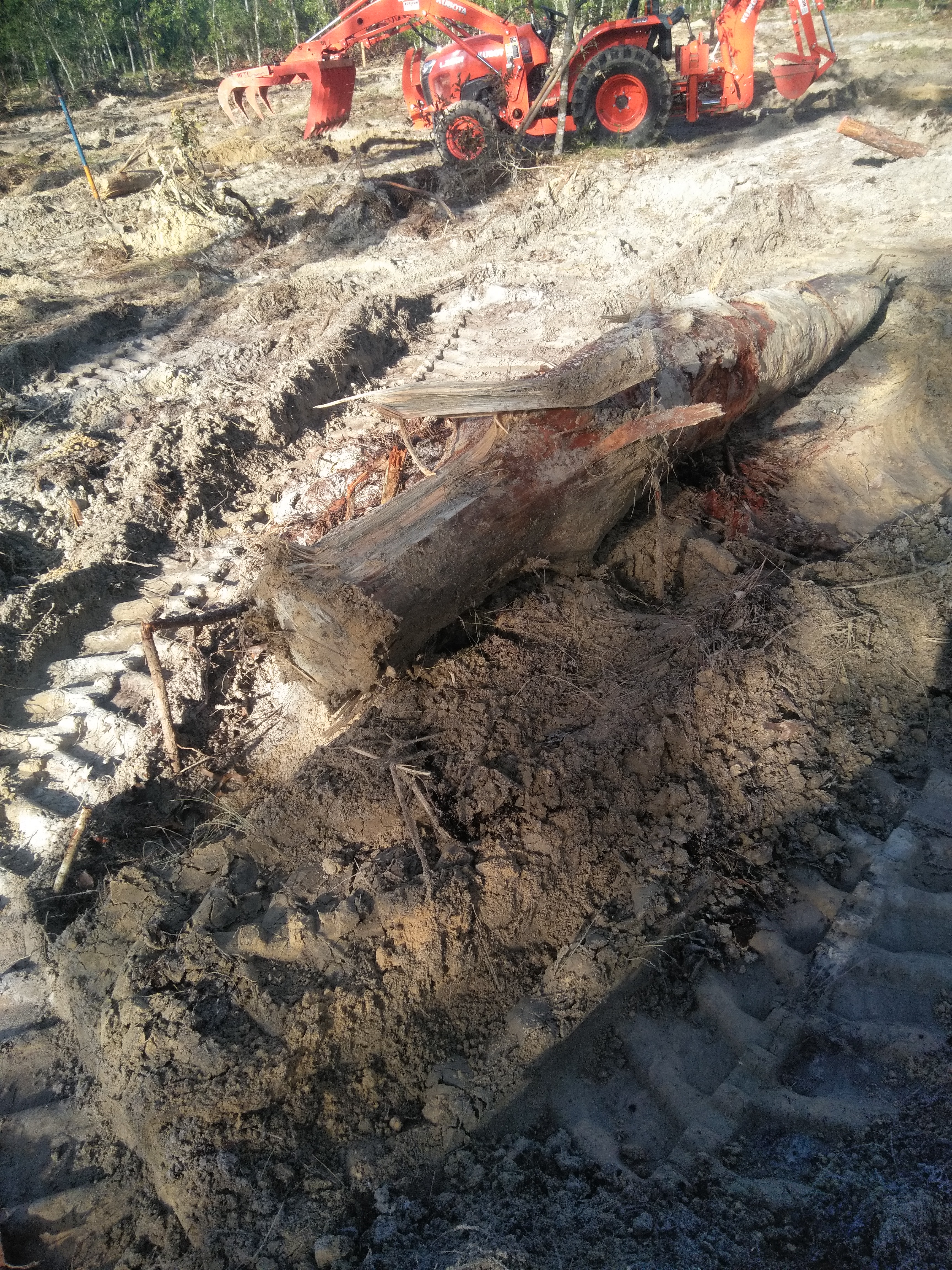

Wow that痴 a mess, I壇 rent or borrow a D8 dozer and level it all out as best as possible and then drag and blade it.
