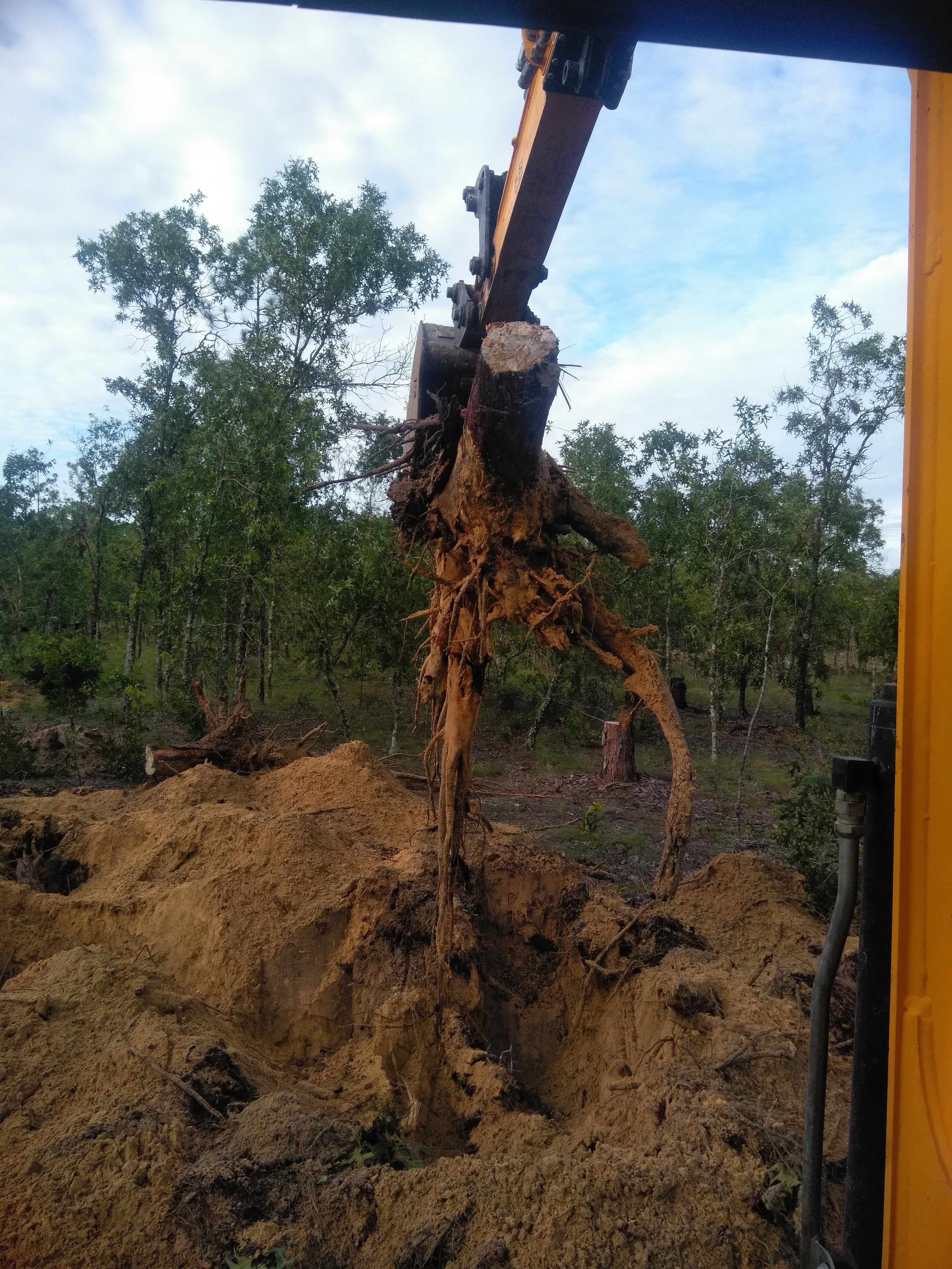

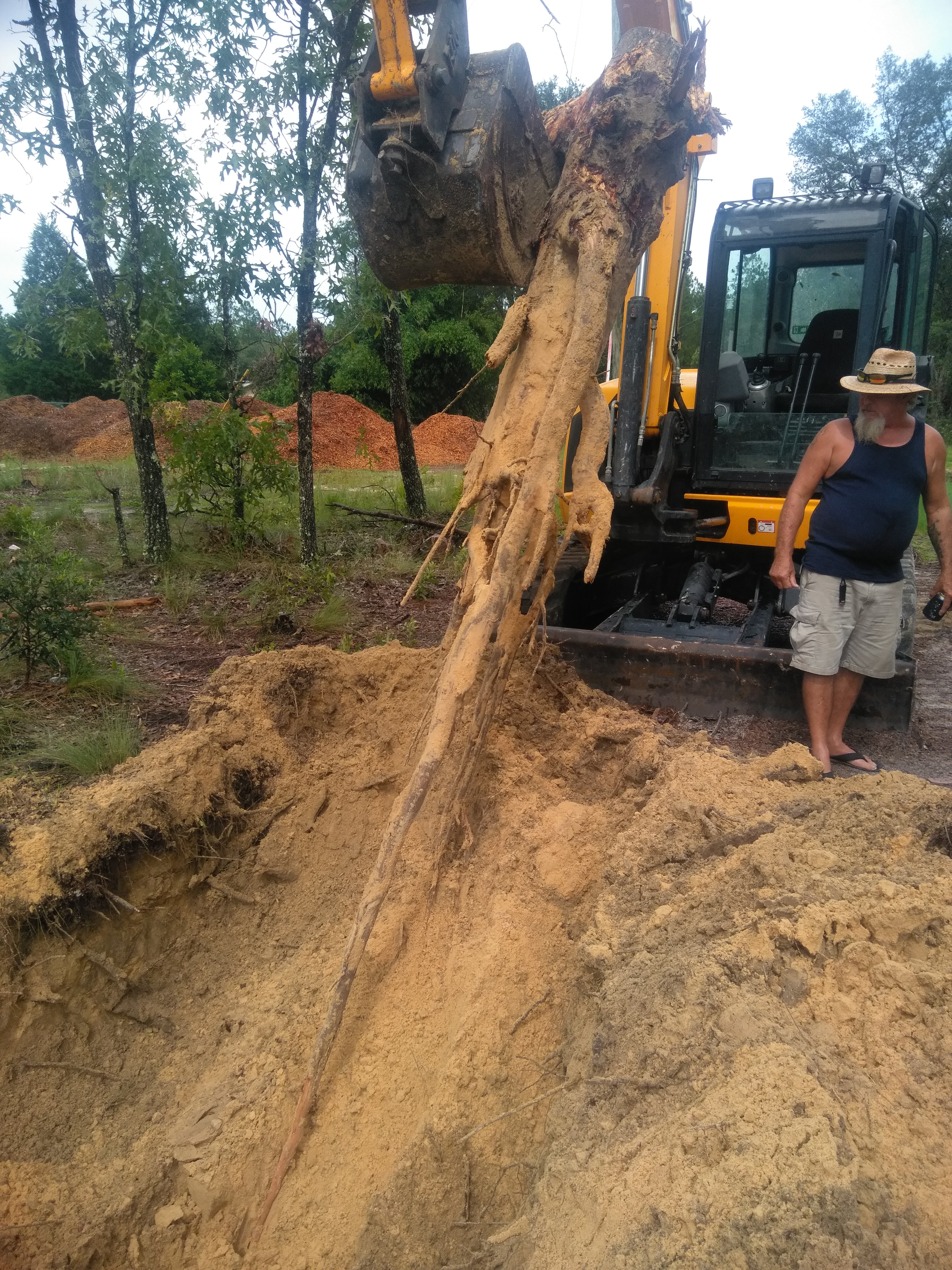

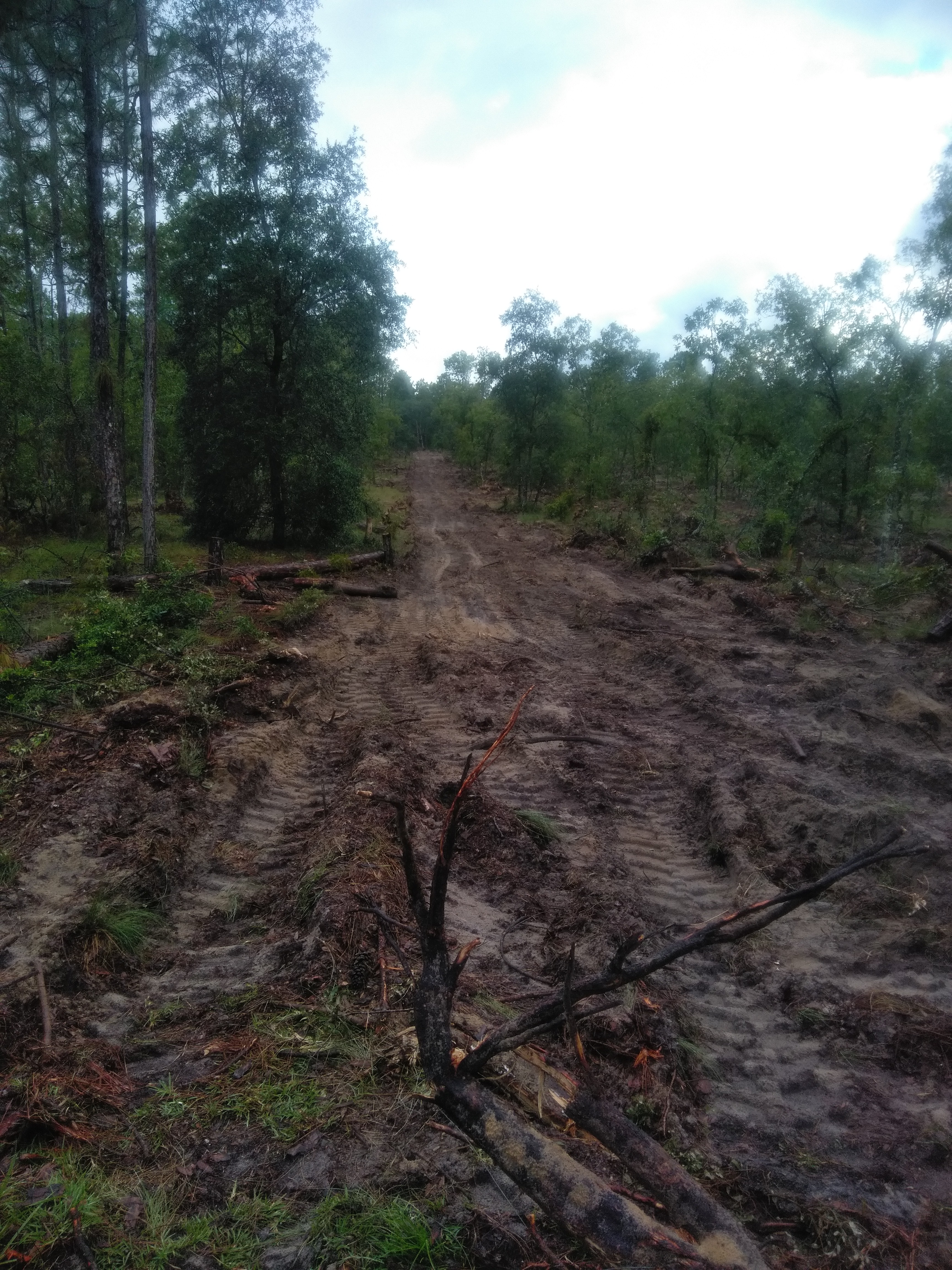

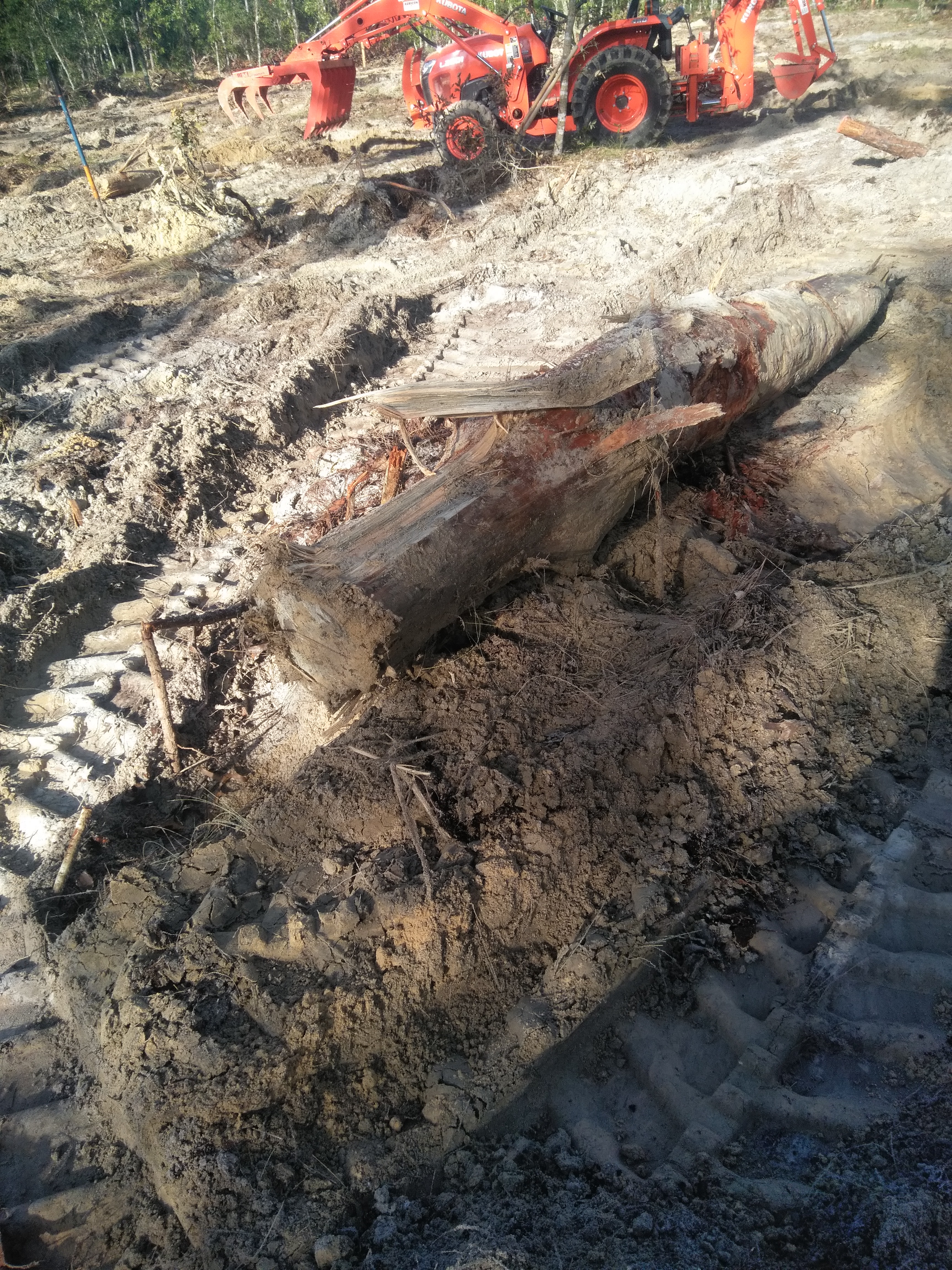

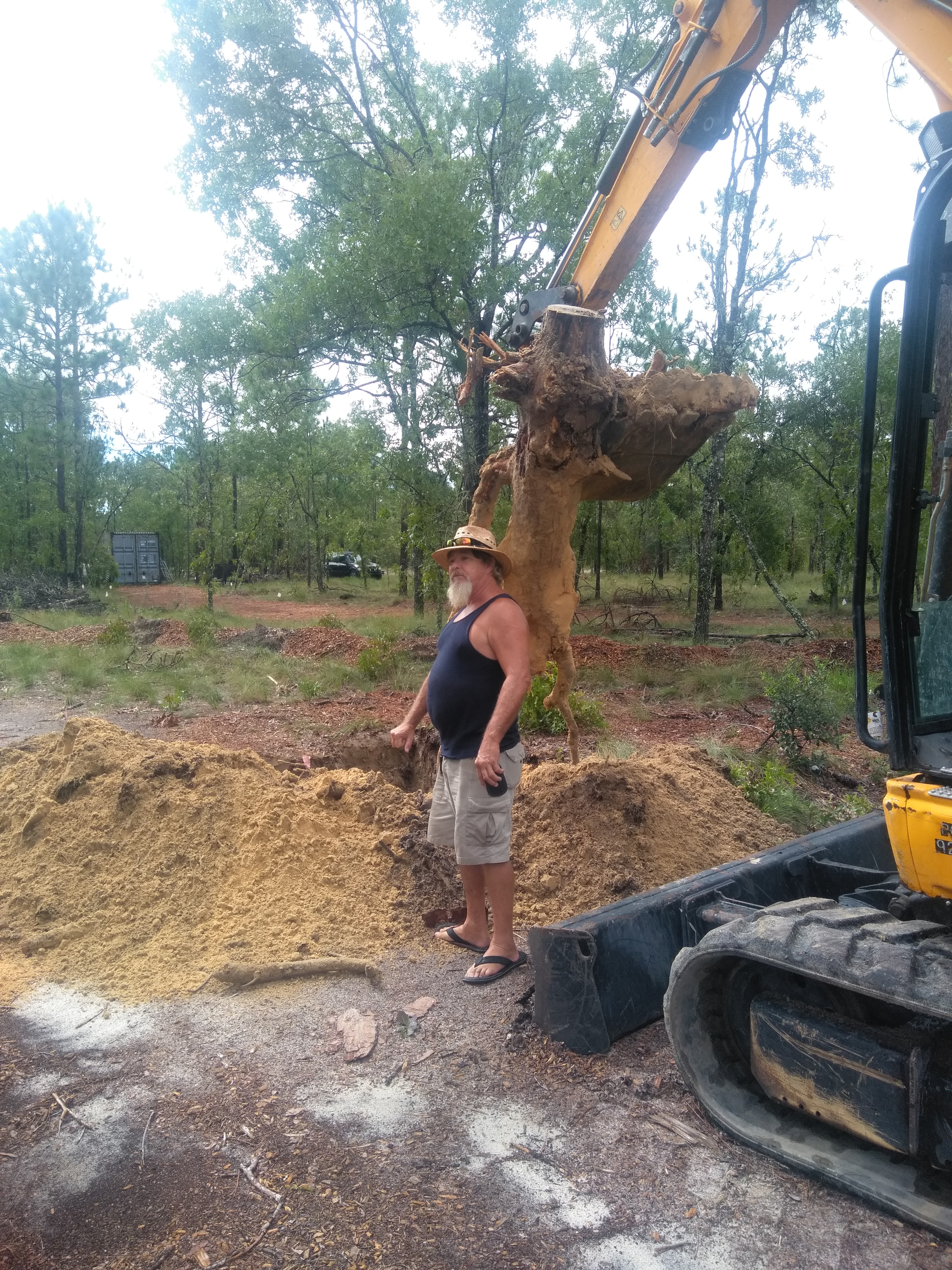

I know nothing about implements, Im not 100% positive a box blade is what Im after but Ive spent enough time on you tube looking at what I can learn to remember seeing a video about box blades.
Im gonna post some pics but once again right now Im in a rush to get to work so it will have to wait.
I rented a large excavator this weekend ( kinda large, 19000 pound ) to pull my stumps on my 5 acres. It was an unbelievable experience that I will not forget. Never ran that type of equipment, it yanked them out like twigs being picked up. Pulled between 2-3 hundred in a hard long day.
After maybe an hour it was as if the controls were extensions of my hands.
Now Ive got huge ruts and uneven land/soil.
Excavator had a scraper on the front and I did the best I could to level things out but W.B too short and now Ive got a huge mess.
Is a boxblade what Im after, can it be rented typically? I am running out of storage room in my shipping container I have on site, Id imagine a half day is all Id need, Im not trying to get things perfect, only level enough that I can drive thru it. My L2501 has already gotten stuck on me once trying to drive thru the mess.
Maybe Im thinking something that I can attach to the 2 inch ball on my 4WD Ranger? It wont get stuck most likely.
Maybe I just need to get a heavy piece of lumber and attach a chain to each end running back to my ball in the center?
Just thinking out loud and looking for advice.
I know nothing about grading but Im assuming I will have to have that done eventually but not now.
Thanks for any feedback

A box blade is a common tool for dirt work like you are needing to do. Some people will use the bucket of tractor and back drag with it. Our neighbor had an old railroad tie and fence hooked to it and used it to drag with to smooth his yard.
You could also use a land plane/grader, straight blade, you could disc or rototiller it in. There are lots of options, depending on how much you are wanting to spend and time involved.
For our work which is brush/tree/fence removing, I have been using my bucket to smooth out the worst areas and when we get the project down, then use a box blade to put the finishing touches on it that we would like.

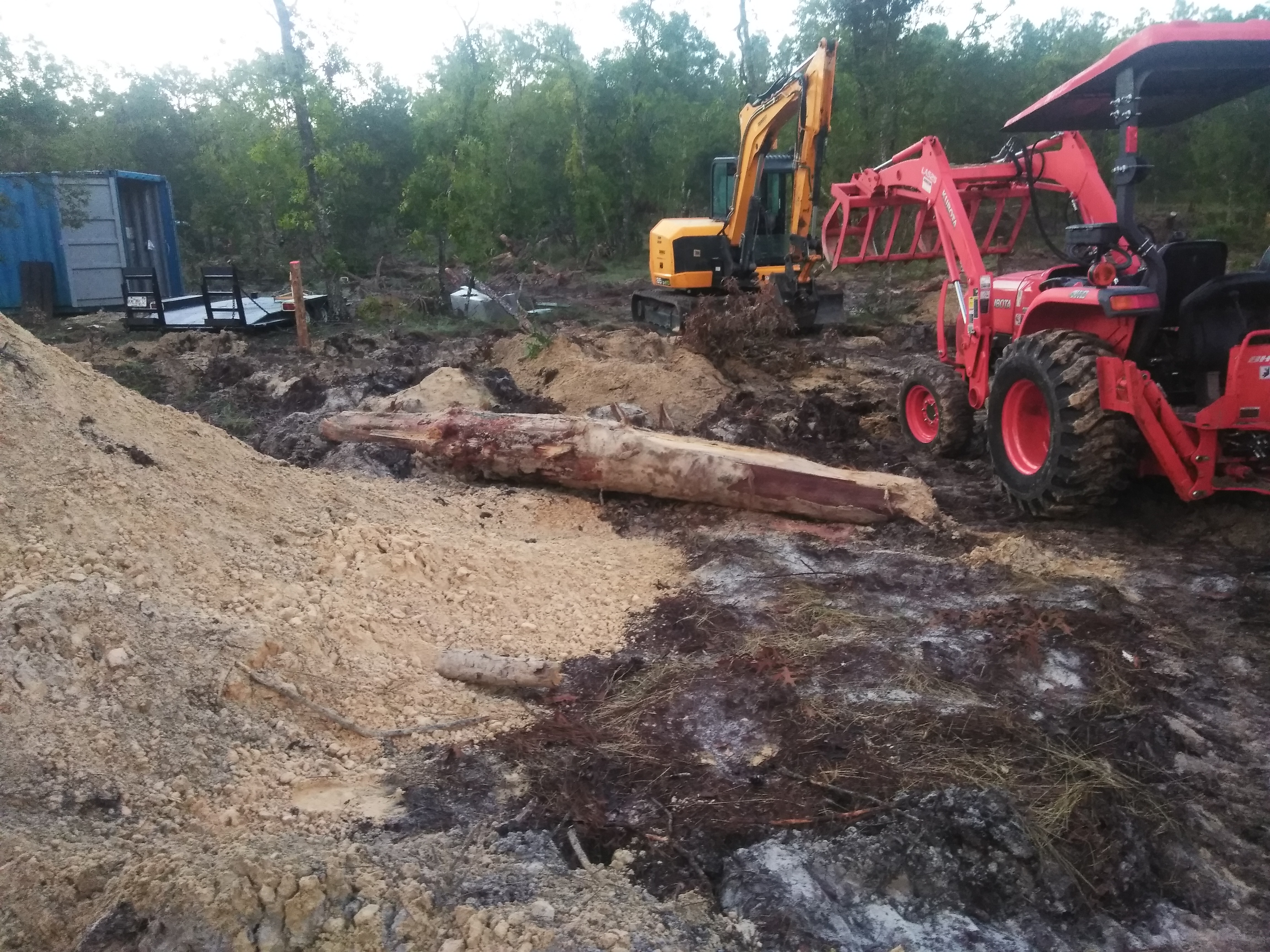

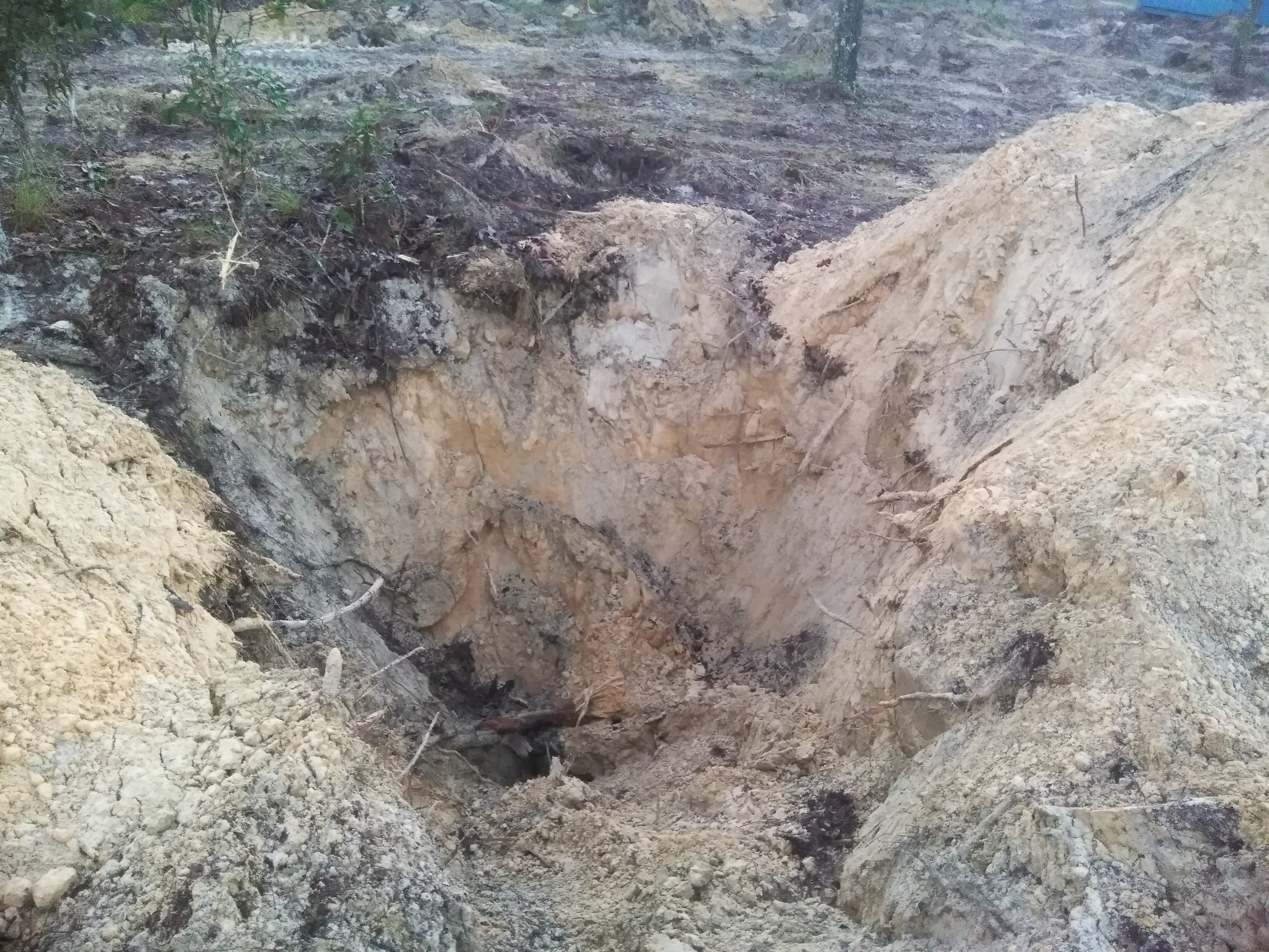

The ruts are large enough that you get stuck on your L2501 (Kubota?) trying to drive over them? 2WD?
You may be overly optimistic thinking you could get five acres drivable in half a day. For me it sounds like I would need at least half a month! But you say your 4x4 Ranger would probably not get stuck...so maybe it s not as bad as I imagine.
Perhaps you should consider hiring a bulldozer to smooth things first.
Of course when you post pictures we will have a better idea of what you are dealing with.

Thanks for the info, pict below I hope
/ I need a boxblade maybe
#13
Looks like pict 44 is the only one I have showing the carnage, I have cleared a large area all around the border of property to drive along, I have also cleared a large area in the center of the property to build on, my wife is supposed to post a video on you tube for me that shows different footage of entire property, she has not done this yet
I know it dosent look bad there in that pict
#14

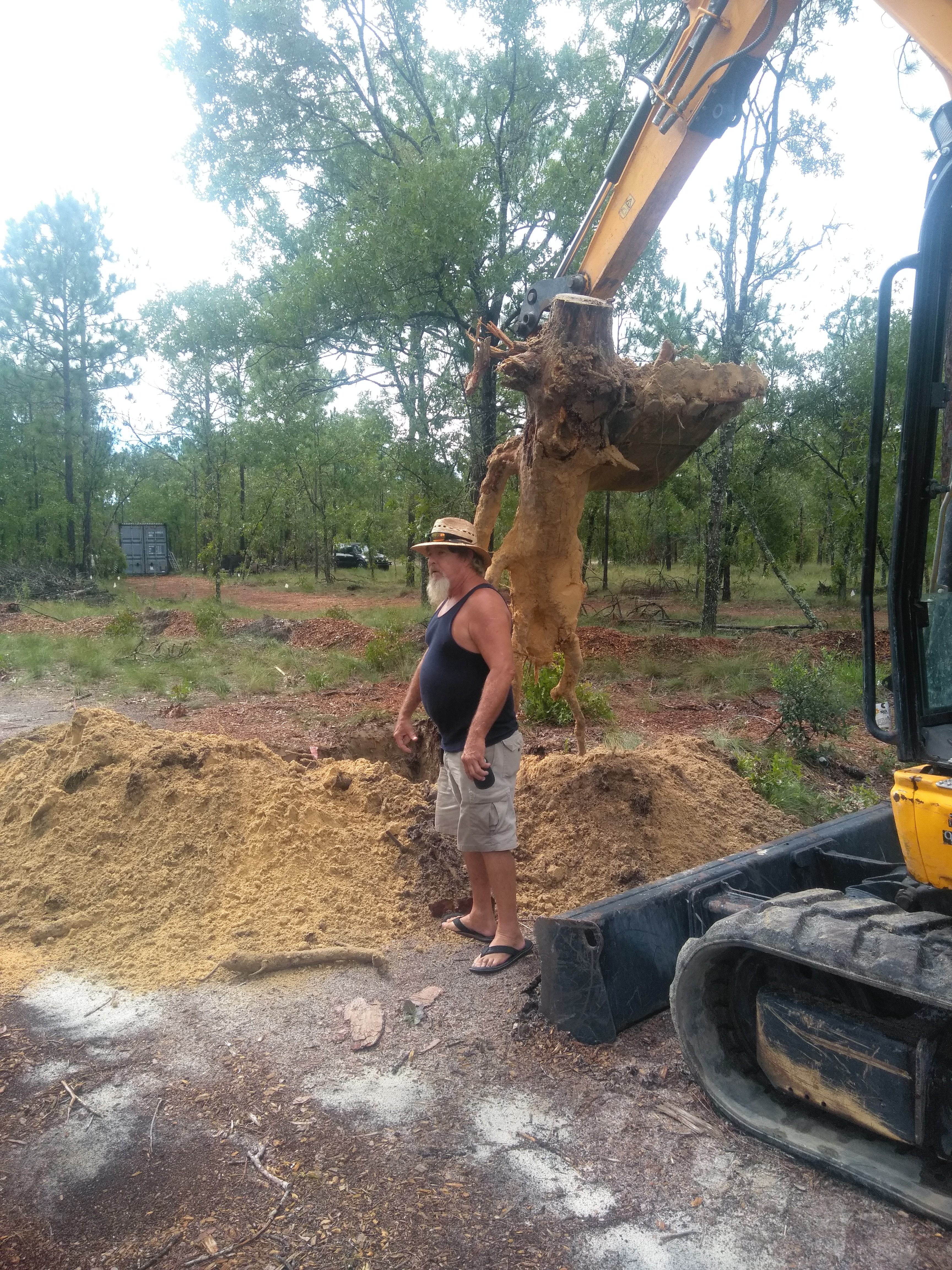

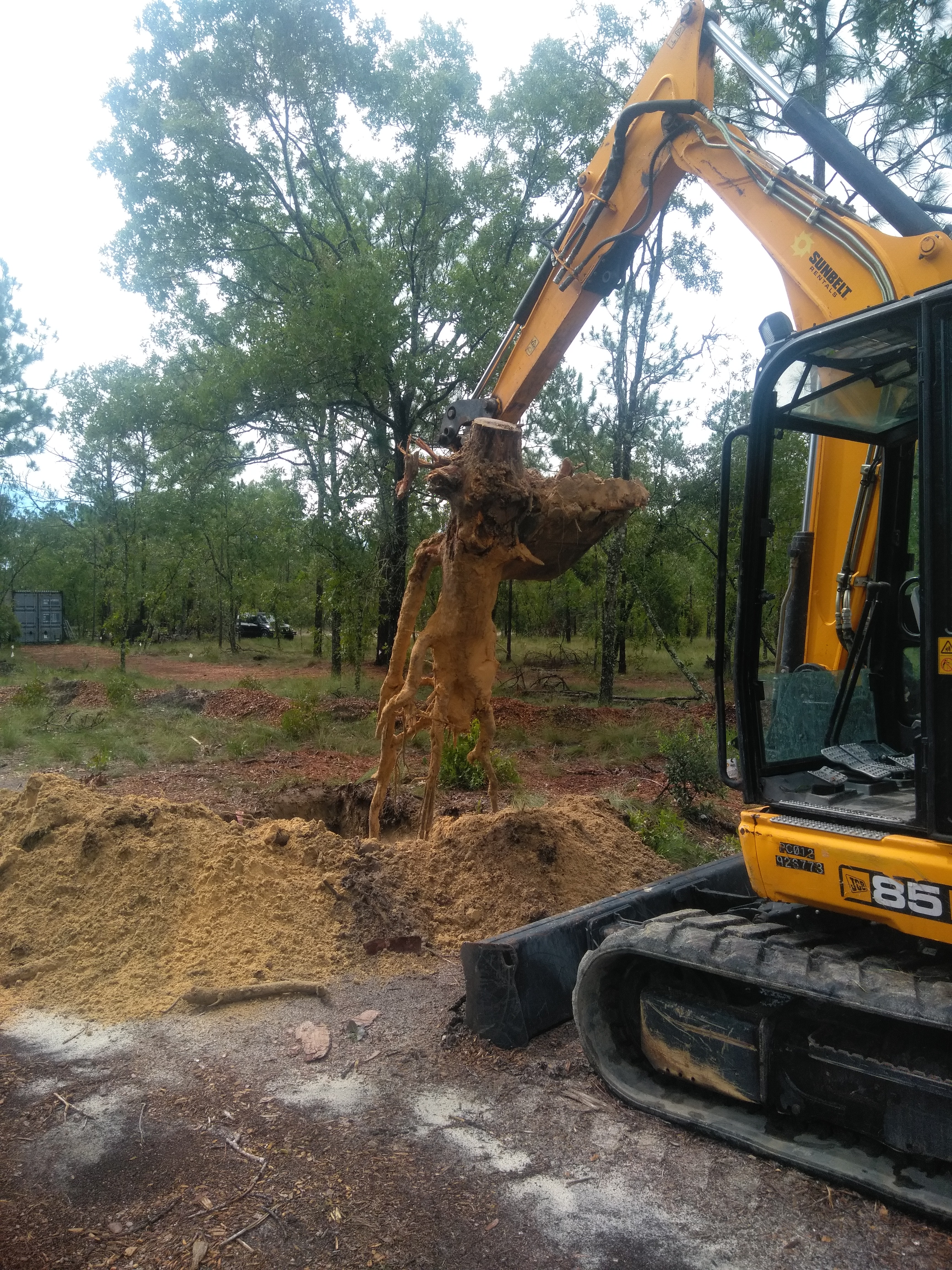

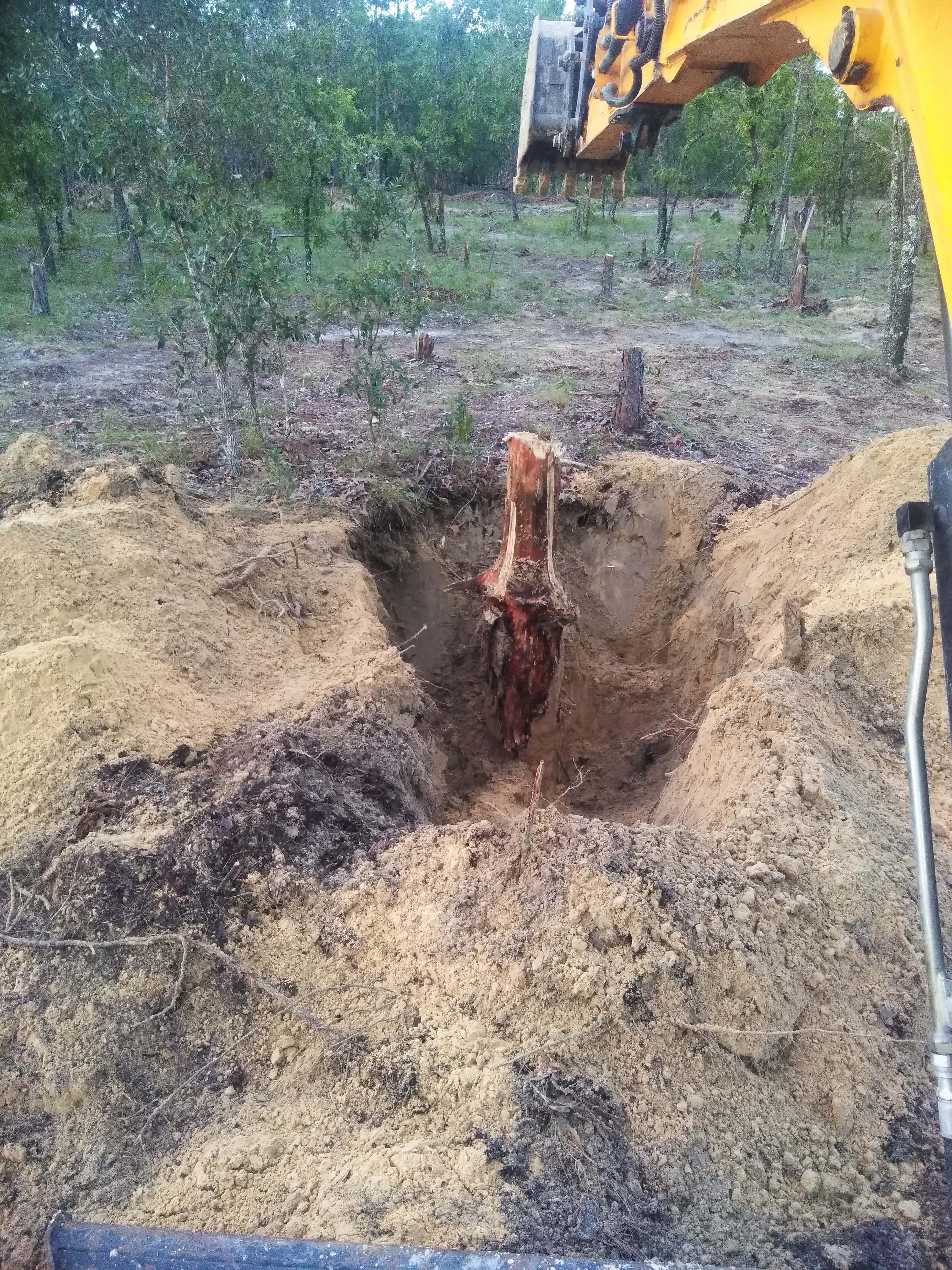

Pict 39-41 may be of most interest, that is all the same stump, you can see how large the stump was that was sticking above the surface, it was maybe 14 inches in diam....I never did get all the tap root, it is lterally the size of a canoe.....what was pulled out, you would have to see this root in person to appreciate its size.

holy moly you have craters, i think you might need a lunar land dozer!!!!
/ I need a boxblade maybe #18
yeah - picture is worth a thousand words. Based upon those pictures you may need a very heavy land plane grading scraper. Or a lunar land dozer. You DID have a good time with that large excavator.
