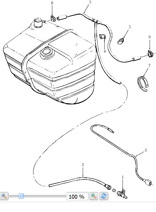

Jan 27, 2014 / i have a guestion #1 B backwoodsman31 New member Joined Jan 27, 2014 Messages 1 Location chesapeake,ohio Tractor 94 new holland 4630 Does a 94 new Holland 4630 have glow plugs and if so how do you get them to work

Jan 28, 2014 / i have a guestion #3 Tx Jim New Member Joined Jan 26, 2007 Messages 10,400 Location Coyote Flats,Tx Tractor JD 4255/Kubota M7040 HDC NH 4630 would have therm-start which is a heating element(parts Key #1) in intake manifold but no true GP's. I think it's activated by turning key CCW but I'm not positive. Attachments Capture.JPG 56.9 KB · Views: 92
