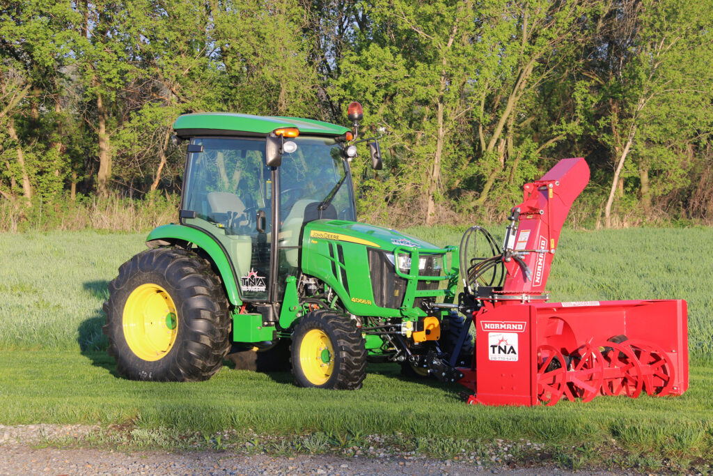

Ill say your post made me dig into front mount blowers a lot more than I have previously. It's pretty nutty the options that are available, the prices seem like they are pretty nuts as well. I'm not completely against it, but I think for now the rear mount makes the most sense for me. Forgive me if I'm wrong, but if I was to get stuck for whatever reason, I can use the loader to help push or pull me out a few inches right? That's my primary reason right there, as far as plowing a light snowfall, can I just use the bucket? its 84" should be able to get the long part of the driveway in 1 down and back I think.
Either way, I'm going to keep the front blower in mind. IF on year one if I find myself hating the rear, maybe Ill give the fronts another look.

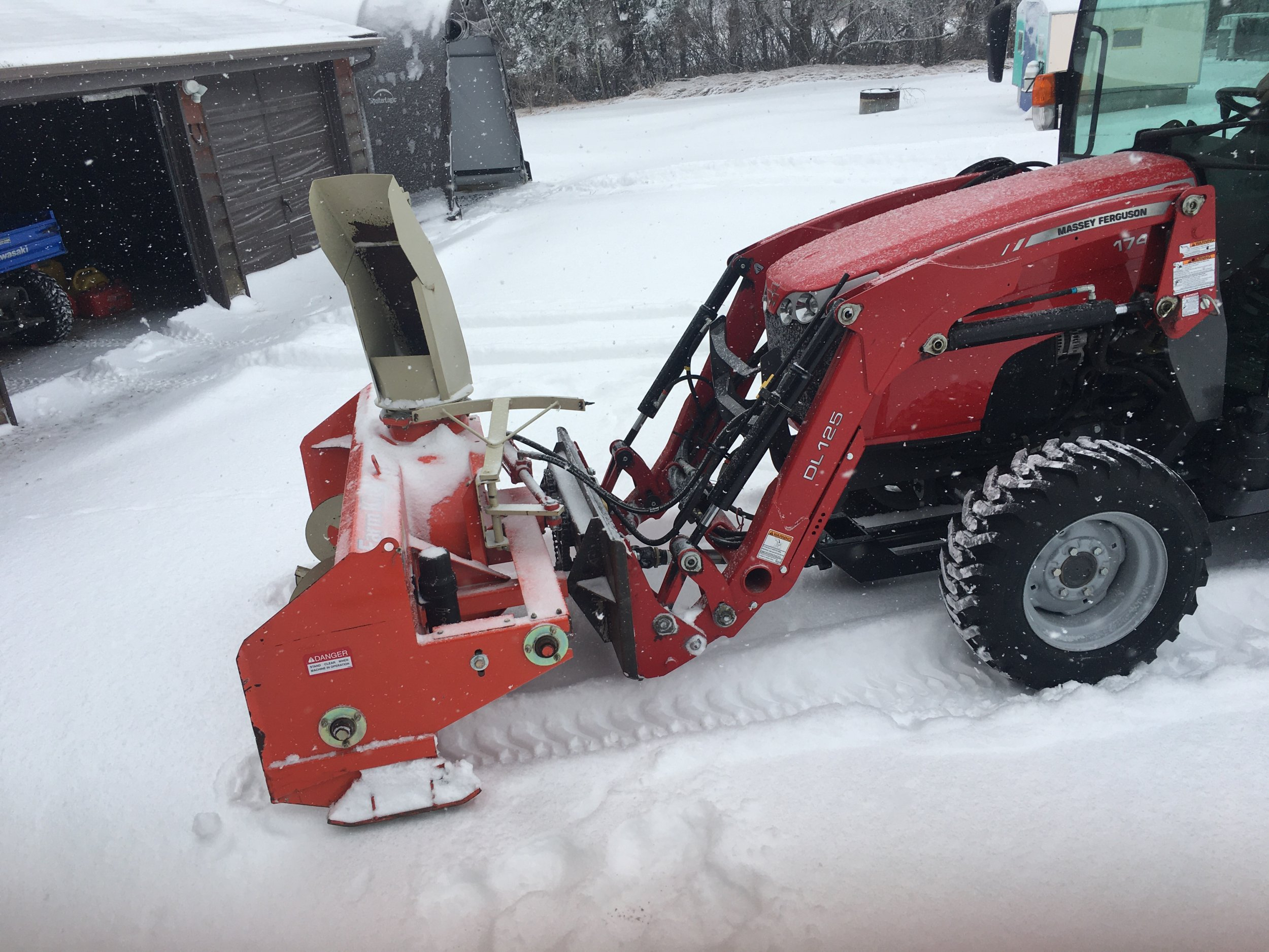

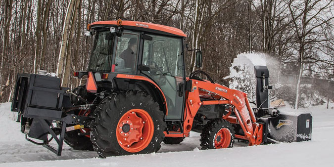

I looked at an Erskine front mounted blower but just couldn’t deal with not having the front loader all winter. It turns a multipurpose tool into a single purpose tool. Also, while most people don’t mention it, a rear mounted blower is much more maneuver wall because it is much closer to the center point of rotation of the tractor. Much nicer for getting into tight places without tearing things up . As I set an in my previous post, I’ve had no neck or back discomfort. Maybe if you have pre-existing neck conditions that might be a different story.

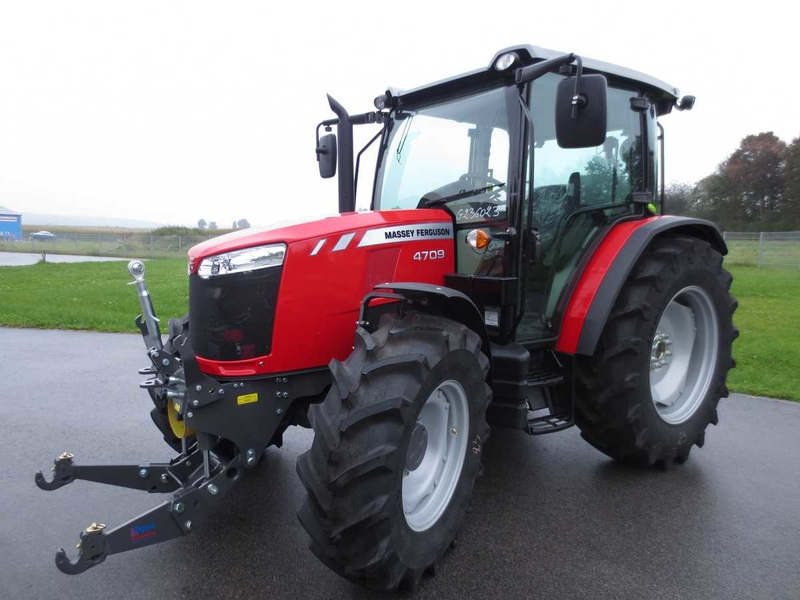

This is where things get a little strange, at least for me. While researching all of this I kept seeing pictures of a 4707 with a mid/front PTO. But searching for that feature specifically was kind of a dead end on Massey's website. Digging a bit I found that a few companies mostly in Europe make a modification (I guess?) that gives a front 3 pt and PTO on many different tractors. Front 3-point Hitch + Front PTO - Zuidberg North America
I asked them for a quote, I'm wondering if the 3 point arms are removable, or if they interfere with the loader when its attached. Either way I thought it was an interesting 3rd/4th/5th option that I should at least learn about. Does anyone know why this wouldn't be a more standard option on tractors on the US? It seems like its more common in Europe for whatever reason.
A kind of broad answer... but it seems to be a dairymen thing, and there seems to be one of those on every corner in Europe, not so much here.

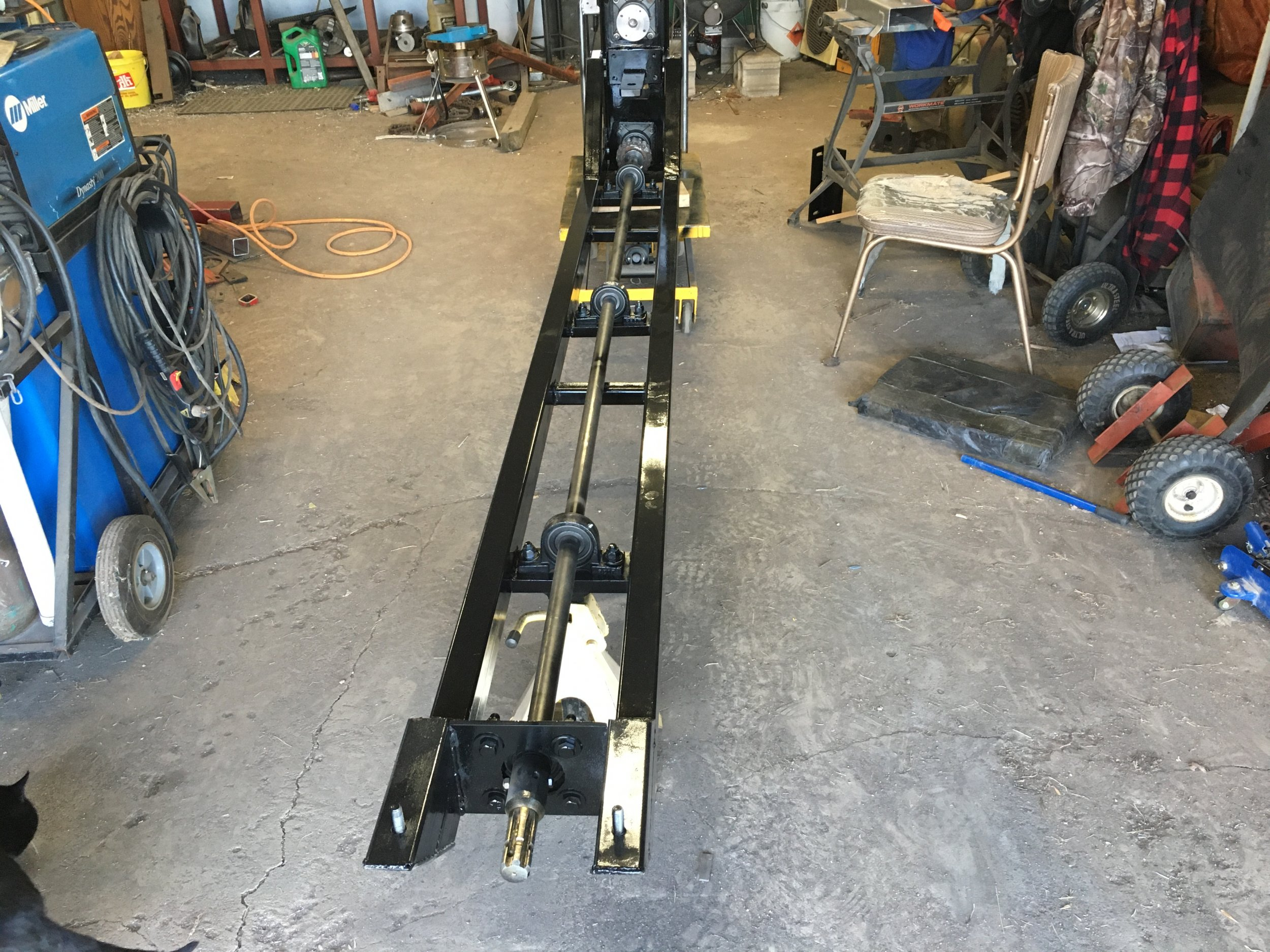

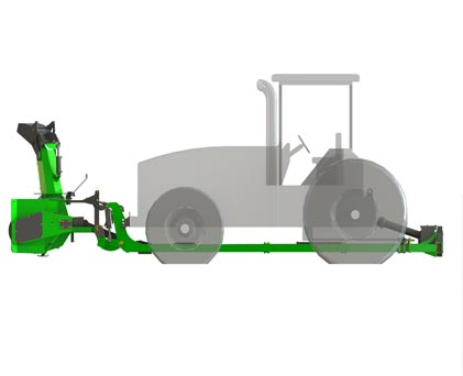

You can have it both ways. Built a rear powered system for my 1742
