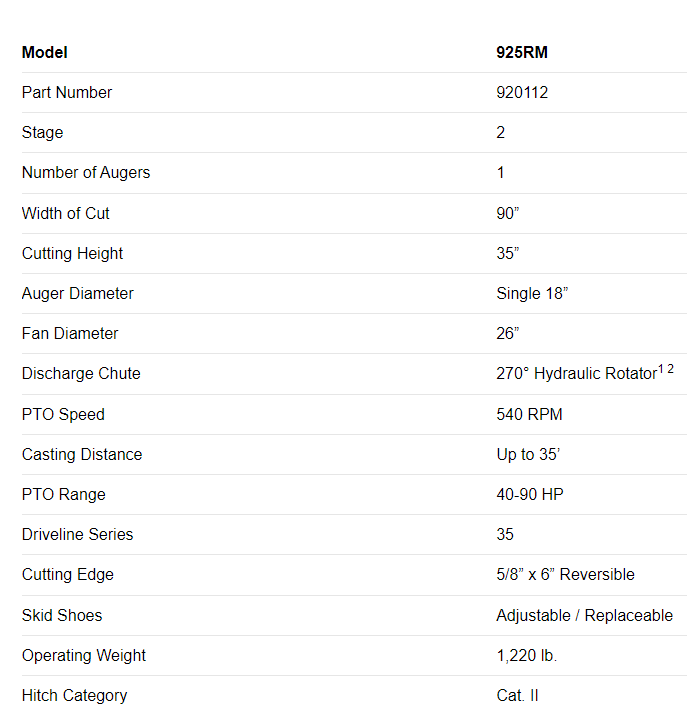

As far as blower, I need to do more research, but I have been looking at the Erskine 925RM. It's 3 point 90inch width, 35inch height, 540pto. I figure something that size will clear my driveway and turnaround in no time.

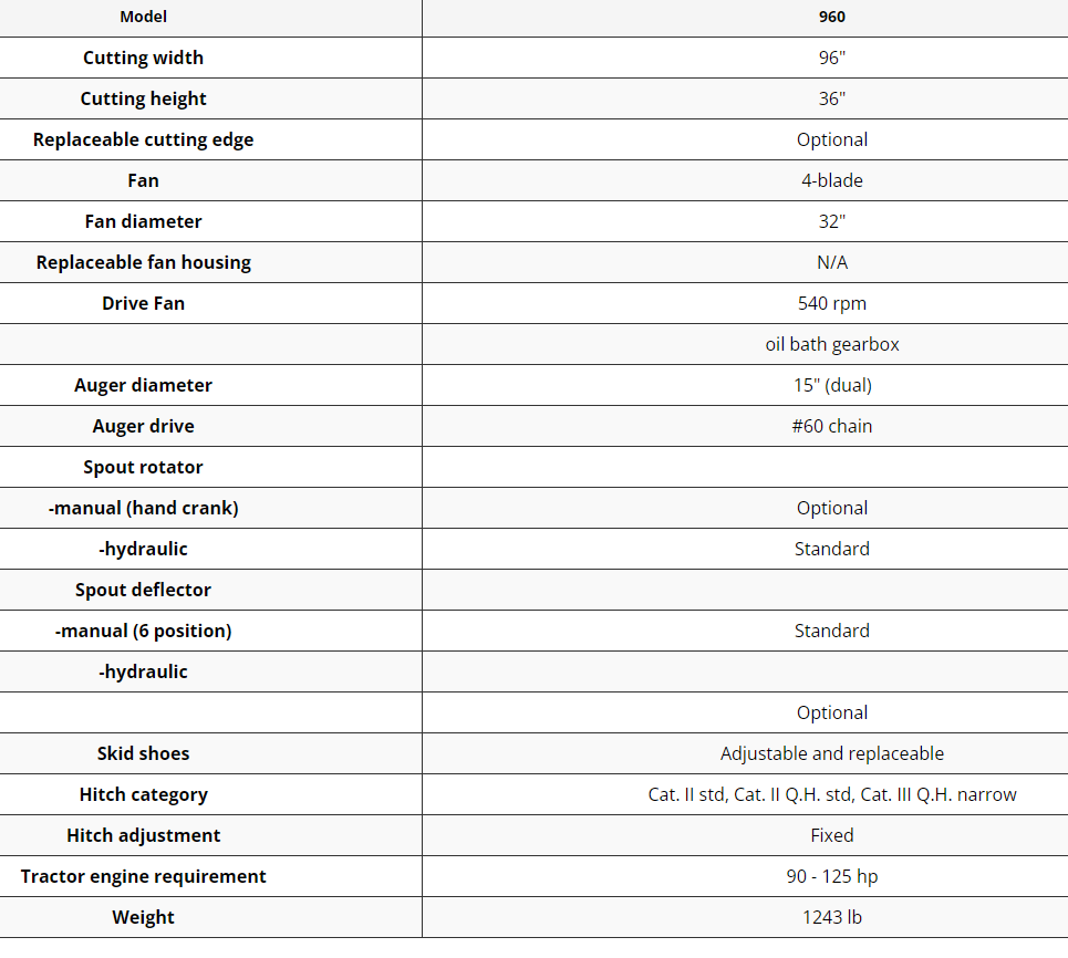

I purchased a 4707 in late December, blew a little snow with it (we had very little here in SD this winter). I have a Farm King 960 on it, and its too big for the tractor IMO. Any drift and it pulls the rpm down in a big hurry, and you have to ride the clutch, which is extremely grabby. I'm really unhappy with how grabby the clutch is. It makes loader work and blowing snow very difficult. A creeper gear for blowing snow on a lower HP tractor like this would be ideal.

see if anyone thought a 7ft single auger blower would be better
Looking at the specifications of the Farm King 960, they want a tractor hp of 90-125. So you are correct saying its a little too large for the 4707. I have been eyeing that Erskine 925RM, single
auger, 90" width, 35" cut height.
I have intentions of tuning my tractor to 100hp or so, once my year of warranty is up
Just kidding, I'll probably be right behind you a few years down the road. Who knows what will happen though.
