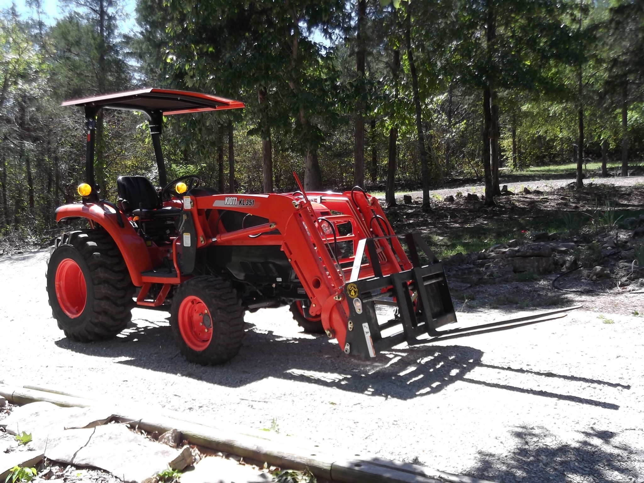

Go talk to Cherokee140 or 4Shorts or Dragoneggs and ask them about the BX and what it can do. The first two even have a grapple on their BX25D's. Me, I am a 35 horse large frame heavy weight kind of guy. Grapples are a very joyous thing to own. So are Pallet forks:D
