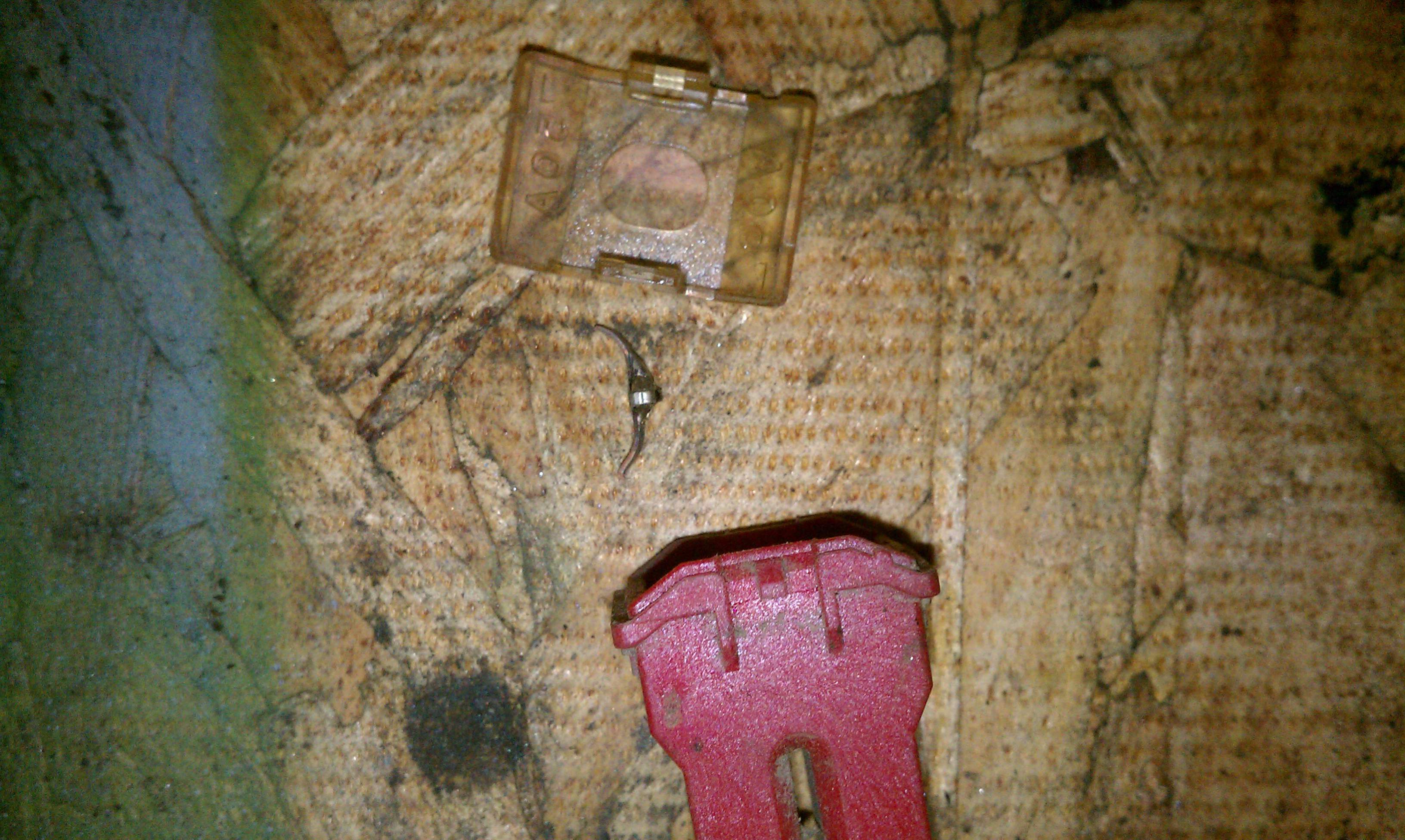

After cleaning the battery on my Kubota 1850 I reconnected the battery cables incorrectly. After a quick 'zap', the dash lights no longer come on when I turn the ignition key and the tractor will not start. I've had time to check the fuses and none are blown. Any ideas or things to check? Anyone have the wiring diagram for the 1850?

there is also a fuseable link inline with the battery generally but i would be surprised if this blew. Unfortunately Fuses allow current to go both directions they don't stop the flow of electrons they are like a 2 lane 2 way street versus 4 or 6 lanes 2 way streets they just limit how many can get through at one time Overload them and they fault.. This is also the reason you can install a fuse in either direction. Diodes keep the direction of electrons flowing like a one way street, but they act like fuse if you reverse the flow they blow if overloaded, protecting other electronics from their demise. So i would suspect that the alternator diode is toast I'm not sure what else is diode protected definitely need a wiring diagram. Diodes are directional and must be installed in the correct orientation

The diode trio and the built in regulator in the alternator would probably be a good start, the main fuse, what ever it is for that model of tractor, My Kioti is an inline 60 amp. Workshop manual is gonna be a must.. You need a good schematic, and and good multimeter, and know how to use both. Good luck.

Alright fellas, I appreciate all of the responses. They have been helpful in providing a starting point for me. That said, I think I'm on to something. I began tracing the start-run circuit this evening with my multimeter and noticed a 30amp fuse that was rattling when I removed it. I don't want to jinx myself but I think this may be the problem.

You may have won the prize if the fuse you're referring to looks like the one pictured in my last post!
