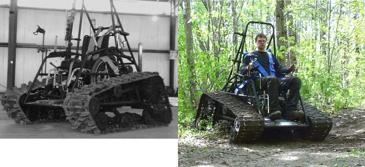

JFTR, that is exactly how the Ripchair is designed:
RipChair
And all this can be yours for the modest sum of $18,500...

the unfortunate part about the Rip chair is that it is designed for someone with a low level disability compared to me. I'm not able to wheel a manual wheelchair, so I'm limited to an electric one. Which makes me in the chair about 600 pounds. Almost everything all-terrain out there is designed for low level disabilities.

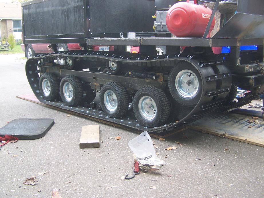

I have about 400 dollars and 80 hours into my tracks. They weight approx 200 lbs each. I have designed for approx 1 PSI so I can go on snow. If you don't need to drive on deep snow, go with a single piece of rubber 6 inches wide, use a single row of at least three wheels on each side. Make up U shaped plates to locate the track on the wheels bolted through the rubber to some form of grouser. Smaller the grouser, the easier for the machine to turn (drag a track)

they look good, do you have any photos of them without the tracks on. So I can see a little more detail on how they're built.
