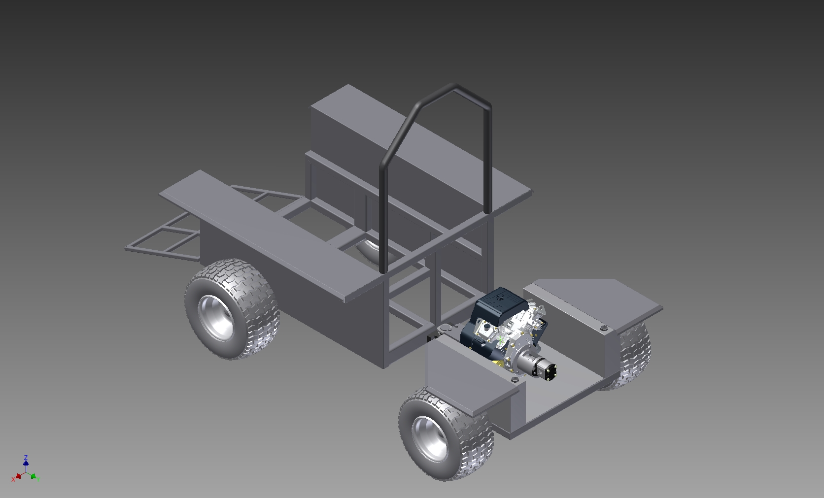

I'm looking for some input on opinions about what would be the best articulating joint. I wanted to be able to go left and right but also be able to rotate. It needs to be as compact as possible and relatively maintenance free. There's many ways that it can be done but what do you think is the best.

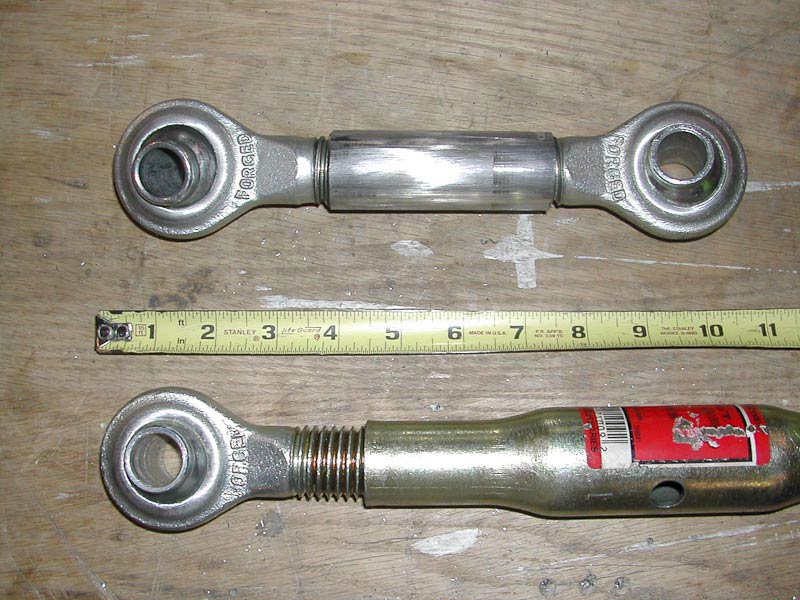

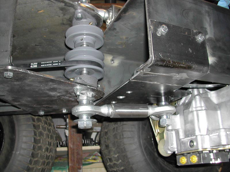

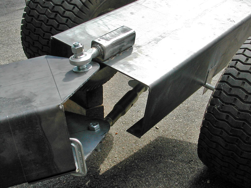

This is what I did to solve the problem. I have hydro axles that are belt driven so the centerline of pivoting had to incorporate a jackshaft for the drive belts. You need to be precise or else the belt length will change to much for a tensioner to compensate for when turning and twisting. My links were made from cat 1 toplinks.

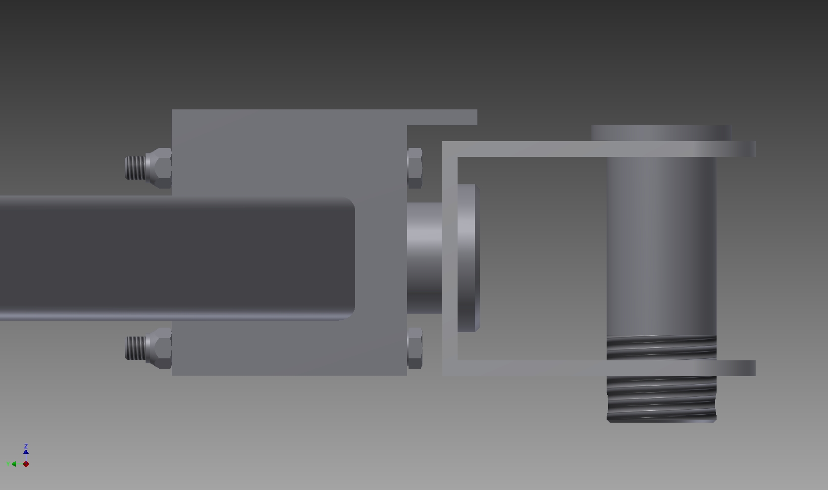

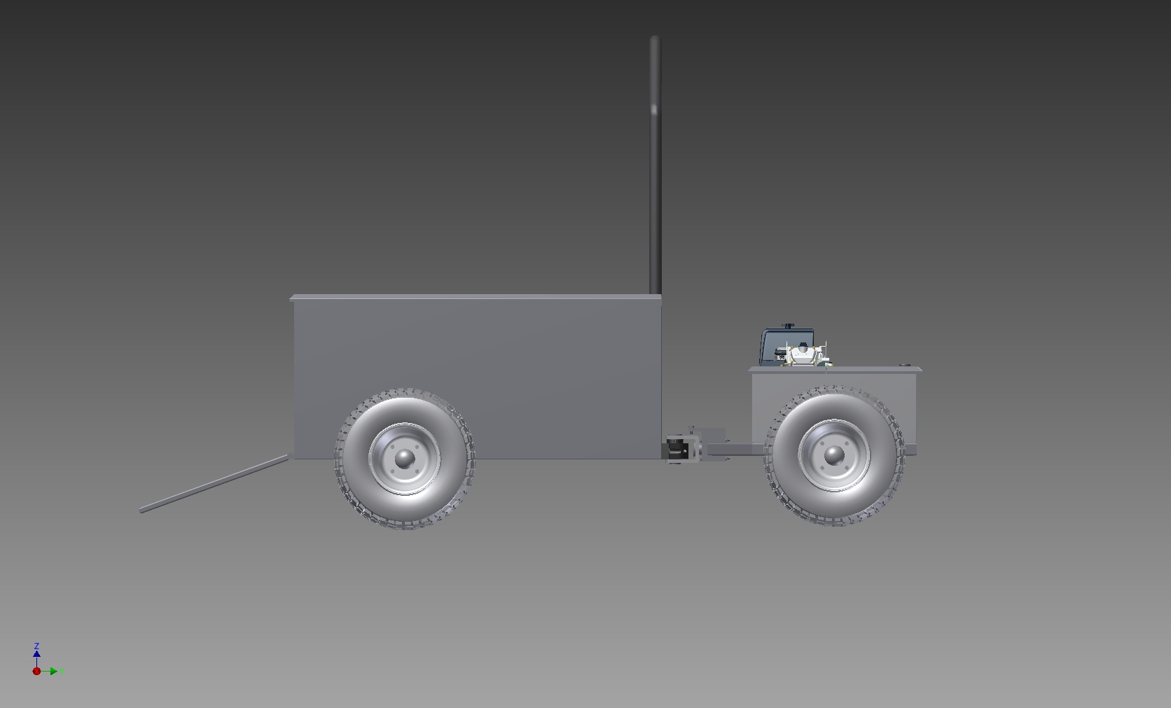

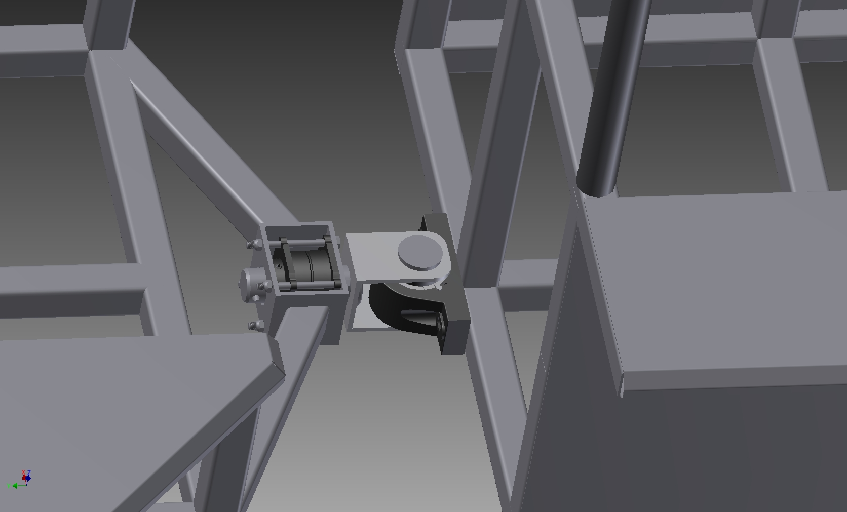

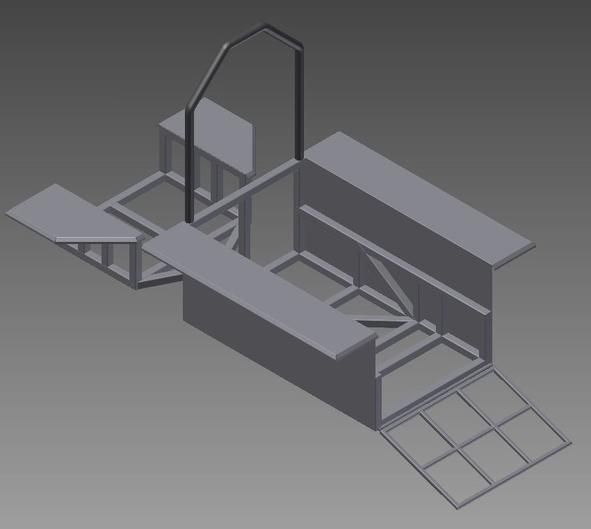

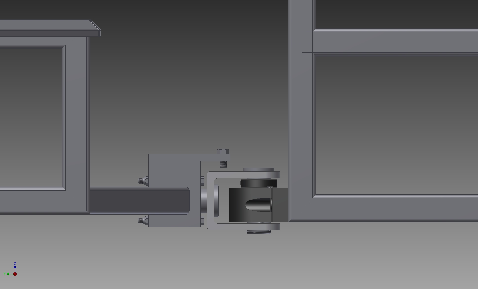

here is a blueprint of what I've been working on. The unique circumstance this machine s that it can't have a front axle, because the front-end needs to be able to lower down. The machine is for a wheelchair user. I've got a close-up of the articulating joint, I'm not quite finished yet, I need to add something so that it can only rotate a certain amount. It goes left and right and allows the joint to rotate in the center.

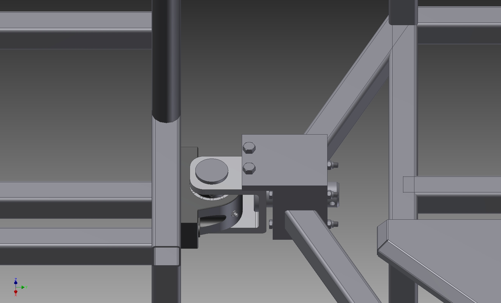

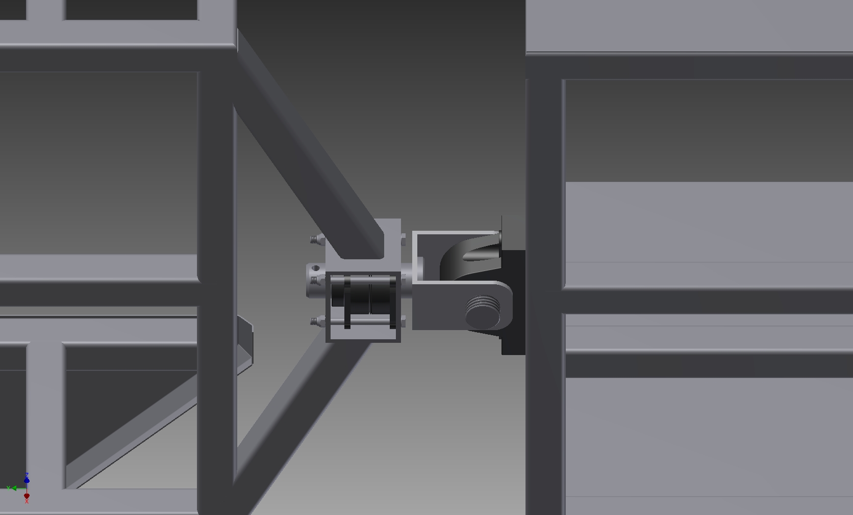

I added a overhang plate, to allow the hitch the only rotate a certain amount. This should prevent it from rotating too much when turning on uneven ground. I plan on using 1.75 inch shaft pins so it should be plenty strong enough. It will take quite a lot of weight, a person in a power wheelchair is anywhere from 500 to 600 pounds. the steel plate is all quarter inch. And all the bearings are very heavy duty and large. The hydraulic ram mounts have to be added yet for the articulating steering. But I have to sort out the hydraulics yet.

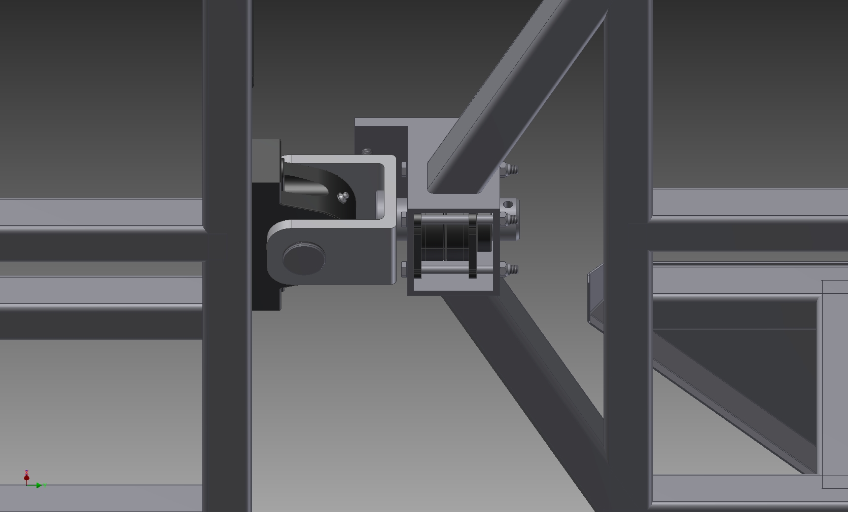

Depending on weight distribution over the axles and the balance point will decide how much added stress will be on that center joint. There will be a significant amount of force and the front piece of that articulation joint that is u-shaped looks vulnerable. I would bend this out of 1/2" plate IMHO.
To limit rotation I would incorporate stops onto the rear portion of the pivot so it stops the u-shaped piece from rotating more than 10-15 degrees.
Could you post some more design photos?

those are good suggestions, and I incorporated it into the new photos. I added bolts to the top to make the rotation adjustable. I also beefed up some of the steel. Let me know what you think.

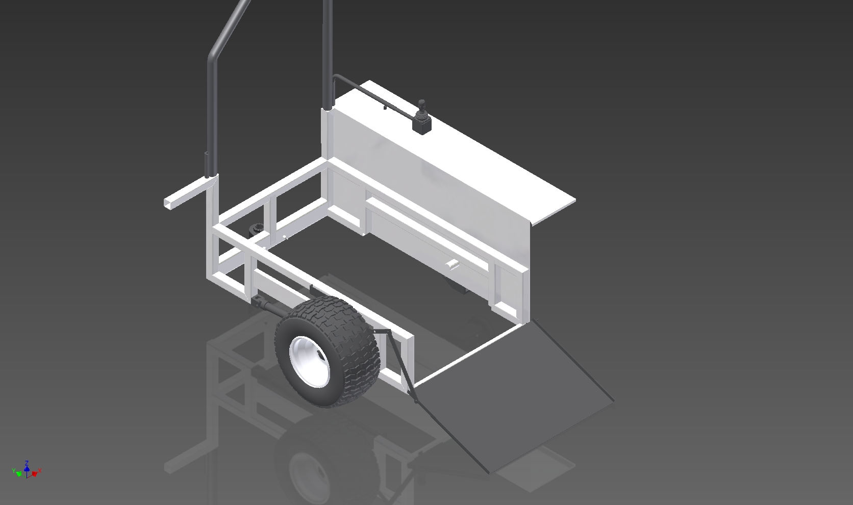

#31

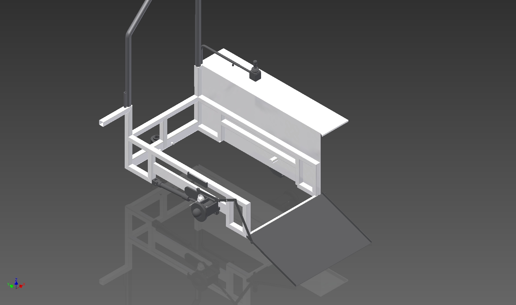

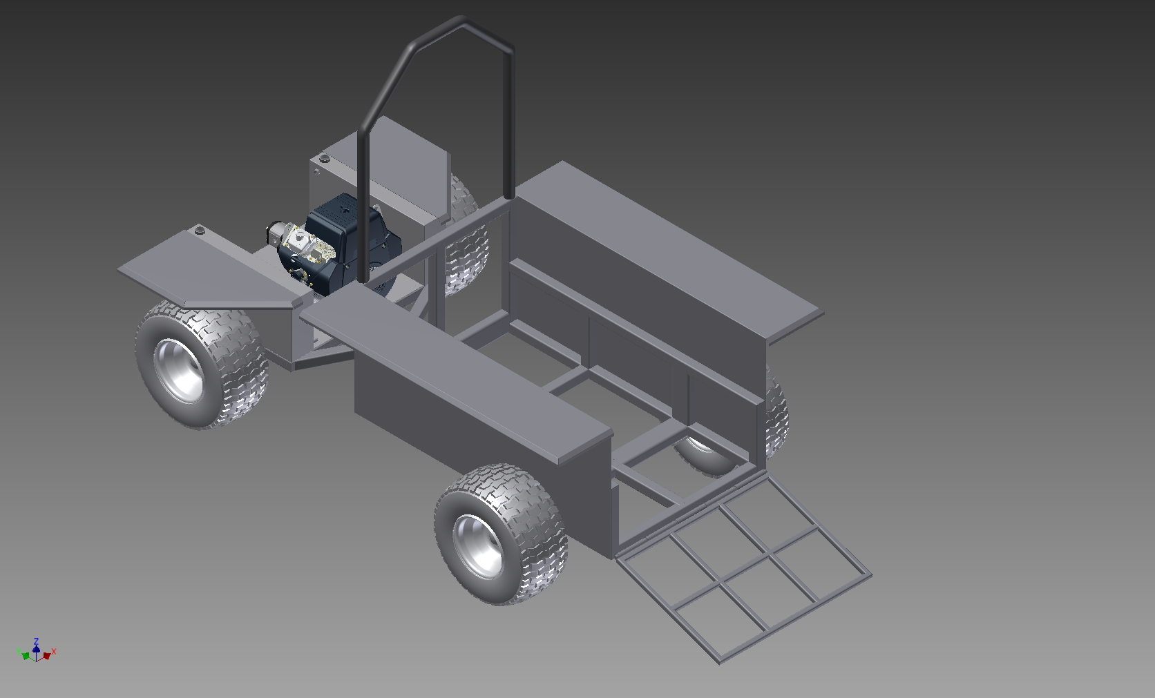

Here are a few update photos of the 3-D design. Subaru was kind enough to send me a full-blown 3-D model of their engine, perfectly to scale with every possible detail. The file is so huge my computer could barely open it. I couldn't find any 3-D files of engines in the 30 hp range, and none of the companies except Subaru were willing to send me a file. I don't think I'm planning on using a Subaru engine, but it is very close to the size that I'm looking for. I think I'm going to use a Kawasaki with a digital fuel injection.
I think I've decided to go without a front-end kneeling system. And just go with the foldout 48 inch ramp. It is about a 1 foot incline, which is a little bit steep but not too bad. I couldn't come up with an idea that I feel would be strong enough to have the front wheels move up and down to lower and raise the front-end. I would love to get some input if someone had a creative idea.

/ Hydrostatic ATV #32
Build a swing arm that the wheels are attached to. Now have hydraulics raise and lower the "seat" inside the footprint of the swing arm.
They have skid loader trailers that the whole bed drops down to ground level. If that system can hold a skid loader, you should have no problem holding a mobility scooter or powered wheel chair.

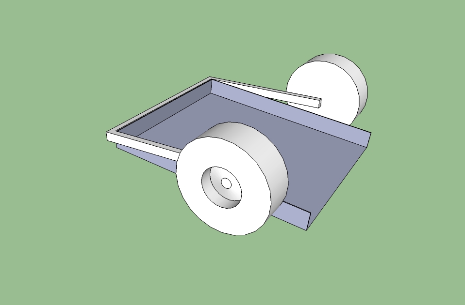

Here are some simple drawings of the swing arm concept I'm talking about...

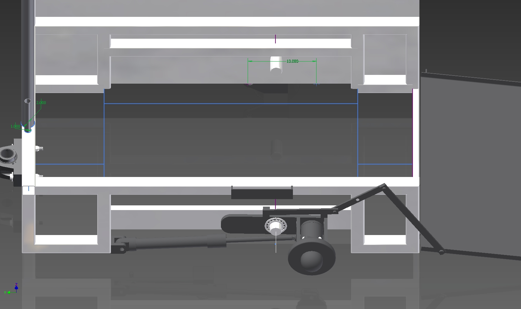

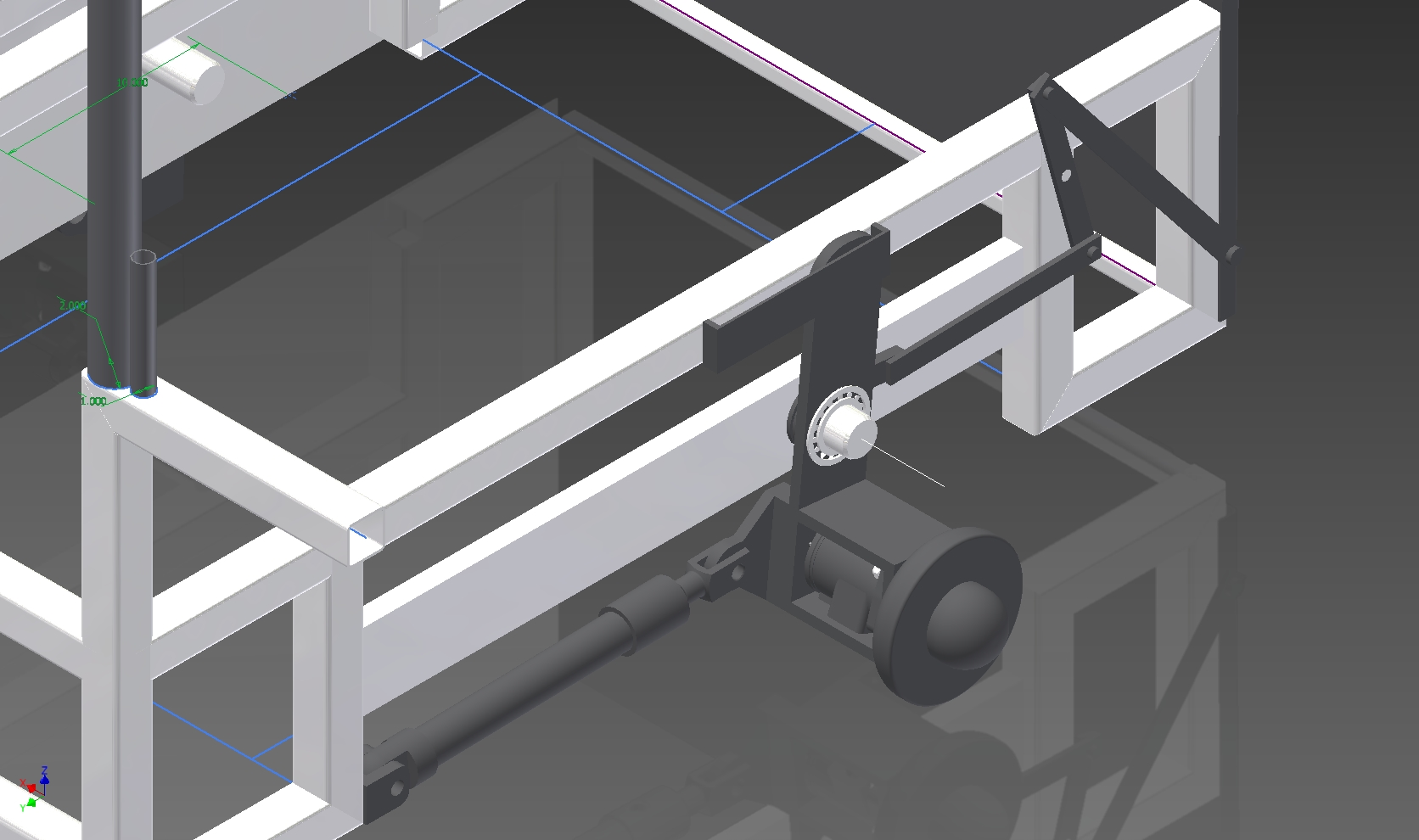

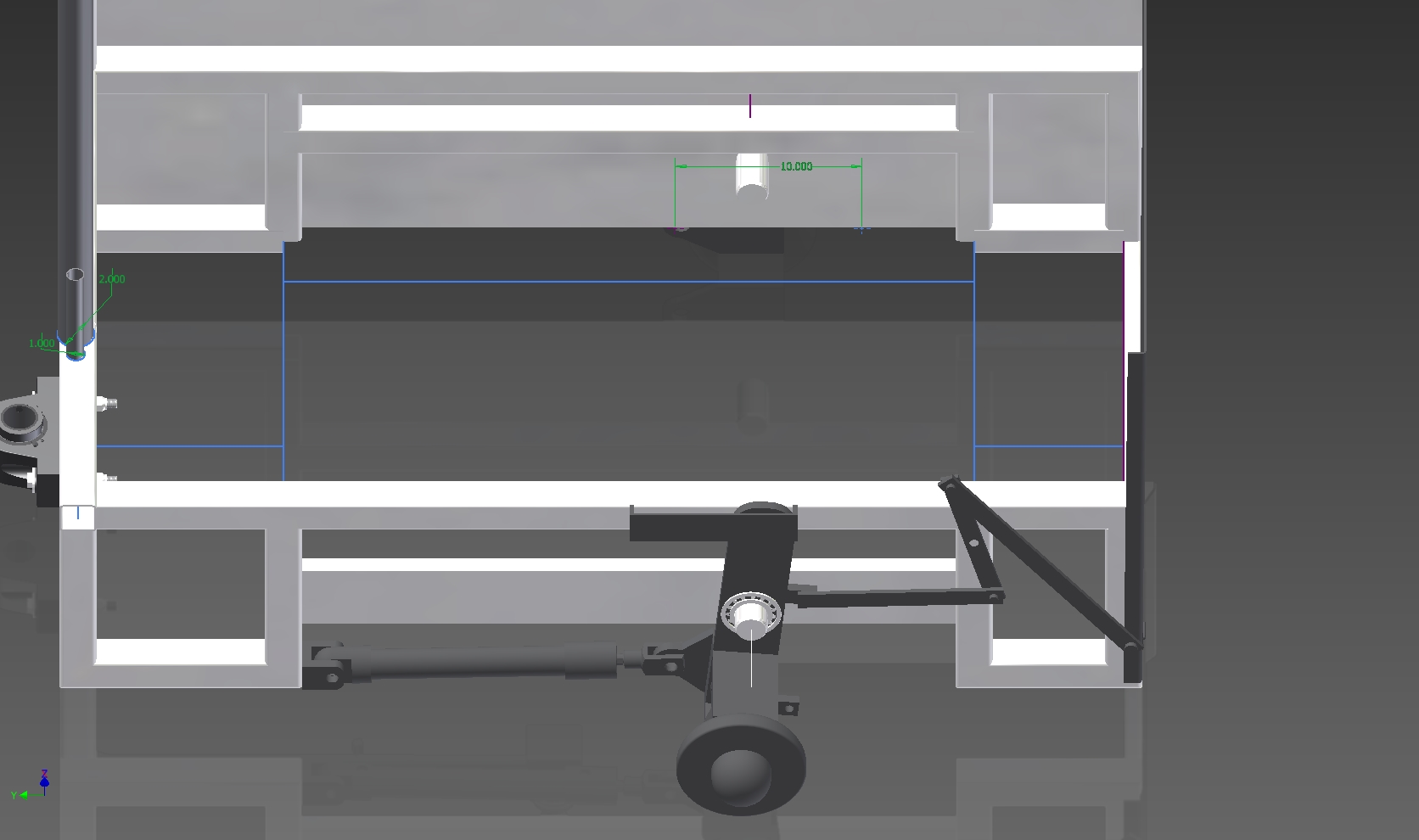

I tried a little bit of a different approach, I wanted to incorporate the fold up ramp into a fully automated system, to reduce the amount hydraulics. The pieces for the foldout ramp are a little crude yet, but now that I've got the ratios right, I will start to incorporate better pieces. Does the system look strong enough, I used a thrust bearing between the mainframe at the wheel motor mount, there is 1.75 inch shaft holding it together. Let me know what you think.

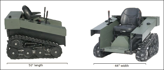

I've also been considering changing my design to a similar machine as the photo attached. But I can't seem to find a track that will be long enough for my needs. I think one for a skid steer would be way overkill. My machine will be about 80 inches long. So the track would have to be very close to that. Because if I do go the track system, I will just have two tracks. It will help make the hydraulic systems less complicated.
All the ATV track systems are designed for the four-wheel system. Any suggestions.
