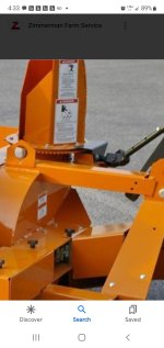

Hello,
Does anyone know where I can purchase a hydrolic chute assembly for a WOODS 3 point snowblower?
WOODS discontinued the snowblower.
Thanks

Unless you can find a dealer who has one in stock you will either have to make one or adapt one.
Do you have a picture of the snow blower?
There are a few common ways that people go about it, but it depends on how it is set up.

This is a good application for a simple 12v 'linear actuator'. Not used continuously and light loads and no 2nd hydraulic circuit is required on the tractor.
I have 3 rear remotes and I've contemplated adding a chute deflector to my blower and decided that IF I did, it would be an electric rather than hydraulic for simplicity and probably less costs.
/ Hydrolic chute for WOODS snowblower #5
I agree with going electric. Whether it's a linear motor or a wiper motor would depend on the current setup. If it has a crank setup now, adding a motor and a mount is probably a 1/2-hour job.

You don't really need a chute assembly, just a hydraulic kit for the one you have, right?
Is yours set up for a bellcrank and hydraulic cylinder to turn the chute? Or do you need a hydraulic motor to engage the teeth around the base of the chute? Either way, I'd investigate the other snowblower brands. When I needed a bellcrank and hardware to convert mine, I found that many used the the same parts. Woods might be compatible with Meteor, Blizzard, FarmKing, Buhler, Frontier, . . . at least I'd try to look at their parts diagrams and compare.
I much prefer hydraulic chute rotation if you can find it. I bet you can find the exact parts you need under a different brand name. Just look for the "optional" parts / kits for similar size snowblowers.

Yes, I did check with them, they only have the parts and not the whole piece already assembled.
I may have to go that route.

@NWKIOTI looking at your picture, can you take a picture with the black cover off?
I would think one of the motors from: Low Speed High Torque Hydraulic Motors | Hydraulic Motors | Hydraulics | www.surpluscenter.com could be made to fit and there is a good chance that they have the bolts for the cover setup for a 2 bolt bracket motor such as: 7.9 cu in White Drive Products 281130A6321BAAAA Hydraulic Motor | Low Speed High Torque Hydraulic Motors | Hydraulic Motors | Hydraulics | www.surpluscenter.com
If not, a bracket such as Mounts for Hydraulic Motors | Hydraulic Motors | Hydraulics | www.surpluscenter.com could work.
Beyond that, I second the advice to call Messicks, they are a big dealer and there is a good chance that they have a ready to go kit on the shelf.

Now that someone said something about electric, I believe that is what I was able to find talking to someone from German-Bliss and that is all that was available from Woods. I don't think that they had a hydraulic. In the end I did not get it because I did not like the cost for the OEM unit. I also did not want to fabricate something on my own so in the end I just stuck with what the blower came with as the crank is not hard for me to use and I only need to adjust the deflector low when I have no choice but to blow into the wind, which I can usually avoid.
