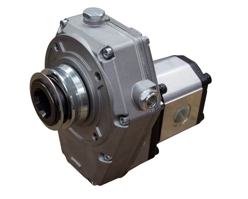

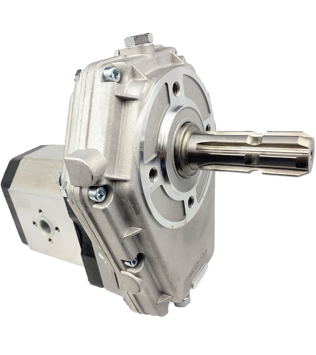

Here is a PTO speed increaser with the pump mounted to it. This one mounts the implement and you need a PTO shaft.
Alternatively, there is this style where it goes over the tractor PTO shaft:
The advantage of using a speed increaser with separate pump, instead of a big ol'pump directly on the shaft, is that this way, you can mount whatever pump displacement that fits the application the best.

I have an Erskine front snow blower with a PTO hydraulic power pack, specifically their HP-24. The "pump" is actually two separate parts bolted together. One part is a hydraulic pump, and the other part is a step-up gearbox. Here is a link to the one on mine, and I expect there are others. I don't know off had what the ratio is.

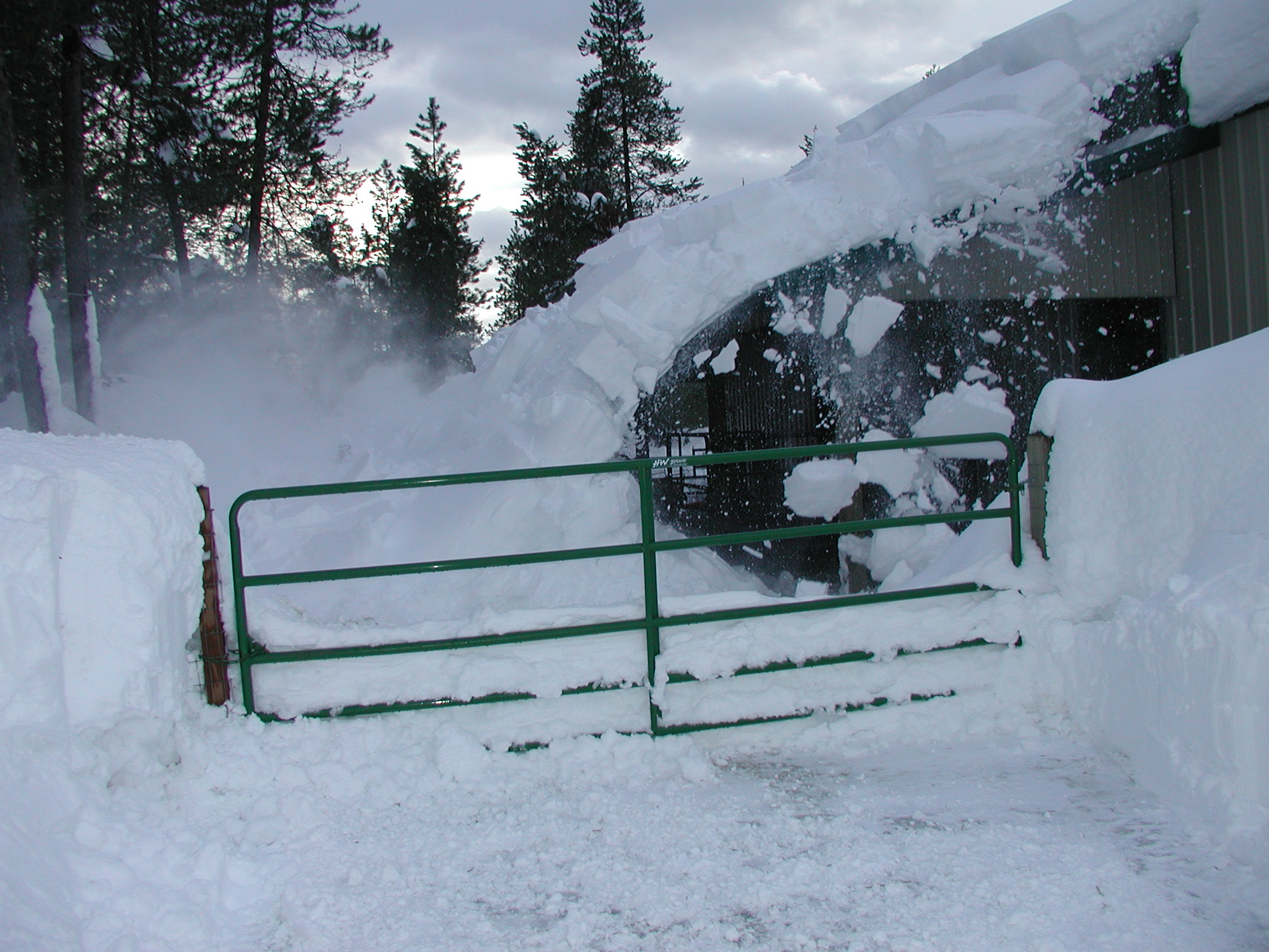

When my barn sheds, this is what im left with.
I have to clear it so horses can get out of barn. When its this deep, i have to blow it in levels, but doesnt take very long as i can raise the blower.
