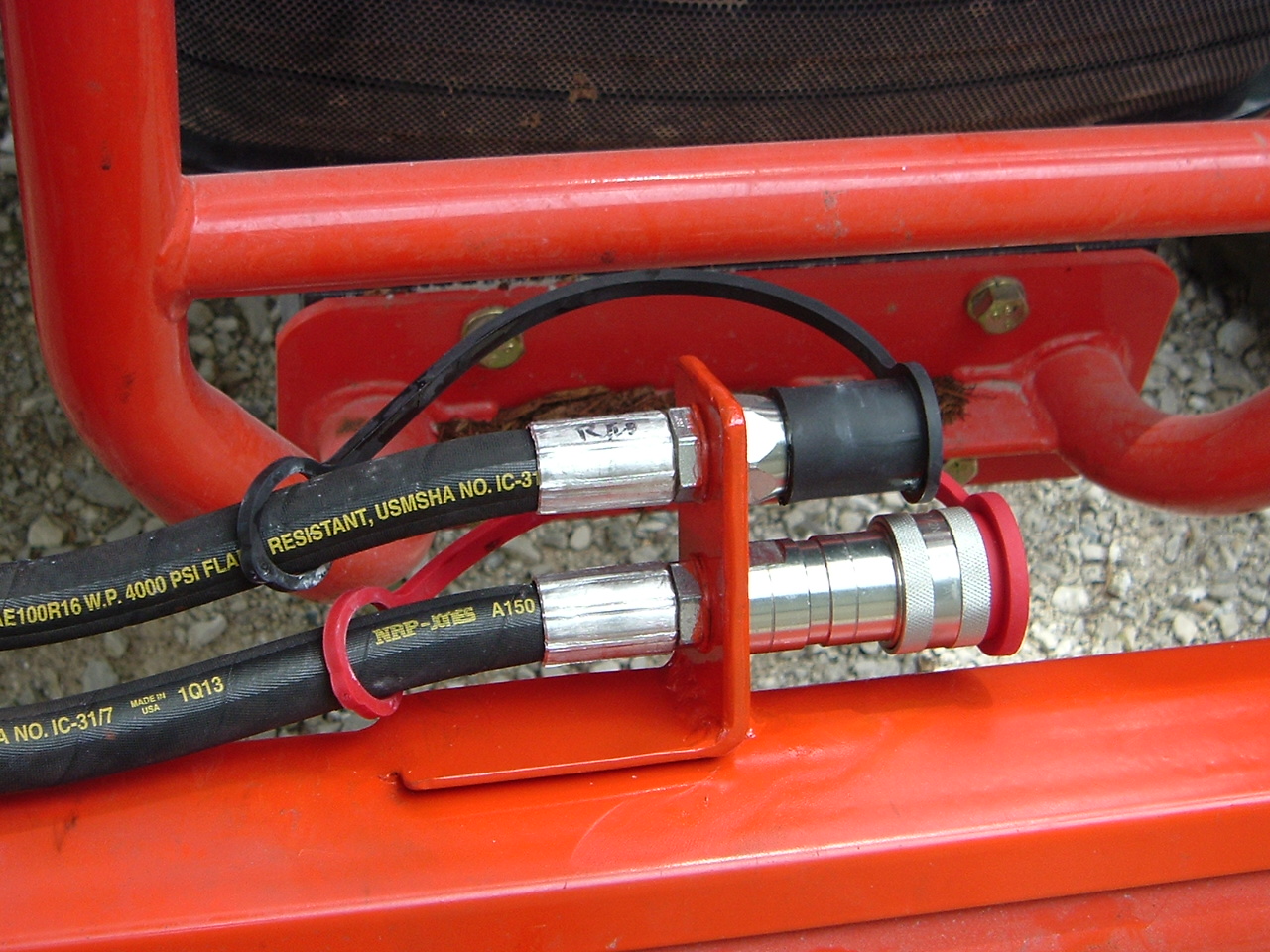

I like his idea of using the 3rd function on the FEL. Makes it very simple to install/uninstall. Adds versatility. The QA plate could even be made to go on the 3pt too and use a rear remote valve. Just need to make sure that whatever houses the the winch has it's own anchor system.
