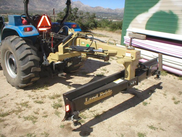

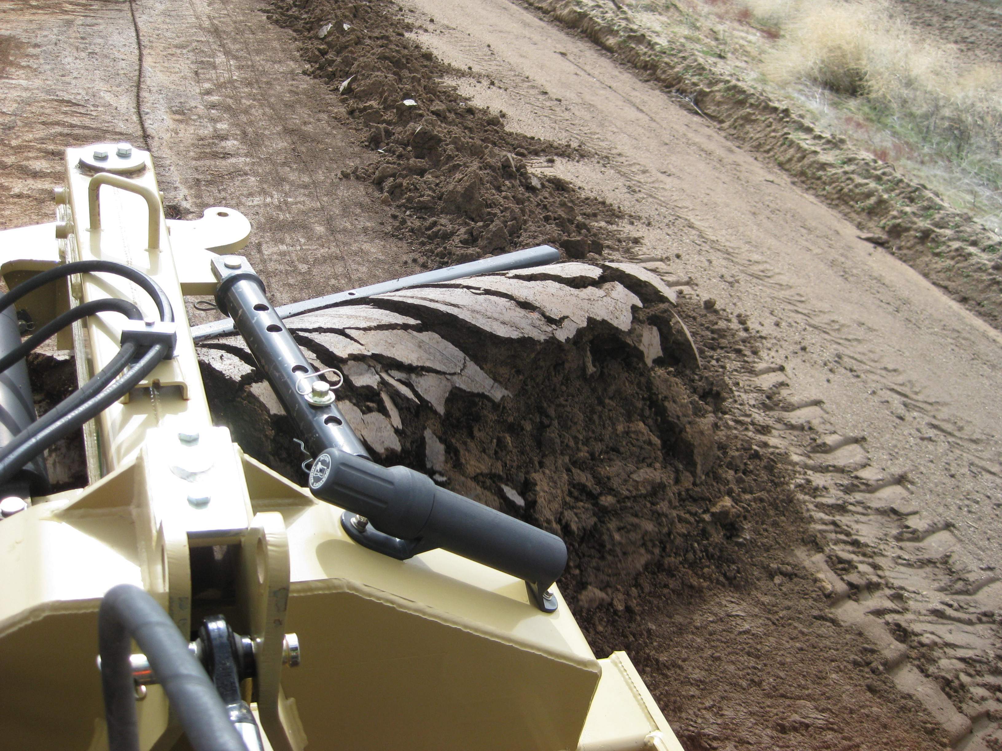

Here is the perfect blade for you. An RBT3596, either manual adjusters or hydraulic, just a good blade all around. Be sure to get it with skid shoes. If you decide that you want to go hydraulic, let me know, I can probably save you a few hundred and supply you with welded cylinders instead of the tie rod units that LP provides.
