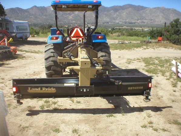

You can see on this Land Pride RB37 series that the angle cylinder (if equipped as an option) has to be mover from one side to the other. The turn table only has a single point of attachment for the cylinder. But this only occurs on single function hydraulic units that can only have 1 hydraulic on the unit and is for angling the blade. I emphasize the single hydraulic angling because there are also single hydraulic units where only the offset function is hydraulic, and they too have to have the hydraulic moved from one side to the other depending how you choose to operate the unit.
To the best of my knowledge, ALL rear blades that have the 3 blade functions available for hydraulic functioning do not require having ANY of the cylinders moved to be able to provide a different function, actually they can not be moved, they each have their separate locations. Look at this Land Pride RBT3596. You pull the blade angle pin from the rod end and rotate the blade clockwise. You turn it clockwise so that the blade tilt hoses spin around the boom and not under it. Probably takes all of 30 seconds. Notice that the turntable has 2 points of attachment 180* from each other.
My blade is the same other than I currently do not have hydraulic tilt on my blade, so I can spin my blade in either direction. ;) The second picture is with full offset, so I can reach out over 4' past the edge of my tractor. :thumbsup:

I guess maybe some hydraulic blades are a pain having to change what side the hydraulic is on. You will find that is with the hydraulic angle only blades, not the ones that have hydraulic offset capabilities. I assume that you pull a pin and rotate 180* for your blade, I can do the same thing. No big deal. ;)

I have three hydraulic functions - angle, tilt and offset - and have to move the cylinder.
It's not a big deal as the way rear blades are used, you are almost always changing the direction of travel anyway. And it's still great going from straight to angle with the hydraulics. I do sometimes wish I had the full range though.
It's a really heavy duty blade and I did get a good price on it, so hard to complain. I will probably order the box sides for it soon.

What make and model is it? I can't remember ever seeing a 3 hydraulic function blade where this had to be done. :confused3:
