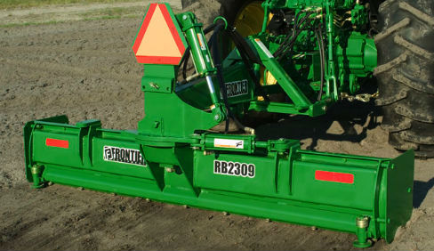

Hydraulic is great. I have a 3-function hydraulic blade. But it's also stupid. The cylinder only works to send it angling in one direction or straight. You can't go to the other side without switching the cylinder. Seems like a complete waste.
/ Hydraulic vs Manual Scrape blade #32
I've never been around one so not sure if that's common?? I guess it must be common for Frontier??
/ Hydraulic vs Manual Scrape blade #33
Looks like that style blade is straight when the cylinder is fully retracted.
The 21 & 24 series Frontier blades are not like that. None of the Land Pride blades are like that. Equal amount of angle to each side, typically around 45*. You're pretty much screwed if your grading an S shape drive, or just want to turn around at the end and come back grading also.
So just to confirm for others, the hydraulic angle for most rear blades does indeed angle the rear blade to both the left and right side. ;)
