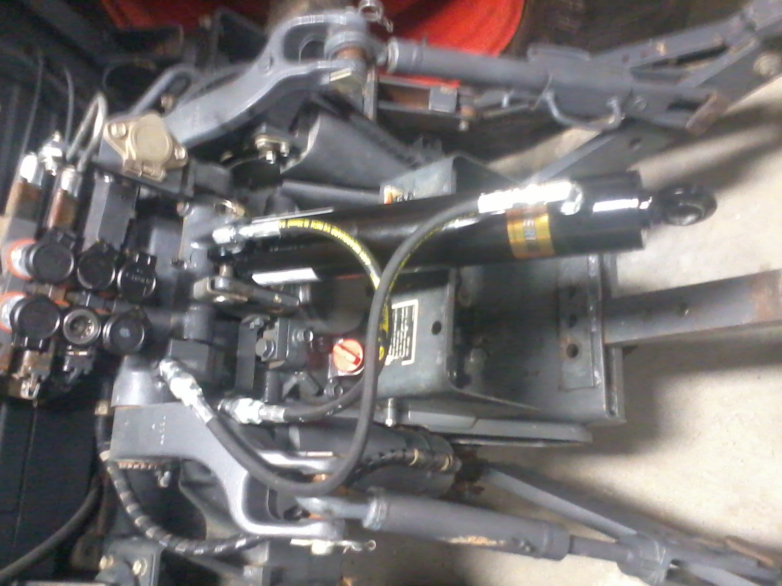

I wouldn't go any less than a 3" bore.
More volume means any leakage in the cylinder or valve is gonna be much slower due to more oil for a given distance.
Bigger cylinder also reduces the pressure of the oil confined with a given weight hanging back there. Also slowing and drift caused by cylinder or valve leakage.
That 2" bore cylinder shows 4300# of retract force. The hitch can lift 5500# or an optional 8000#+. Add the leverage of any length like a mounted 10' cutter or other heavy and long implememt..and you WILL have issues

I'm using a 2.5 inch cylinder, and 1/4 inch 3000 psi lines, to help slow the cylinder and provide more surface area for the load
It isn't a matter of opinion. You are just flat out wrong on so many levels. And it's clear that you have no idea how the geometry of a 3ph works or the forces applied.
2.5" cylinder is worlds better than a 2".
No way in h3ll would I spend the money on a 9540 and then limit myself on 3ph implements because I wanted to skimp on the toplink

Let's look at the facts, which you seem to confuse with opinion.
I'll use my MX for example....with a mounted woods ds96 cutter. Which is an 8' twin and weighs 1620#
The weight is centered on this cutter right about where the gearboxes are. Which is about 30" behind the lower pins.
The toplink pin is exactly 16" vertically above the lower pins.
When the cutter is raised, that weight 30" back is like the long arm on a crowbar...and the 16" is like the short arm.
The amount of force PULLING on the toplink is INCREASED. By a factor of 30/16.
With the 1620# cutter that is about 3040#.
If I had that 2" cylinder you linked with it's 1-3/16 rod...it has 2.04 SQ in of piston on the rod side. This would make the pressure on the rod side 1490psi.
A 2.5" cylinder with 1.5" rod...3.14 SQ inches on rod side....psi would be about 1000
With my 3" cylinder and 1.5" rod and it's 5.29sq inches of area....psi required is a modest 575psi
But these are optimum figures. In the real world the cylinder is mounted on a bit of an angle. Making it require a higher pressure. The exact amount depends on the geometry of your machine and which mounting holes the toplink is in.
In reality.....it takes 750psi to lift my cutter because of the angle. Or about 30% more that what is calculated for a straight line pull on the toplink.
That would mean the 2.5" cylinder would need to sustain 1300psi. And the 2" cylinder would need 1940psi.
And this is just a lowly 1600# 8' cutter.
Based on that, a 2.5" cylinder would limit you to about a 3000# implement and no more than 30" back. Farther back....or heavier and you are outta luck. Forget about running a mounted 10' rotary cutter of any robustness.
Not really quite sure what you are trying to save or trying to prove by going with a smaller cylinder???

The lifting force of the tractor is determined by measuring the force applied by the 2 lower arms. The top link is has the pivot load, and for the most part is along for the ride. The TL does not pickup the entire load. If all things were equal it might have 1/3 the load or 1833
Then, just take a moment to think why 3 pt backhoe usually break the top link mount and the top of the transmission case on tractors...
We also have to consider bouncing of heavy implements in the back of the tractor when going on a rough terrain. That's a lot of force on the top link.

The 30/16 factor means nothing. How does the 30 in arms extension compared/calculated to a distance separating the upper link to the lower arms? Both lower and upper extensions are extended, and at different lengths, but where is the calculated loads on each and how the difference in angles apply's to total load.
This is the basic concept you fail to understand.
The 30" has nothing to do with the lower arm length. Its is how far BEHIND the lower arms (specifically the ball ends) the load is applied.
You fail to realize that when you lift something....your load (implement) is rotating about the LOWER pins. The ONLY thing keeping the rotation in check is the toplink. The toplink that is in TENSION. The toplink that is mounted (in my case) exactly 16" above the lower pins.
What that means in simple terms is.....a load 16" BEHIND the lower pins....its 1:1 ratio. Every pound you put on @ 16" is PULLING on the toplink by a pound. At 32"....every pound that you put on....is pulling with TWO pounds of force.
Since MY rotary cutter is 1620#....and the center of that weight is ~30" behind the lower pins....that is ~3040# PULLING at the toplink pin where the implement attaches.
Since the Toplink is mounted on an angle (and that angle is adjustable with different mounting positions) the toplink sees MORE than 3040# of force. In my case how the cutter was mounted....about 30% MORE force.
Its about as simple of a lever as you can get . Draw a line like this |____ (kinda like a carry-all platform). with the pivot point being the the corner of the 90 degree angle. Believe it or not....crowbars, nail pullers, hammers, gorilla bars etc all operate of this same leverage principal.
To prove your point, there would either need to calculate the load variables at given angles, or would need to at least install the other size cylinders and measure the pressure with the same gauge.
No need to try all different cylinder sizes. The relationship to cylinder size (in sq inches of piston area) and PSI is linear.
For someone who still seems to think that the toplink only sees 1/3 of the weight on the hitch, and still thinks a 2" cylinder would be enough for your 5500# lift capacity, it is clear you simply do not understand yet. And weather you will ever understand (or admit to understanding) is another matter.
The fact that SEVERAL other members here with similar machines ranging from the 7040, 8540, and 9540 all say they used 3" cylinders. And the fact that one of the most respected toplink guys recommends a 3" cylinder for 60-100hp machines should tell you something right there.
But maybe you never plan on using more than a few thousand pounds of your capacity? Maybe you will only use light attachments like a landscape rake, or bale spear lifting 1000# bales? You will certainly be alright with a 2" or 2-1/2" cylinder if thats your plan. I just dont understand the logic of limiting your rear hitch to something a 50-60hp machine could do just to save a few bucks....when you spent several grand more to get a 100hp machine instead of a 60

Got the eye cut off and longer one welded on yesterday
