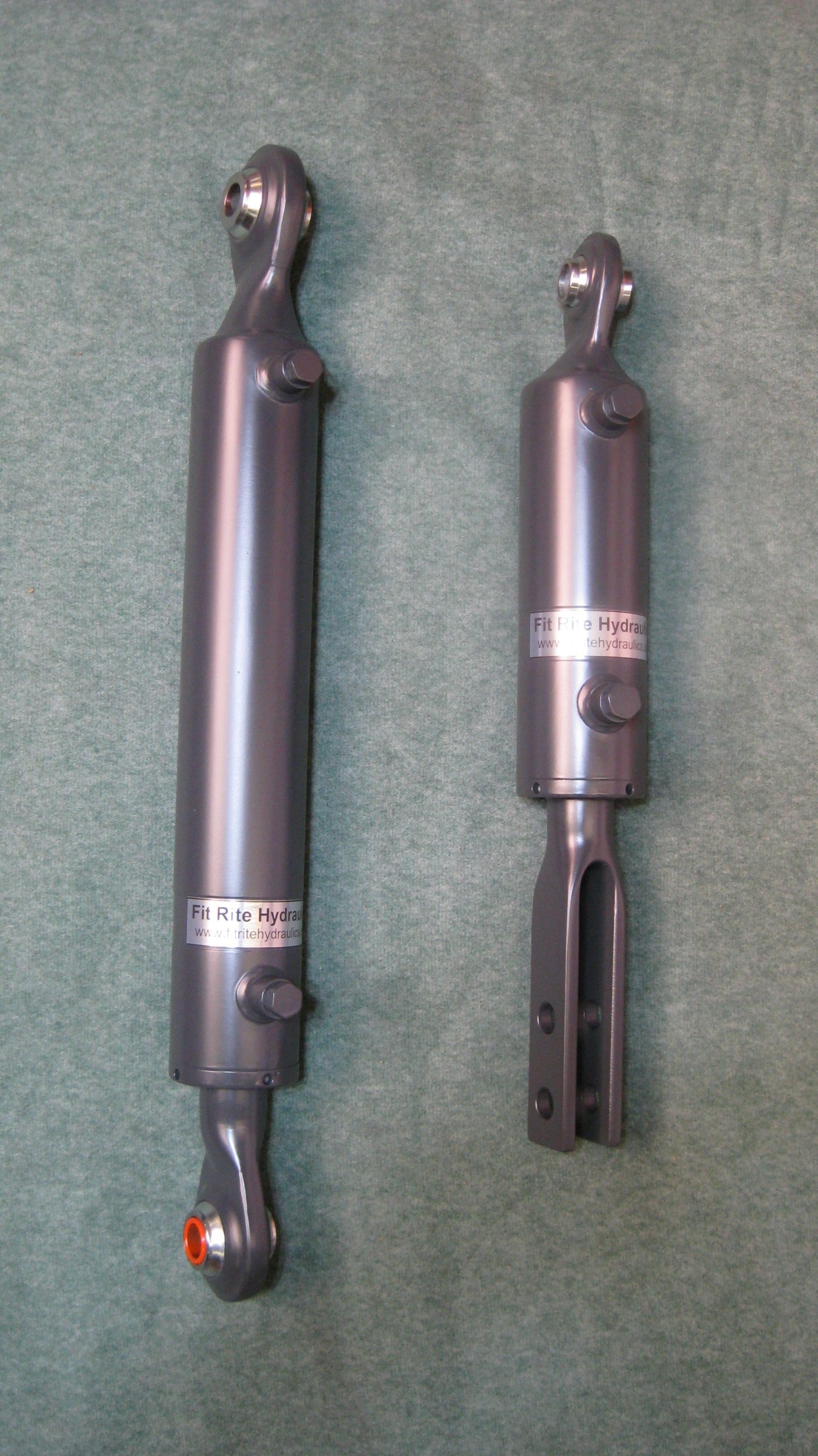

I need to order a Hydraulic Top Link for my new L6060. The mechanical top link it came with is Cat 1 on the tractor side and Cat 2 on the implement side, and seems to have a minimum length of 24". Im running at about 32" +/- with the arena drag we currently use, and use a bushing to to come back down to a Cat 1 size. Tractor supply seems the easiest place to order one, should I get the Cat 1 25-9/16 to 41-5/16? Or shoudl I go with a cat 2 and use bushing to come back down to Cat 1? I dont know what the future holds, but all my current implements use a Cat 1. I did just upgrade from a 35 and 40hp tractors to this 6060, so should I go with the Cat 2?
edit to add: I just noticed they do sell and Cat 1/2 hydraulic toplink in a 25-9/16 to 39-15/16 length, is this my winner?

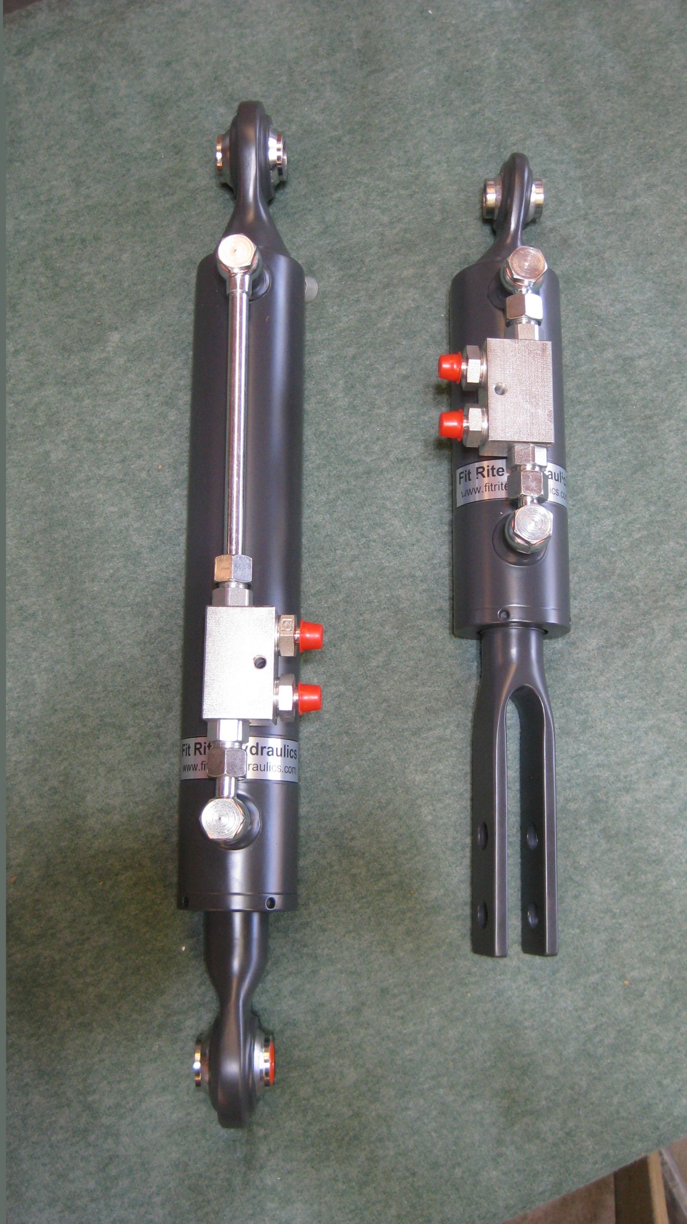

Ideally a cat-1-2 with a 2 1/2" dia cylinder and a 1 1/2" dia rod with a working length of 23 1/4"- 35 1/4" has worked well for the cat 1-2 & MX series tractors that I supply top & tilt sets or just top links for.
There is no good reason for anything longer than 36" other than if you are using some sort of quick hitch draft link ends.

Am I correct in assuming that check valve prevents the rod from moving over time without input on the controls?
   / Hydraulic Top Link for L6060 #7
Yes.
   / Hydraulic Top Link for L6060 #8
If you have crappy valves, you TnT cylinders will drift. Having gone through 7ish OEM Kubota valves, I've only found 1 that doesnt suck. I gave up & had the deaer put a DPOV on my side link & the one good valve on my toplink. I love float on the toplink & wouldnt give that up. A DPOV breaks float.
My loader valves are nice & tight. My loader takes days or weeks to move. But my "good" toplink valve will extend in several hours. My side link would extend all the way in under an hour & its not one of the worse ones they tried.
