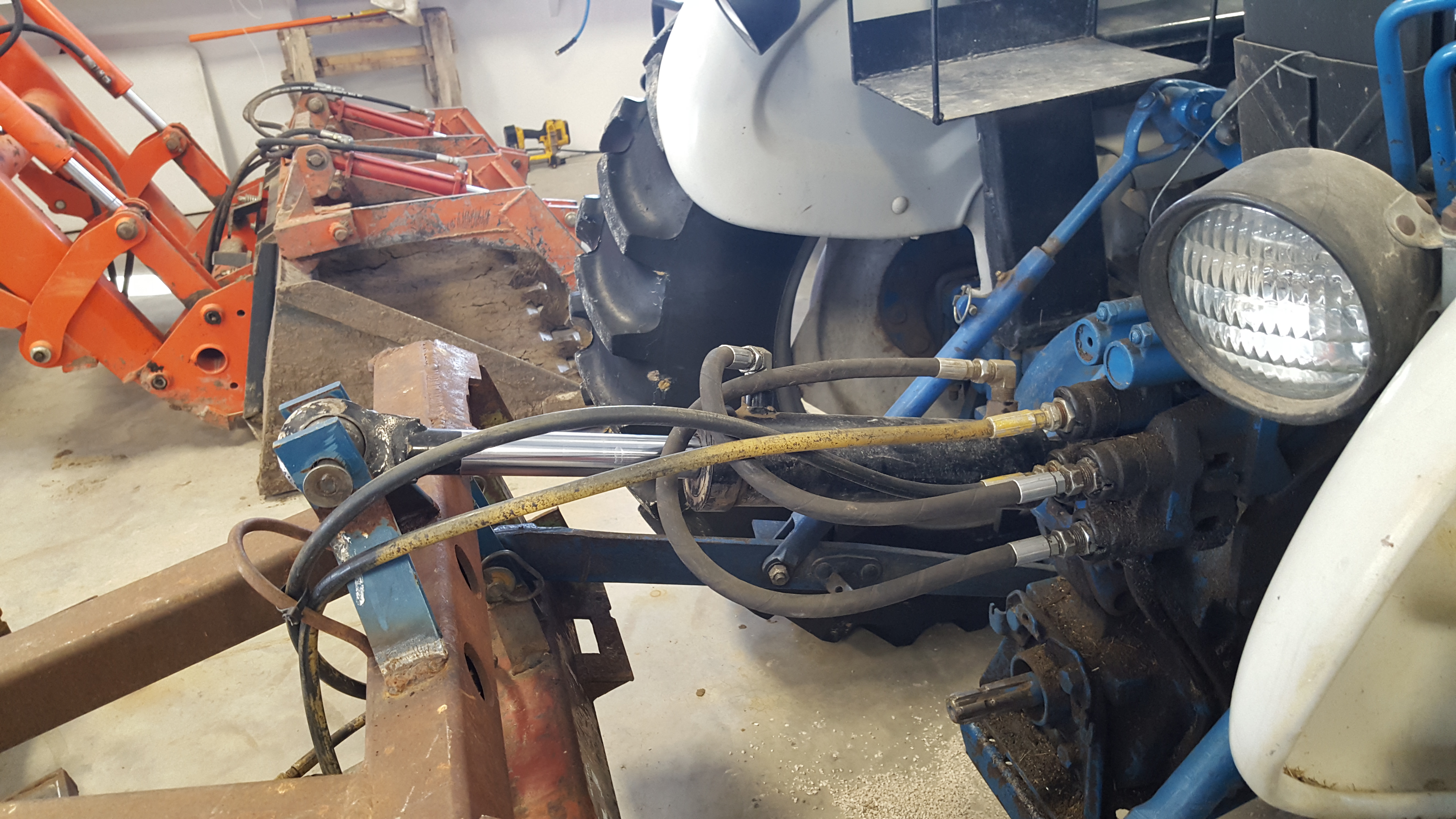

All parts arrived except the 3/4 to 1 inch bushing. Picked up a 2.5 cylinder and there isn't much room for the cylinder to pivot. Once the bushing is installed there will be a tad less, but it still does move
/ Hydraulic Top Link M9540 #24
Yeah, you can't run it like that. You are risking breaking the tol link bracket on your tractor. That's why I built mine.
#25
Guess its either cut the eye off and add a spacer, or get a clevis knuckle. Think the knuckle will be the winner

#26
Found a weld on end at TSC for $15, think I'll go that route unless I see something else.
/ Hydraulic Top Link M9540 #27
That's what I did when building mine. It extended the swivel enough that the barrel didn't hit anymore.

They do sell them ready to go, and the ones at TSC are ready to go. What I didn't realize at the time, is look for "top link", the TL ones have longer shanks. The only reason I didn't buy one of those going out first is wanting at least a 2.5 inch cylinder for more holding power. I'm sure the smaller ones will work just as well, but didn't go that route.
This one has a 2 inch cylinder and would work for our tractors, and has the check valves. Its a Cat 2 and would only need the Cat 2 to 1 bushing
