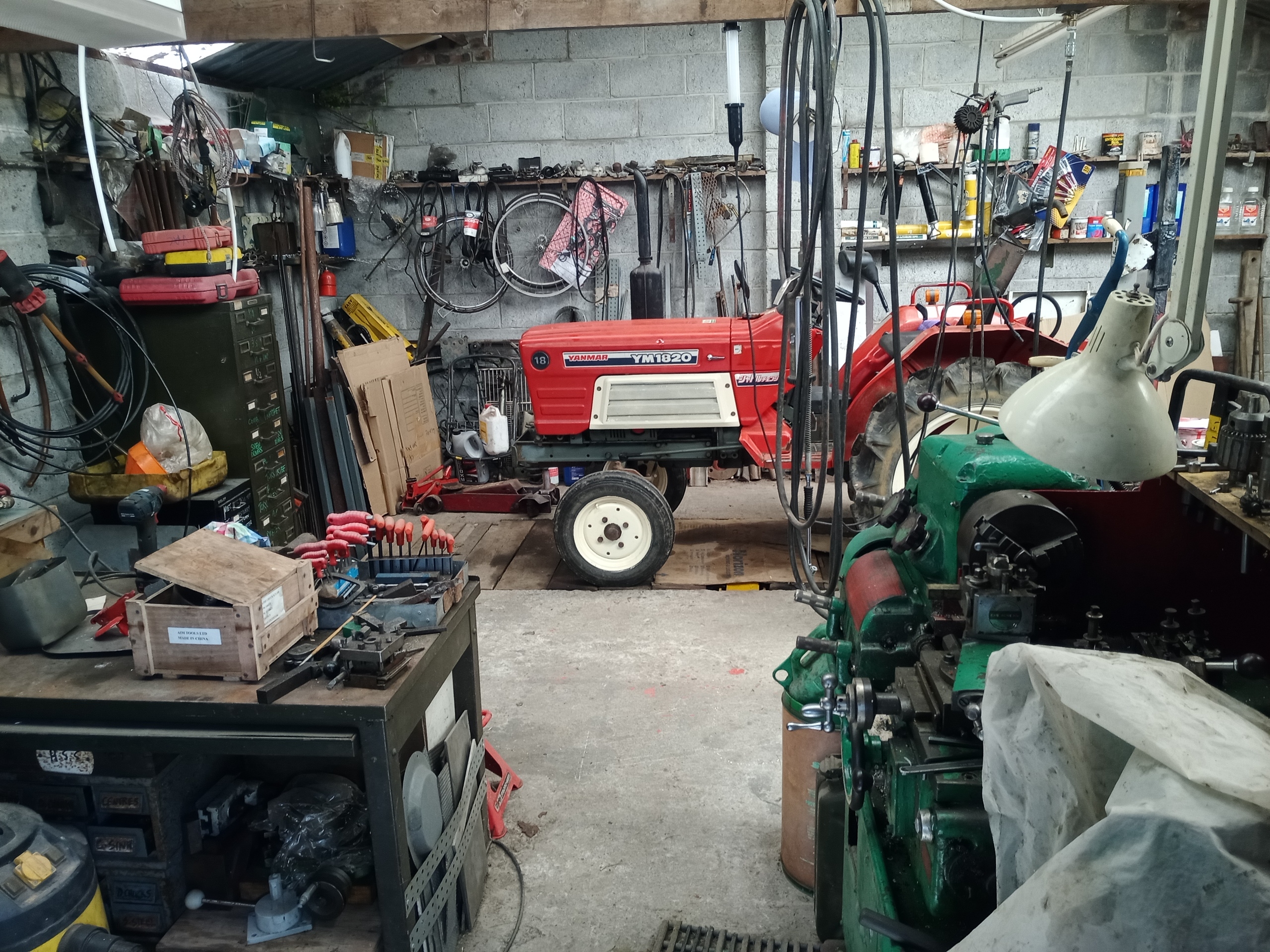

Everybody loves workshop pics so here are a couple of mine.
When I built it 40 odd years ago I never dreamt I'd need to get a 10ft tall tractor or modern pickup inside, so it's a nuisance that I can't. I bet if I'd built it to take a 10ft tractor I'd probably now have a 12ft one anyway:D. Thats the rule with sheds: youcan NEVER EVER build them big enough.
I did build an extension to it last year & moved the milling machine & welders into that which now means I can actually get a car or small tractor into the garage without having to move stuff around.
The metric lathe,( which I don't use much - I cant "think" in metric. e.g. .05 mm means nothing to me whereas I can "see" 2 thou.(y)) is still blocked in with a pallet truck full of old electric motors & stuff I'll take to the scrappy when I get around to it. I prefer to use my Kerry lathe - the controls are ergonomically right for me & everything seems logical with that.
