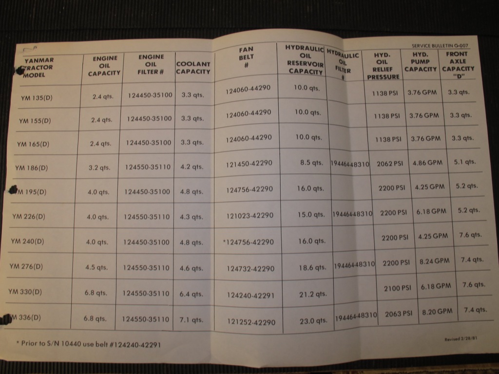

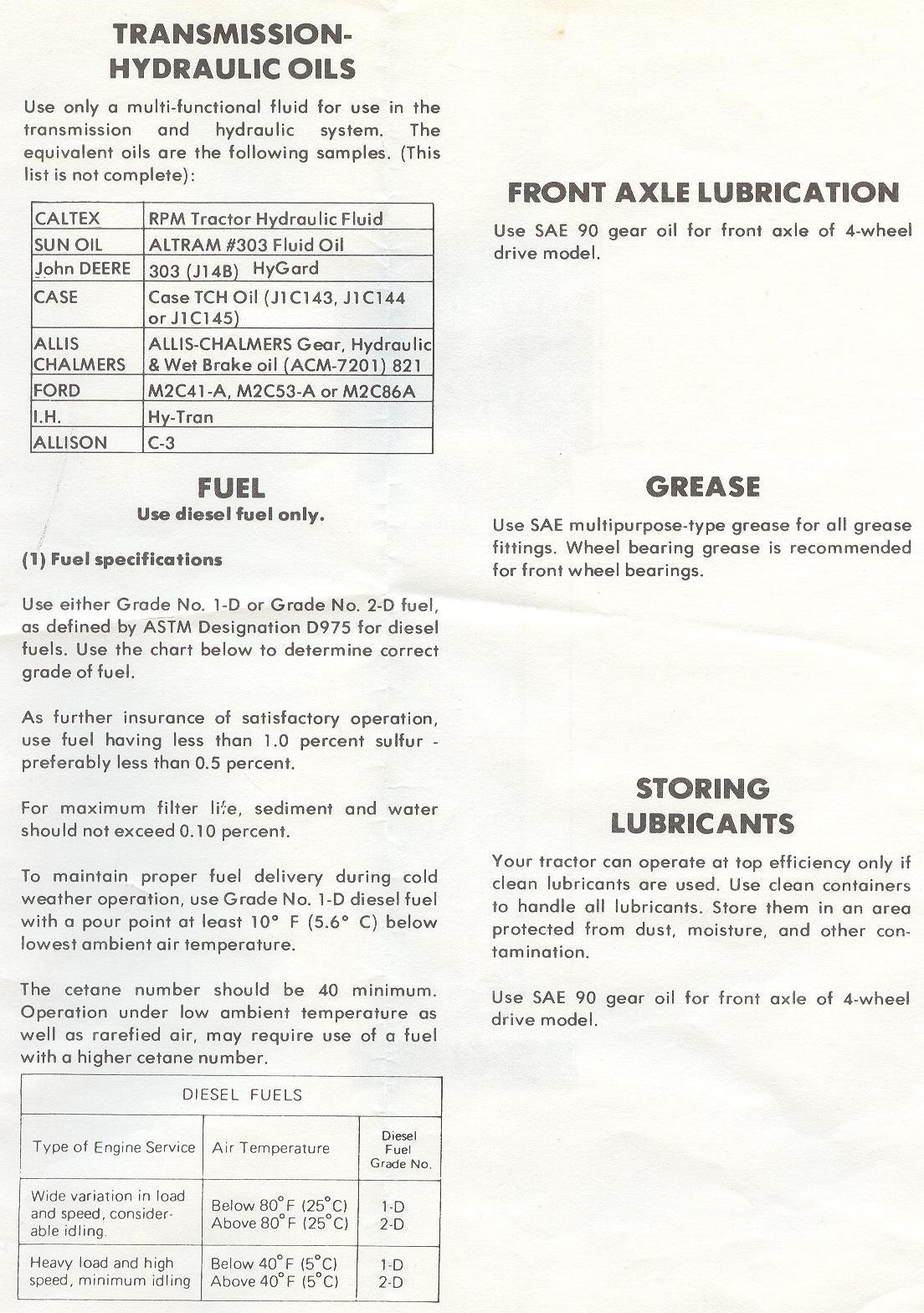

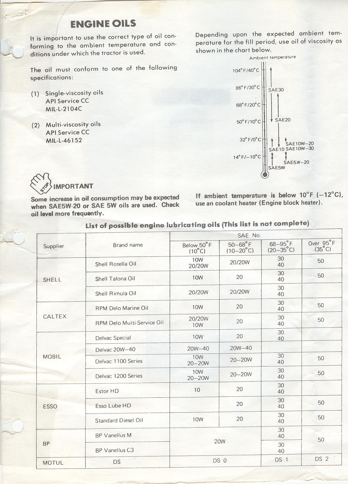

Quarts, or gallons? The slightly larger Yanmars take most of a five gallon pail.
Yikes! Good catch. That's wrong info. I should have said 2.5 gallons (10 quarts). Wonder how/if I can change or edit it??
The actual amount is more like ten quarts. See below.
Thanks,
rScotty
