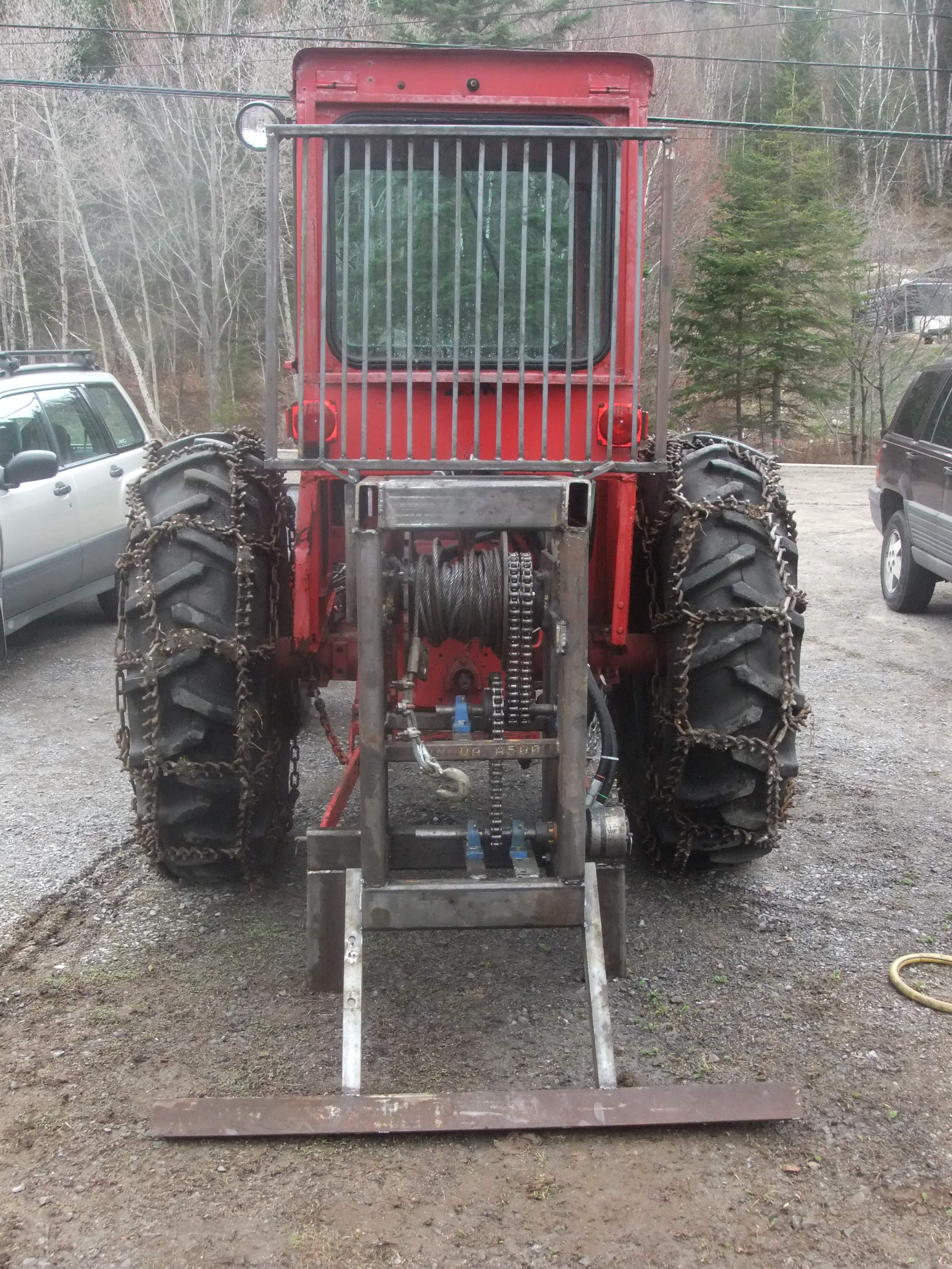

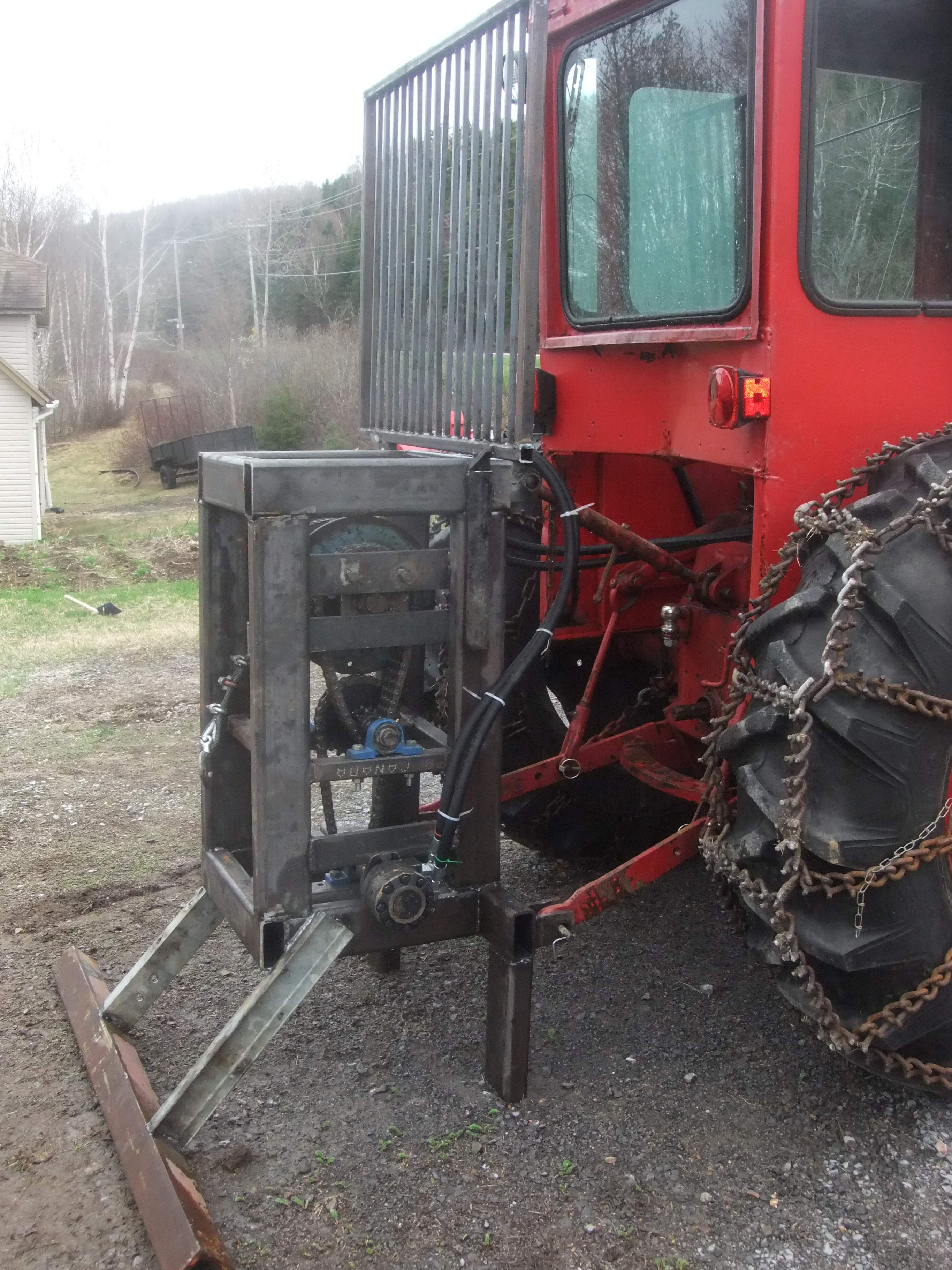

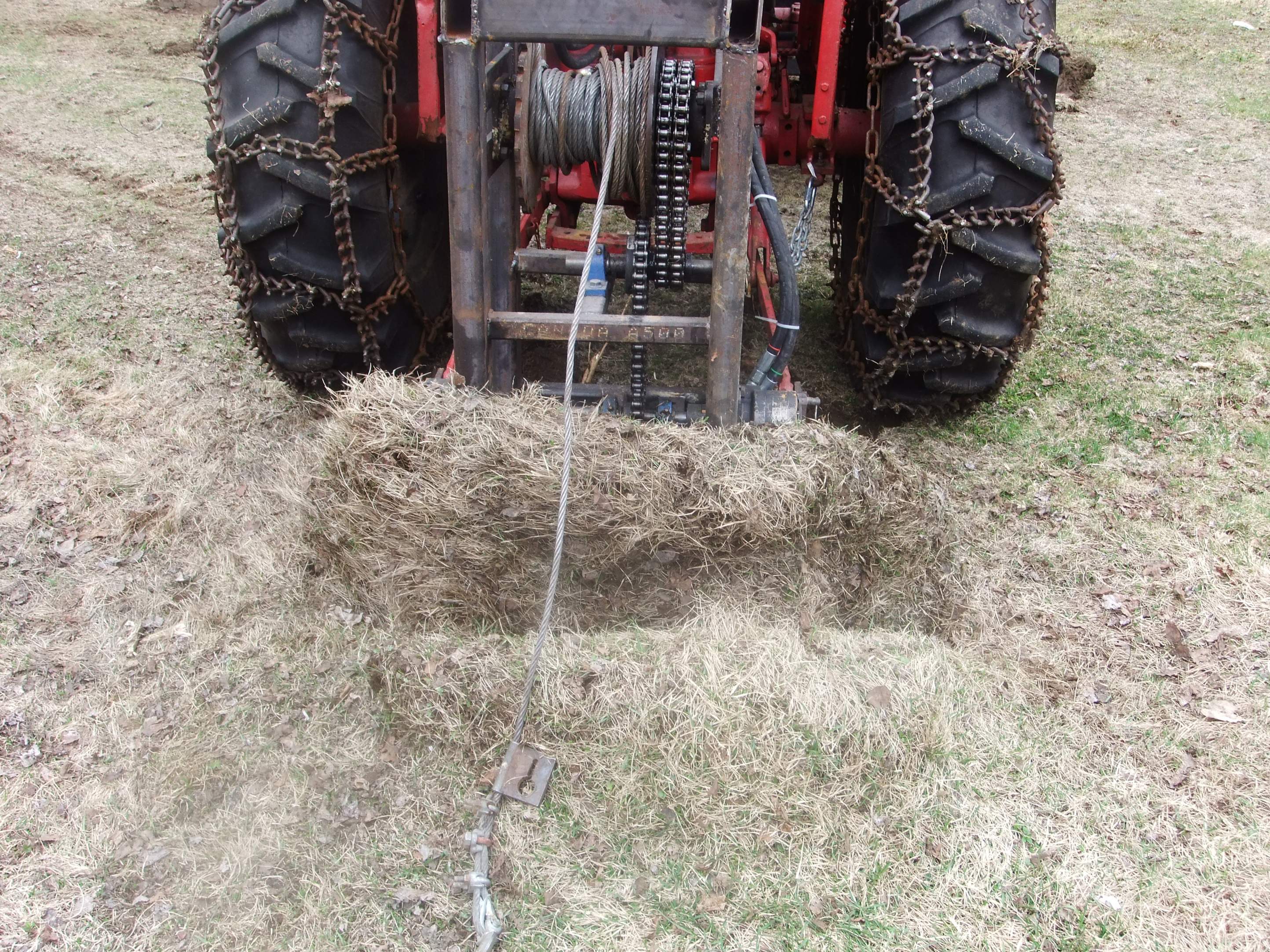

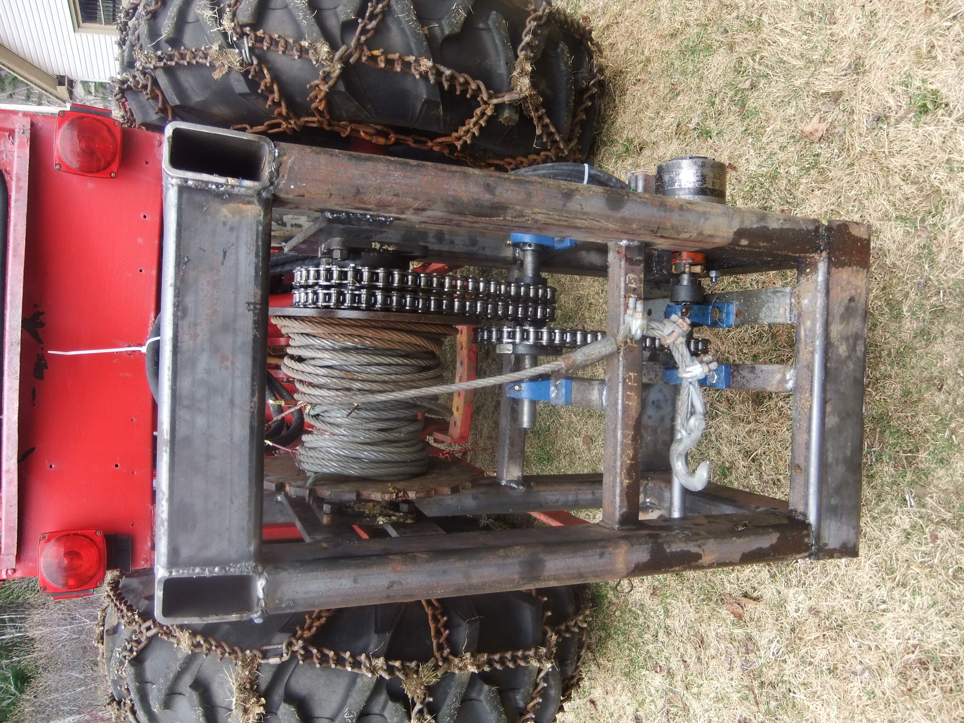

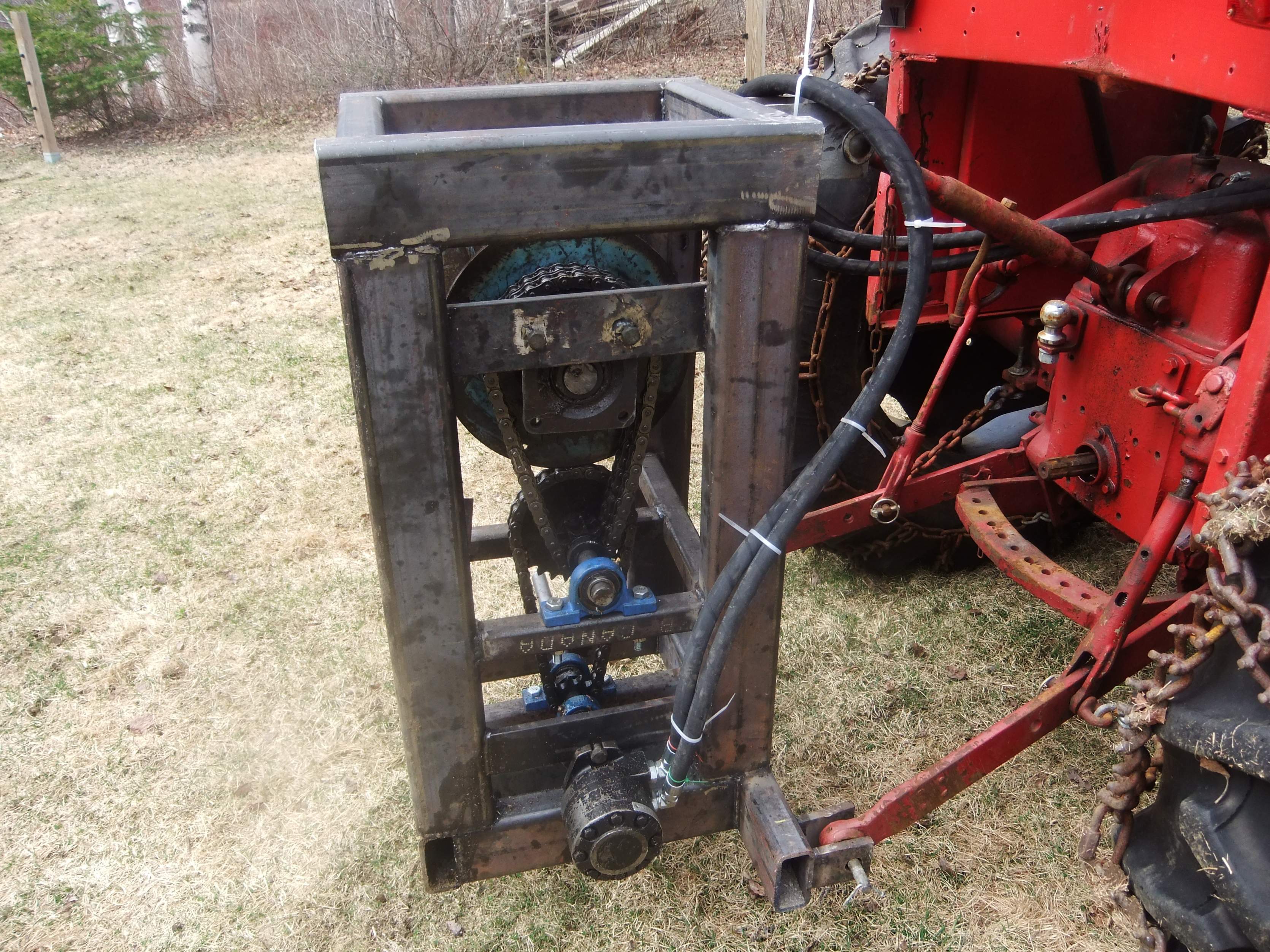

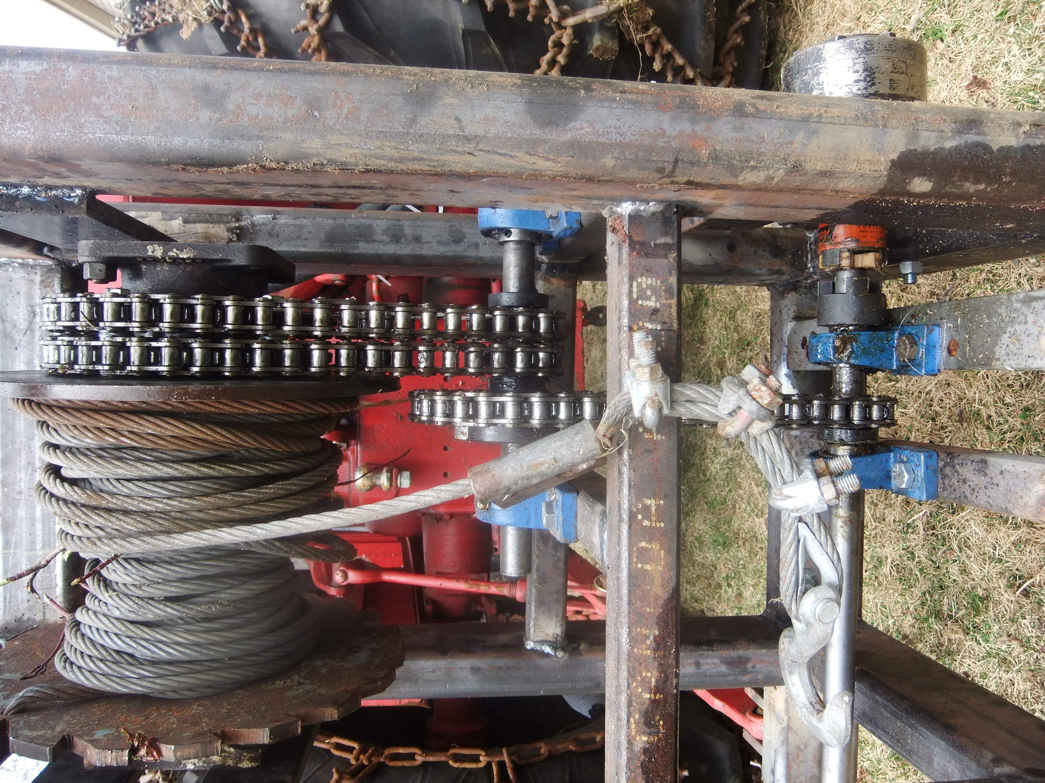

here are my last picture i finished my winch yesterday, i thank Baby Grand for his precious advice, a doubled the last stage transmission as you said:thumbsup:, now i have to add an anchor, pull is too strong, my brake are not good, i added a sliding jaw coupling to be able to unwrap the cable without to reverse the motor rotation, thanks everybody, will be glad to read your comments

Looks great!
Three suggestions:
1) weld up a guard to protect your hyd motor & hoses so they don't get dinged or fouled in roadside brush/stumps/rocks.
2) add two snatch blocks - one at the top cross member and one at the bottom to give yo the ability to pull from the top and the bottom.
3) weld a plate onto the the bottom crossmember and brace it with gussets to make a blade so it bites into the soil when you pull hard with it. Should work better than the brakes.
-Jim

hi baby grand, i have done what you suggest, obviously the blade anchor is strong than the brakes itself, will post the final picture tomorrow, thanks everybody, also i will give you the exact cable speed later
/ HYDRAULIC LOGGING WINCH #31
Can't wait to see pictures of your finished build & get a report on it's performance. You may want to think about adding some sort of recoil fence to your ROPS - I have been thinking about using a section of huricane fence secured with heavy duty tie straps - just in case a cable or hook lets go while you are operating the winch from the seat.

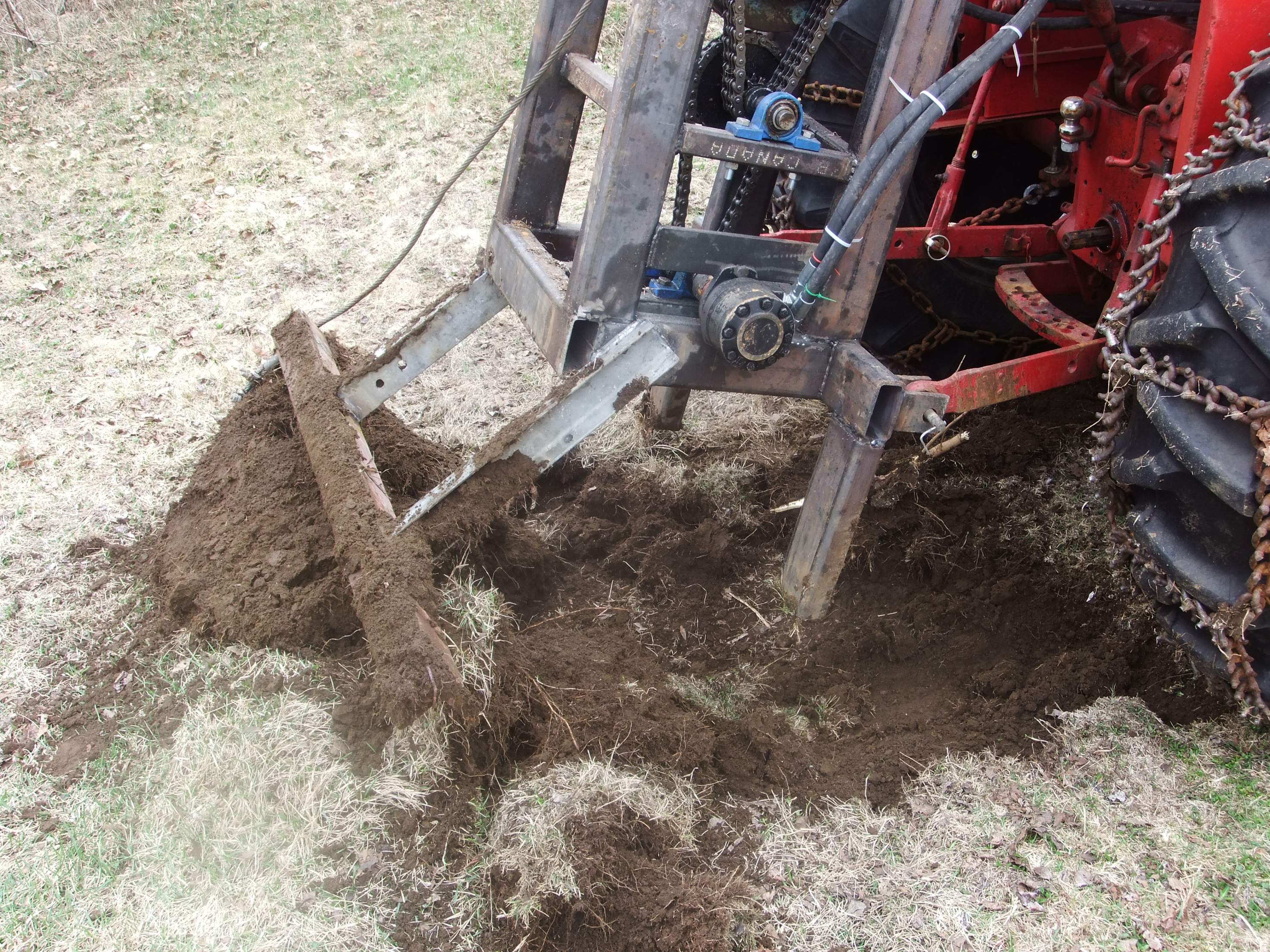

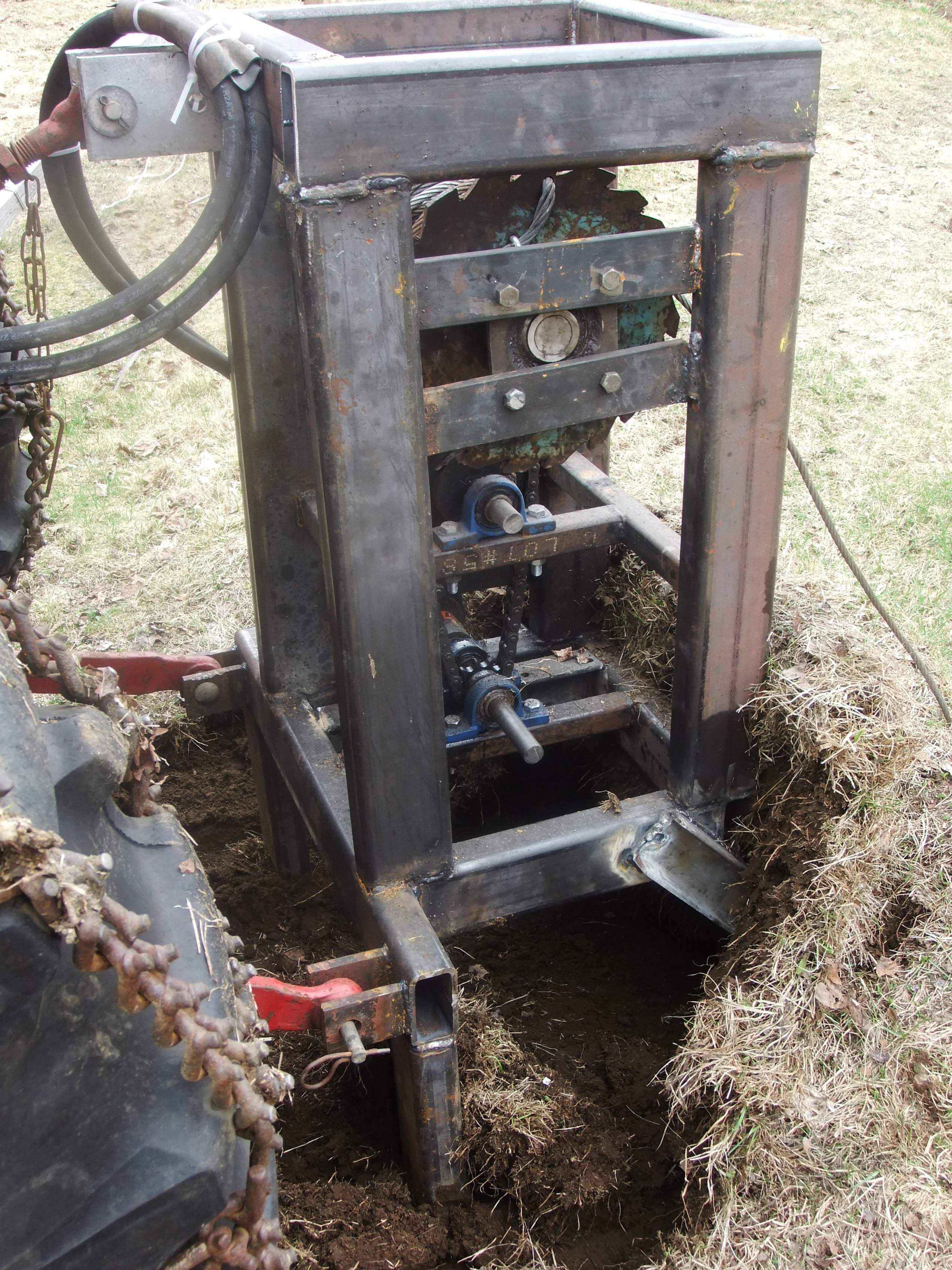

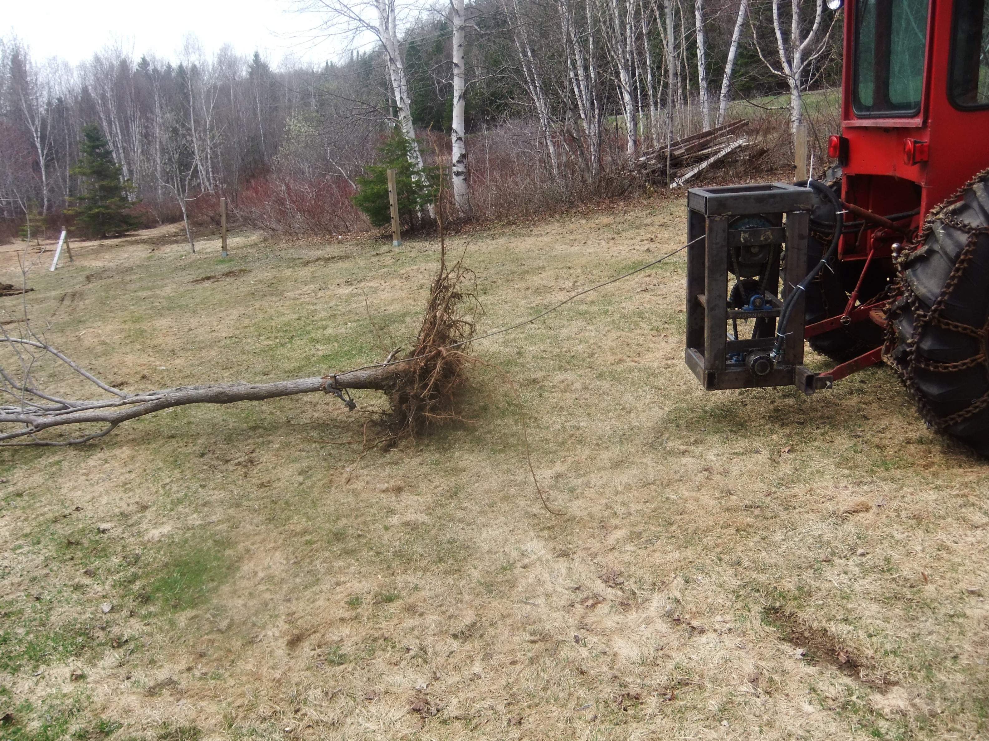

today i welded a removable fence to protect myself in case somethings go wrong , i tried my blade, it slices the grass and goes deep in soil about 10 inch, when i pulled a 40 feet tree from a 30 degrees down slope, speed is about 20feet/min at idle speed, 30feet/min at 25 percent acceleration, one thing i am sure about is its very powerful winch, the hydraulic motor is a parker 110A series 7.1cinch/rev. low speed high torque, will post a video later, now i need to install a roller winch front of the drum to avoid scraping my cable on sharp drum sides when the pull direction is not straight the drum, i apologize for my poor English it's not my usual language
thanks everybody have a nice week-end

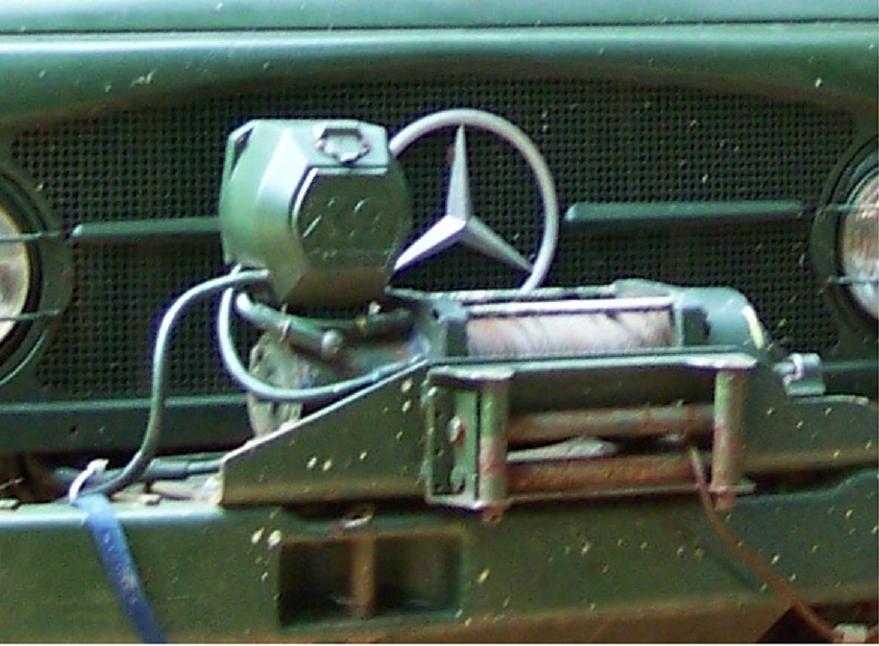

Milemarker winches are for vehicle recovery. He would have done a lot better to have his tractor closer to the tree were he would have more cable wraps, and thus more speed. He is like me, playing and trying to convince the wife he is working.

I made this homemade fairlead when I had the MOG. Start with piece of C channel, grind it to shape, weld in a couple of pieces of angle for the perpendicular rollers. I used steel rod with a outer sleeve. Worked for 8 years.

Congratulations! That's some very nice work! I would only offer one suggestion that you try to place your rollers to bring the pulling force down nearer to the height of the lower 3 point arms and away from the top link. It looks to me like your winch will place much of the pulling load on the top link and the top of the tractor differential. While your tractor looks very strong, it would probably be better if the load went more to the lower arms.
Maybe someone with more experience than me will correct me about that, but that would be my only concern. But, again, that is a fine project and I'm sure it will do lots of work for you.

I don't have any experience at all, but I agree. You can add 2 snatch block attachment points for fairly cheap, 1 at the top crossmember and 1 at the bottom crossmember. Use the bottom one for any pull where you're at risk tipping the tractor and the top one for skidding, to get the butts up off the ground.
-Jim

Interesting. Nice build. You may want to add something to stop the "blade" from digging all the way to China. A couple arms sticking out (braced) should limit how deep it goes.
