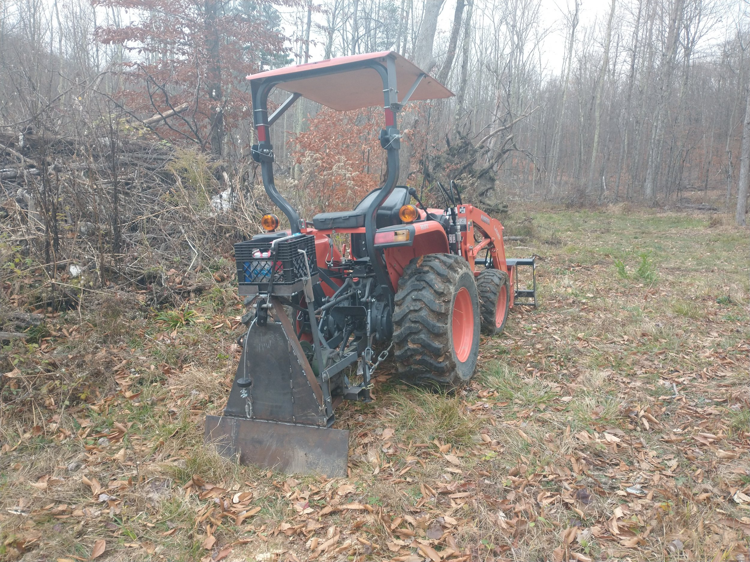

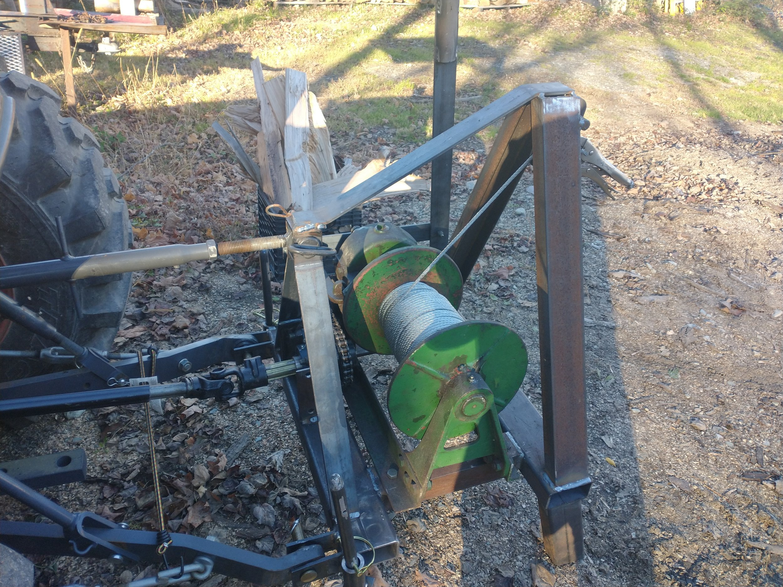

I picked up a Braden style winch last year and finally got around to putting it to use.
It's worm gear drive, was driven by a hydraulic motor but that was seized up so I scrapped it and decided to run it directly from the PTO
The winch and the pump both had 15 tooth sprockets, I used a 25 tooth sprocket on the PTO shaft to gear it up a bit which overall I'm happy with it.
First a word of caution! If you go this route know that (at least with this style winch) you cannot kick it out of gear under load so I have to use my clutch on the tractor to disengage the load where I want it. It's very powerful, I have only run the tractor at an idle thus far.
I used a PTO shaft extension that was supposed to be 1 3/8" diameter, I had to grind it down a bit to fit into the 1 3/8" bearings that I bought. I bought a weld on hub for the sprocket . The steel bits are stuff I had laying around. It still needs some finishing touches but so far I like it. I want to weld on another hook to the frame and get three sliders for the cable and I have to get some new chokers.
I'm very pleased with the milk crate to carry gas, oil, chains, water and chainsaw. I still want to build a saw-haul type carrier.
Let me know if you want any specific info.

It turns out that I've just posted conflicting posts in a couple of other threads about your build. Now I have to say: Nicely done!!!
It looks like your gearing has addressed my comment about winch speed. I do hope that you find a way to integrate a clutch onto the system, but that's just because I'm accustomed to one way of doing things.

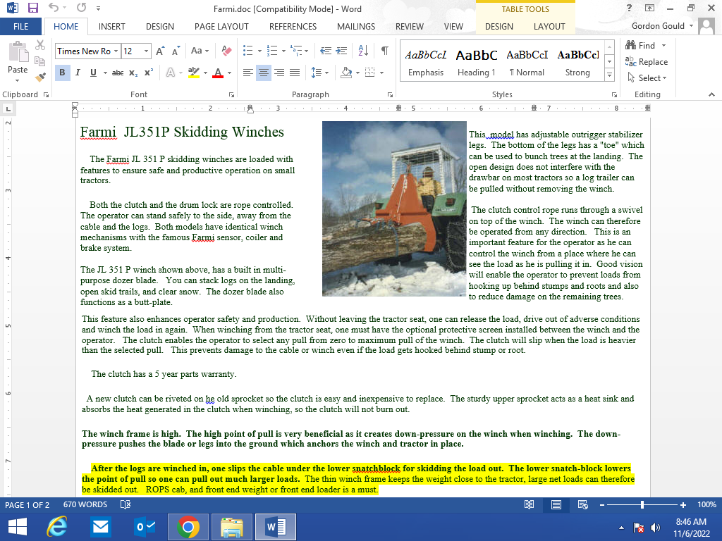

Skidding logs with the winch itself, depends on the winch.
Mine had a positive locking brake that's separate from the clutch and there's no problem skidding on the wire rope. Mine has a heavy wire rope; in fact, it still has the original cable on it that's still in decent shape and I've done a lot of skidding.
I do think it's a poor idea to skid logs with a worm drive winch, using the worm for the brake.

SR is right it depends on the winch. But you are right too. Many specifically say "don't skid on the cable - use the slots above the butt plate". But on some larger winches skidding on the cable is perfectly acceptable as seen here in the highlighted area:

After using it for a few days I am impressed. One thing I noticed is I am winching in much larger loads than I ever did with my clutch driven homemade winch some of you may remember. I find that at an idle it works just fine. I did add a plate/blade on the bottom and some 11 gauge steel up the A frame along with a place to hold a milk crate for gas, oil, chains and chainsaw. I still want to build a saw-haul type holder for the saw on the loader arm.
What do you think about adding the safety mesh between the ROPS? I could make it bolt in with some U bolts.

Does the winch drag the tractor around any? This may be something I would build in the future.
/ Logging winch build #16
If you leave the bit of the blade on the bottom of the winch dig into the ground, that goes a long way toward keeping the tractor in one place. On commercially made units, the bottom range is usually angled roughly 45 degree rearward (rather than pointing straight down). This helps it to dig in if the tractor starts getting dragged.
#17
It certainly can if you are not careful. The blade does angle back some, just use your head and don't bite off more than you can chew!
