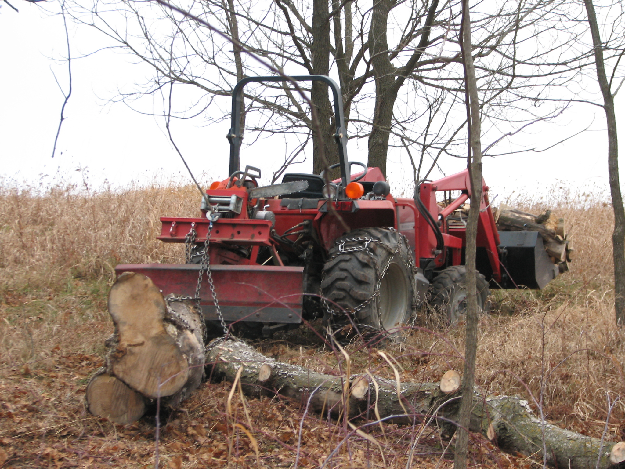

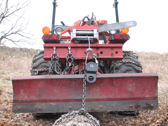

Just pulled the trigger on a new Massey 1840M. I want to rebuild my homemade 3 point winch and go from DC electric to a hydraulic winch. This new tractor is rated at 12.6 GPM flow. I have looked hard for years at the Farmi style tractor logging winches. But I am leaning more towards my own set up. Can anyone recommend a winch? Where can I go for how to's on how to hook up the hydraulics. I am having the dealer install separate rear remotes with a valve. I already have my winch frame, a modified blade that the new winch can bolt right on, just need to know what winch, and more info on how the hydraulics work and are hooked up. Thanks!

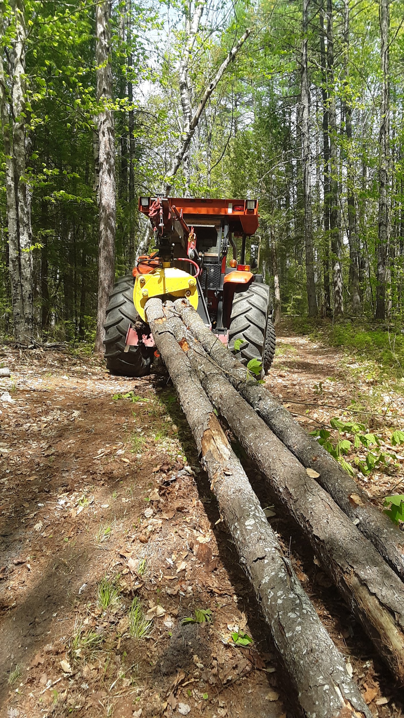

I use a Ramsey hydraulic winch (planetary) for skidding, it's a 8000# and it does a great job for me. It simply plugs into a pair of rear remotes and for more pulling, the tractor is at an idle.
I'll see if I can find a link.

I chose a 6" wide drum for better cable spooling although that limits the cable to around 90' (3/8 cable)
Thanks for all the info everyone!. The Ramsey looks like what I am looking for. Do you use a spring loaded tensioner to help spool? Do the hydraulics just plug directly into my remotes right from the winch, the controls are already on the winch? Does it matter in or out? I see they have a longer drum for that model that holds 140 feet of cable, that might work good. What about speed? My current eclectic is S L O W and wears down my battery even with the engine reved up, winch gets hot, stalls, smokes, then I have to stop winching, wait for battery to power back up from the alternator, wait for the winch to cool down, etc.... I pull some huge hardwood heavy green trees sometimes. I know the forestry winches are FAST, but $$, having a hard time deciding. I found a Runva 10,000 # hydraulic winch with 60' of cable for $900??

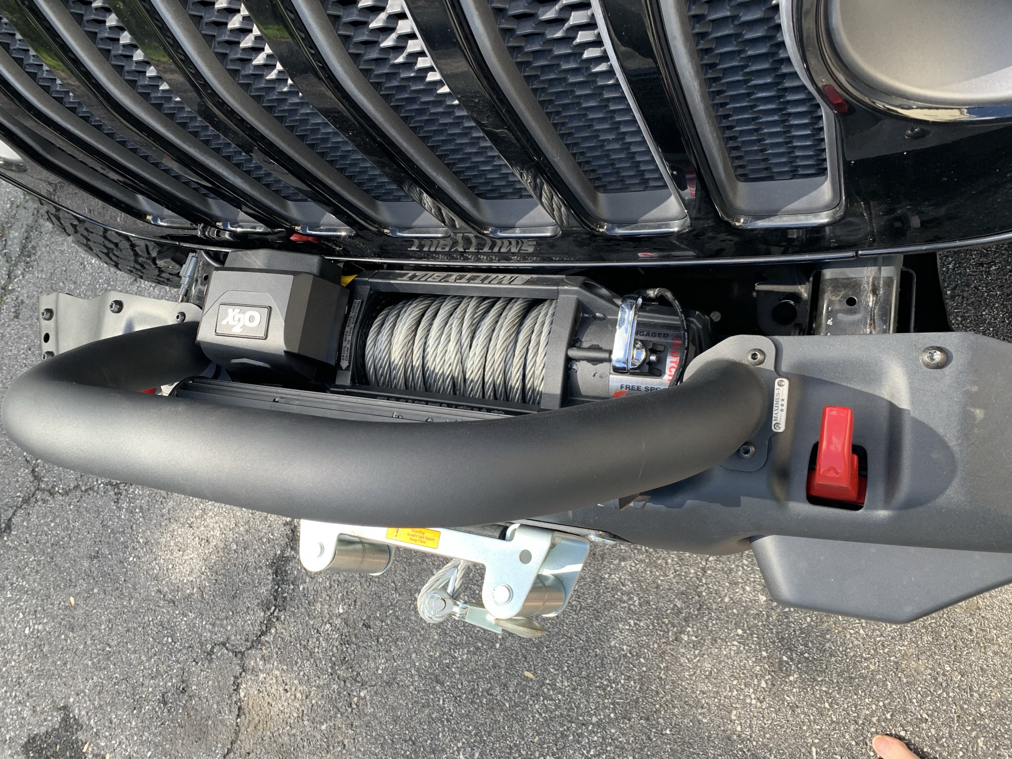

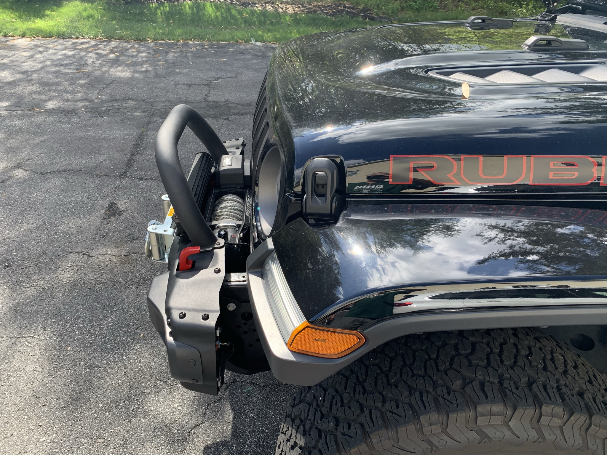

Just installed a 9500lb on my Rubicon

Yes, the "plumbing" is very simple. You simply connect a pair of outlets on your tractor to the winches 2 ports. No hoses included. The speed is fine for me and faster than an electric not to mention 100% duty cycle, I mostly have the tractor idling and only rev it up if needed for power. If someone was used to a 3pt winch with their several feet+ per second line speed, they'd be disappointed.
I chose the short spool for "tidy" cable management, and at 90', it's regularly un spooled about 50% . Where you run into trouble is pulling hard over wire that's not tight. Only once have I had to pull out the cable past a jam, and it was only about a half turn of the spool. In my woods, 90' is all I care to guide through the stumps and boulders with an assortment of snatch blocks. I've got "easier fruit to pick" and no big ravines or steep ground requiring a longer reach.
My purpose is mostly firewood thinning and I'll winch several stems to the tractor then grab them with the grapple. 👍
