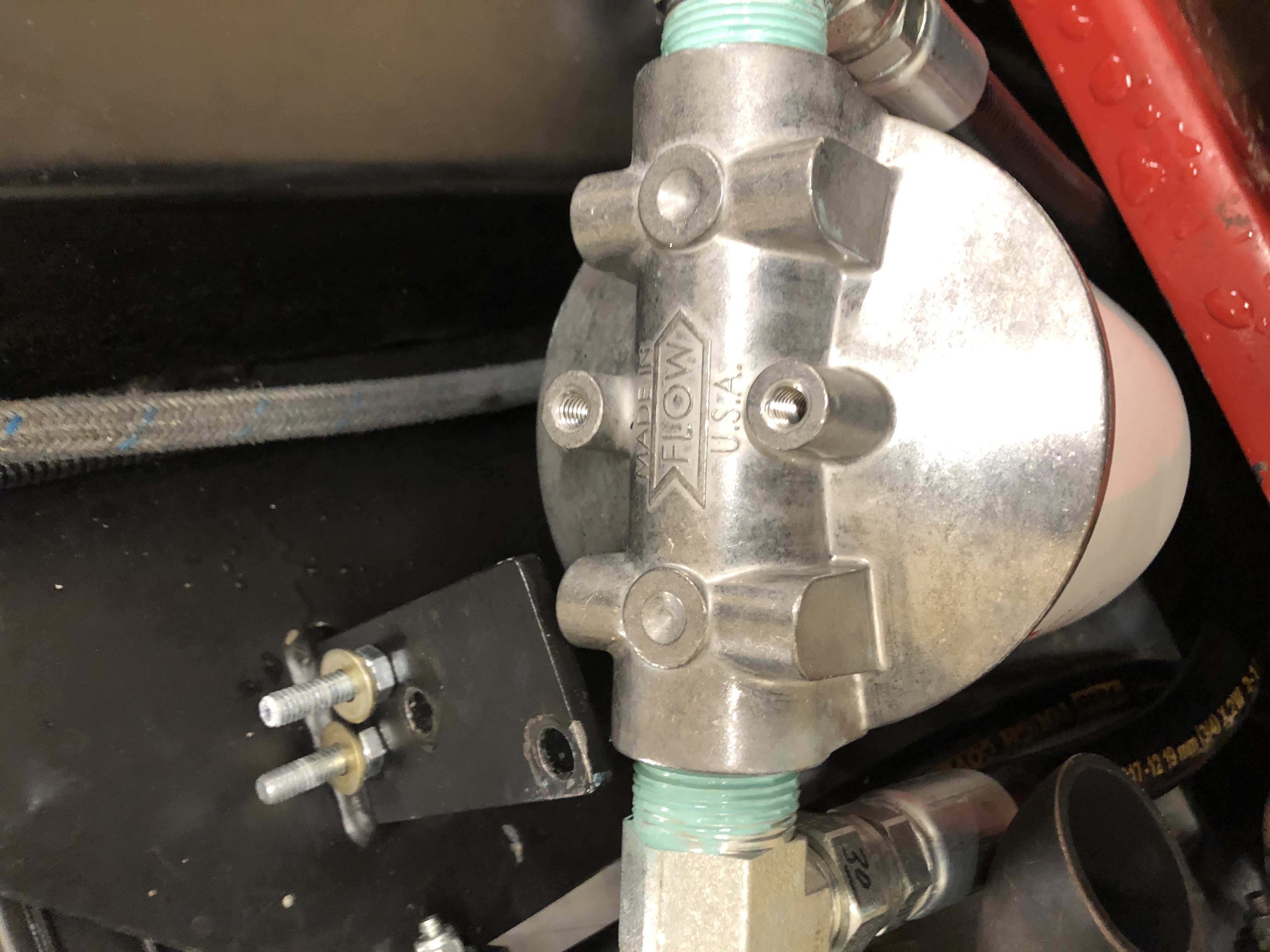

Here is a picture of the new housing for the hydraulic filter. This one doesn't have that cheesy white metal look like the other did, and it also says "Made in the USA." :thumbs:

After getting it as tight as I could by hand, I turned it half a turn with the filter wrench. It's on pretty tight. I'll say one thing, the little clip that Power Trac welded on for attaching the hydraulic filter housing is a good, deep penetration weld. That vertical plate that it's welded to has even bent some from torquing, and the paint around some of the weld chipped off from allot of strain being put on the welds.
Thanks for the info about making sure the filter is tight.
