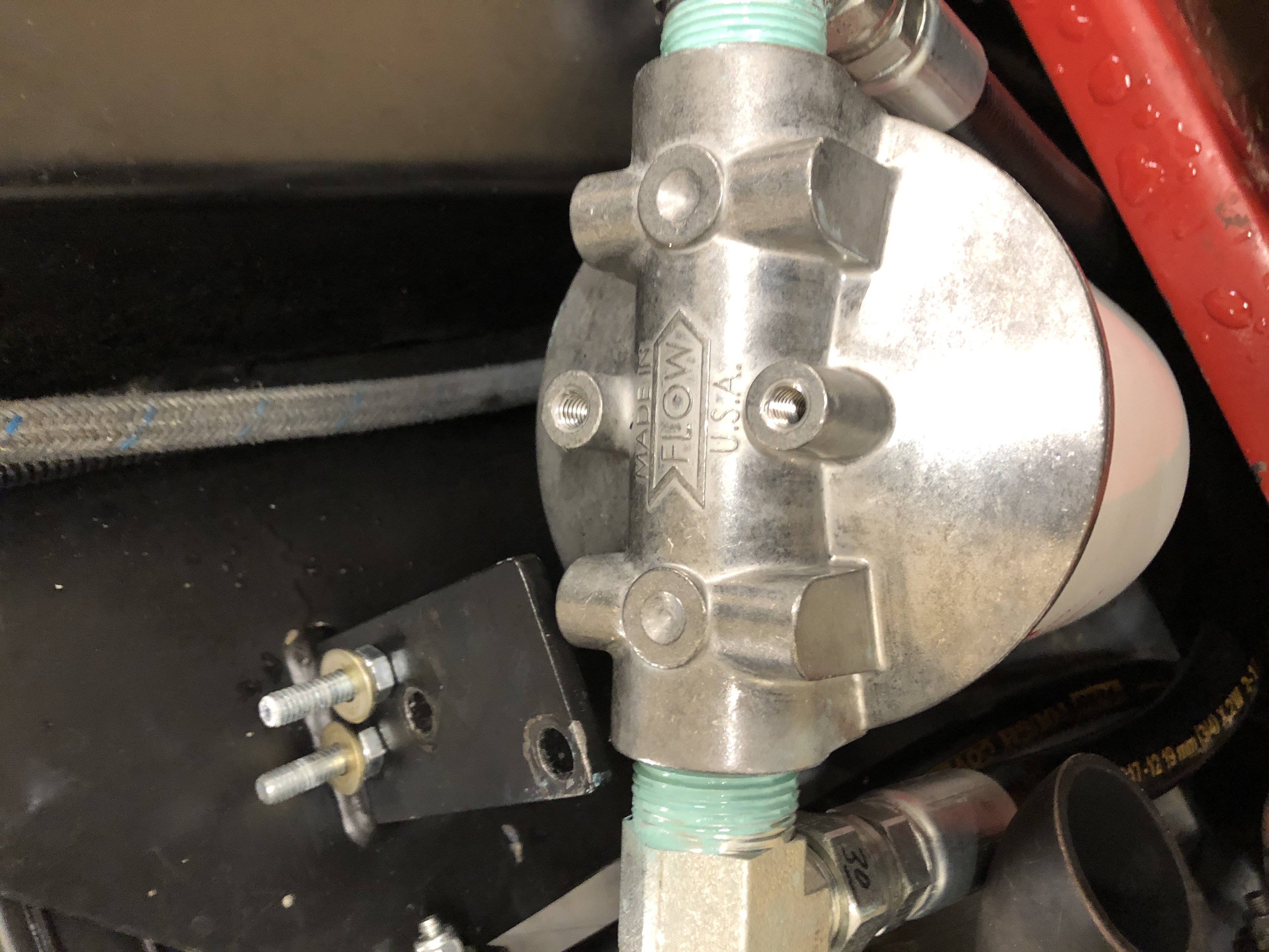

Here is a picture of the new housing for the hydraulic filter. This one doesn't have that cheesy white metal look like the other did, and it also says "Made in the USA." :thumbs:

You are lucky this popped up. Air introduction on the suction side is very bad news, longer term, for the pump. Terry once told me to ensure my filter is VERY tight on installaiton. This isn't like a car filter...where you get it firmly tight with your hand and it will tighten up in use (or that's what people say). This filter must be TIGHT. Air can easily get into the system and you'll never know. They use a special filter wrench from gearwrench if I remember correctly. I've posted the model number before.
After getting it as tight as I could by hand, I turned it half a turn with the filter wrench. It's on pretty tight. I'll say one thing, the little clip that Power Trac welded on for attaching the hydraulic filter housing is a good, deep penetration weld. That vertical plate that it's welded to has even bent some from torquing, and the paint around some of the weld chipped off from allot of strain being put on the welds.
Thanks for the info about making sure the filter is tight.

Joshlee: I like that new filter bracket! Looks solid. The original wasn't exactly a high quality casting. I hope that this lasts you a good long time.
