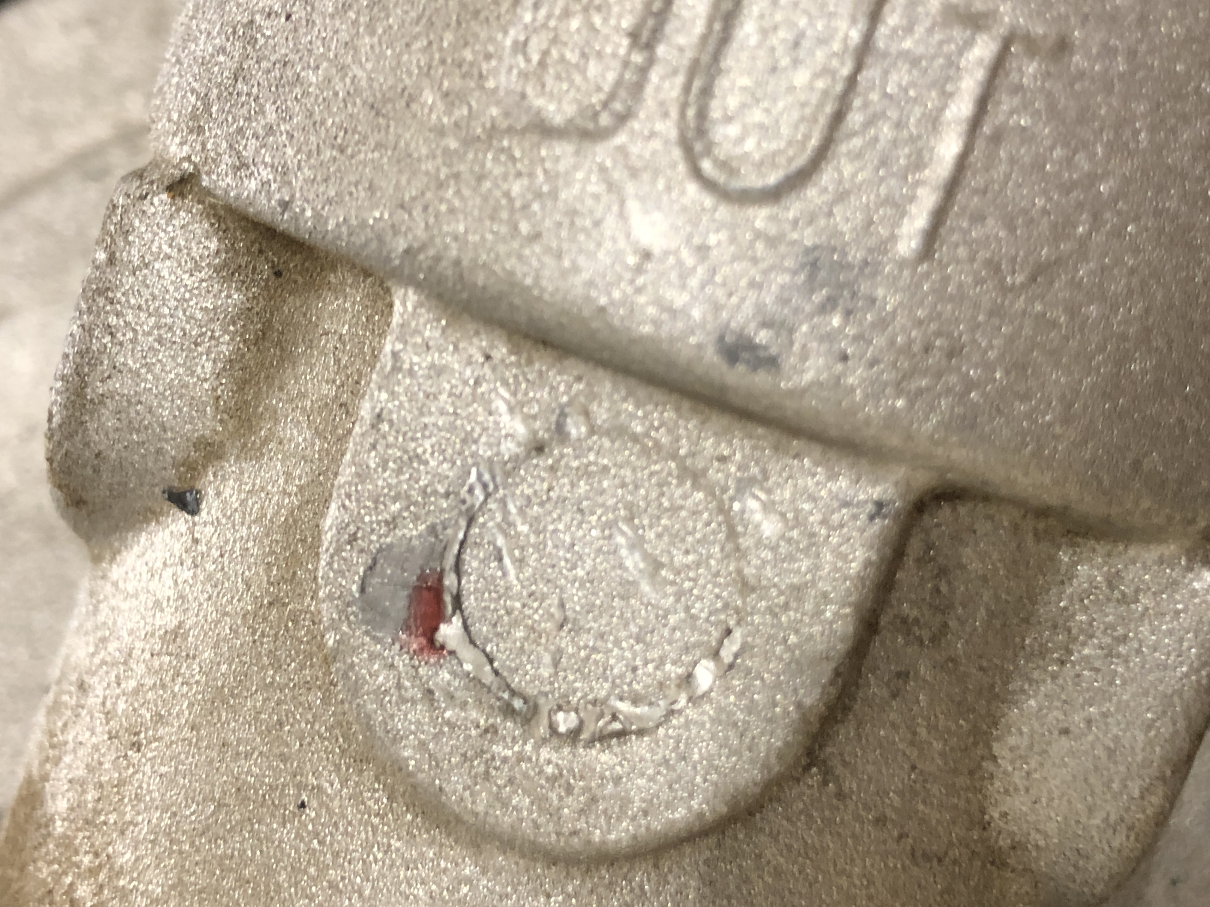

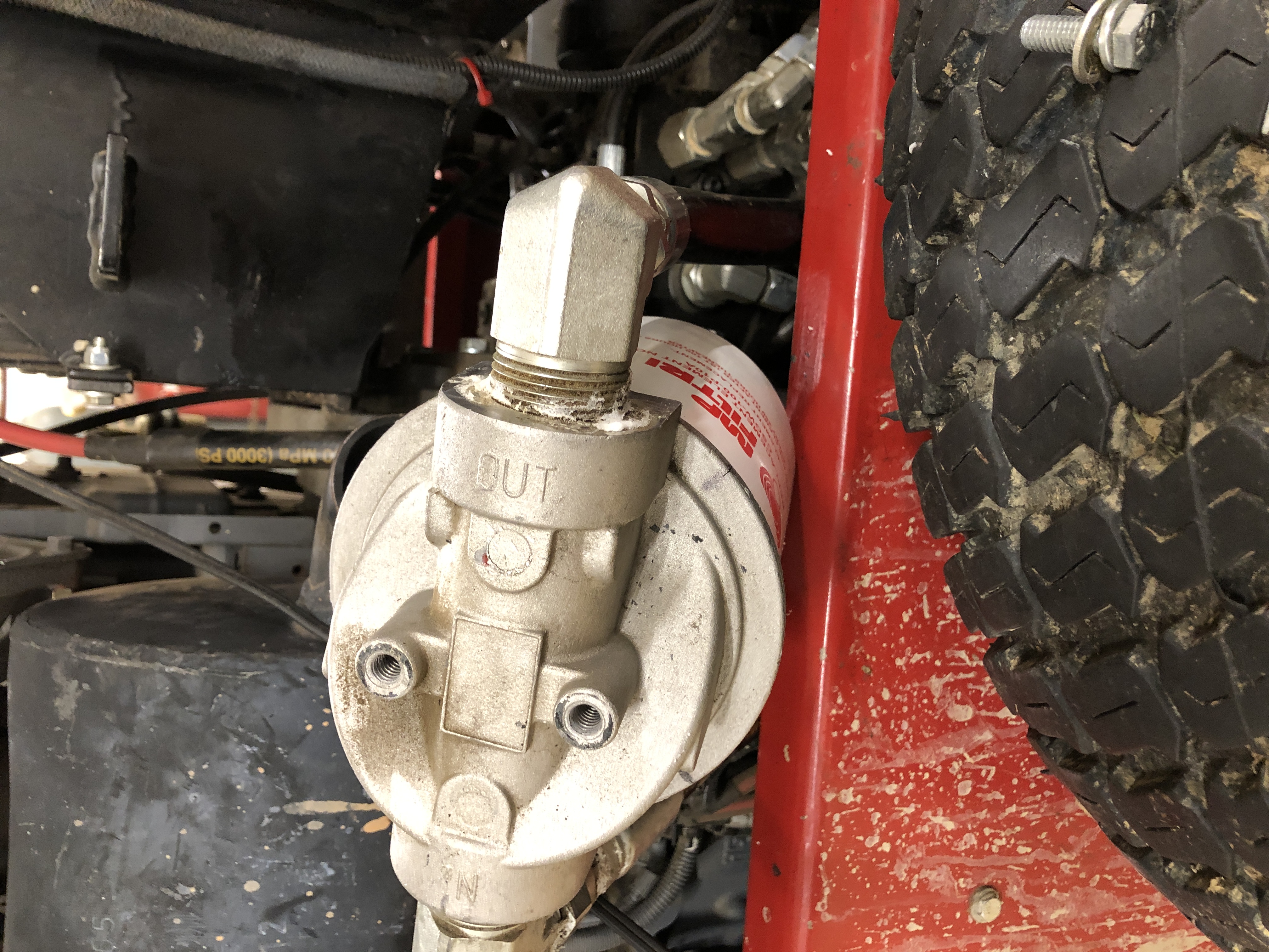

Here is a picture where the crack is. You can the litte red dot of Permatex Thread Locker.
View attachment 678352View attachment 678353

Wow! Great catch on that hairline crack. (Great photos, too!) That looks like bad luck more than anything to me. It is hard for me to imagine how large torques on the filter would cause failures there.

Yeah, I know the battery cable your talking about. I noticed early on how it shook around allot, so I attached it to the hydraulic hose that goes to the the filter housing, which is right beside it. The other hose that I wire tied was the fuel hose with the gray braided cloth. It was actually bouncing around right at the tip of the engine mount bolt, in which over a few years of that it wore some of that cloth braiding off. So, I'm glad I caught that! The wire that goes to the right head light, which runs through the back/top of the FEL Control Valve I gave yet found a good way of protecting that wire. The wire gets touched/moved by the wobble assembly right at the top of the control valve. I'm not sure what went wrong with the picture. Here, I'll try it again.
View attachment 678446View attachment 678447
Pics came out good this time. That looks to me like a porous casting. I don't see any way that area is under stress.

Yeah, I know what you guys are saying about it being a casting issue. The defect was always there, but I just think that I opened things up more for it to leak by over stressing it. I'll never know for sure, but yeah, stuff like that shouldn't leave a factory. I come to find out that cracks usually grow in size.
