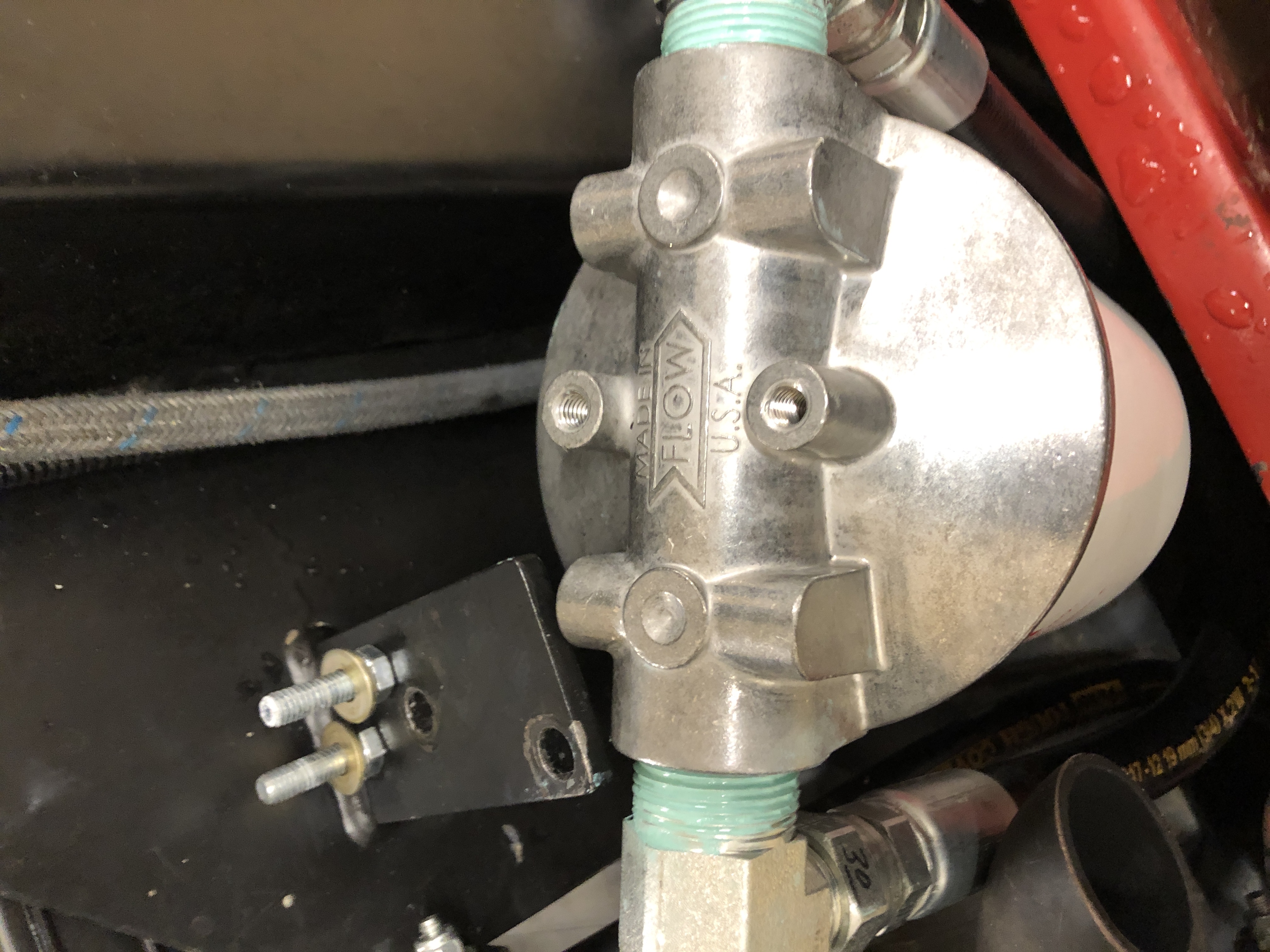

Joshlee: I like that new filter bracket! Looks solid. The original wasn't exactly a high quality casting. I hope that this lasts you a good long time.

Great info! My feeling of dread is decreasing.
FYI, I noticed they also have a wider version of this filter wrench if you check under the similar listings. I bought that one. Hopefully it will reduce the crushing effect you all are talking about.
It looks like that wide one might work better than the one I have. Where do you guys grip the oil filter? Is there a place where its less likely to crush?
/ Hydraulic Filter Change Problem #54
To avoid denting the filter, I apply force either by the top rim (my first choice) or by the opposite end seems to work best for me.

That痴 what I found out too. For a long time I was gripping the upper part, but here just recently found that the bottom seems to work better for me.

Just curious, couldn’t the filter and mount be mounted in a more accessible area, i think i would do this to make it easier to service seeing how it has to be so often.....
/ Hydraulic Filter Change Problem #60
Of course! You just want to keep the hoses short, and if the hoses lengthen, you might need to up size them to keep resistance to a minimum.
Personally, I don't might popping the hood frequently, but everybody is different. It helps me keep an eye on oil or fuel leaks or weeps, and how dusty everything is.
