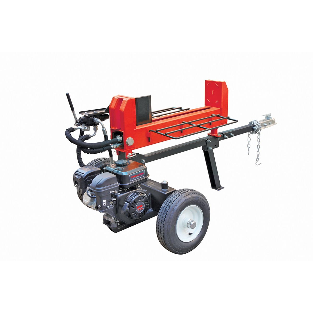

I have thought about doing something using my splitter. High pressure pushing the chips thru and extruder tube. Actually, I think a sq hay bailer setup would probably give the best bang for the buck. Instead of the bailer compacting a large bale of hay, fit a extruder to it and let the bailer bang the saw dust thru it. I guess the only reason I havent treid using my splitter for a press is simply because i dont have enough sawdust to make it worth while.

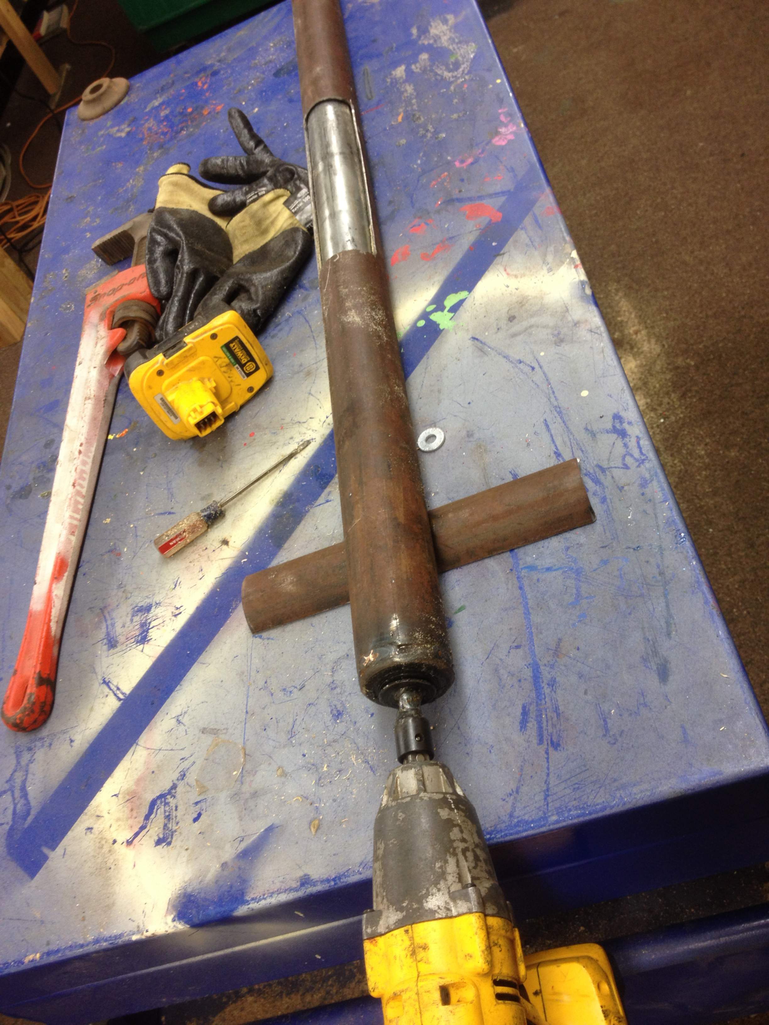

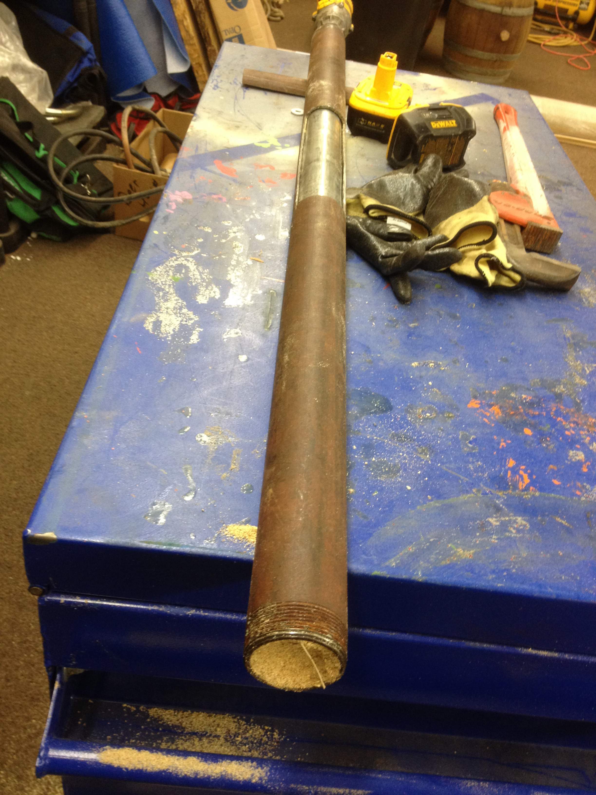

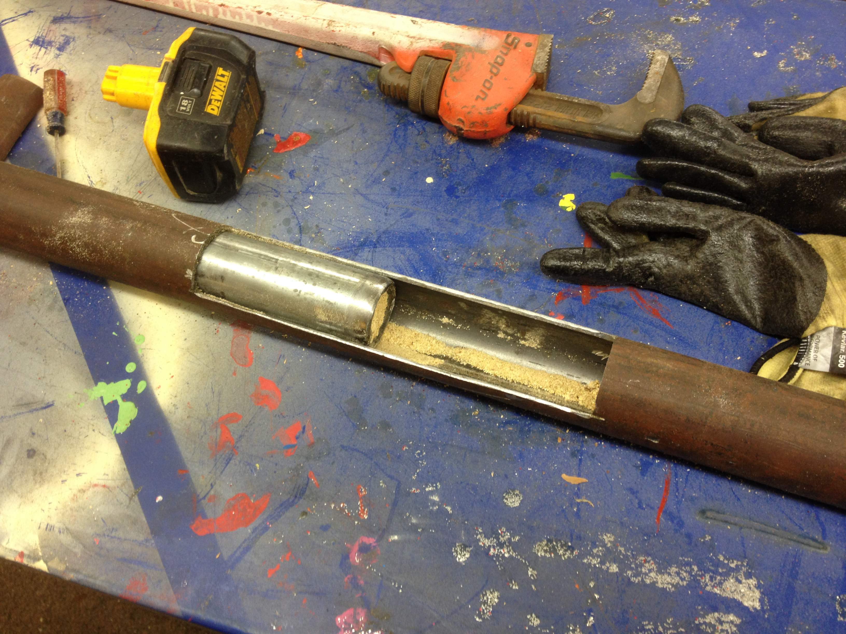

Well I had an idea to test some sawdust pressing with a damaged trailer jack laying in the junk pile (where I go for inspiration). IT was bent but I was able to salvage the guts out of it including the all thread. I tossed the housing and replaced it with a 4 ft piece of pipe with a threaded end and a 2"x1-1/4" reducer. Then cut a slot to add sawdust. I welded a 1/2" square female adapter to the end so I could operate it with an impact wrench. IT did press the sawdust but was not able to push it out with the reducer. Without the reducer it could barely push it out the end and the vibration from the impact wrench caused it to crumble as it exited. It was amazing to see how much sawdust it took to fill the pipe when it was compacted. Probably around 3 gallons of sawdust. What I gathered from the test was that more pressure and likely some heat will be needed to get the wood to bond properly and that a reducer may not be necessary at the end to further compress the biomass as long as the compression tube is long enough. I was amazed by how much resistance you could build with nothing on the end of the pipe. That was the biggest surprise. Adjusting the length of the exit tube is probably important for finding that sweet spot for resistance.
Looks like a fun project. Thanks for posting it.
Formula for axial force from a screw vs torque are readily available. It's been years but I think the force level hits a wall at some point and then extra torque just gets eaten up in screw friction.
I made a prototype surgical intrument once to jackhammer away bone cement when revising joint replacements. Mounted it my bridgeport mill, clamped some bone cement slugs in the vise and it drove shards of cement for 5 feet. My Dr partner was pretty excited.
Surgery was another matter. The setup wasn't rigid like the bench test and between the low instrument mass and the "give" of the patient, most of the impact was absorbed elsewhere.
Long way of saying that the sawdust might be absorbing the blows from the impact wrench.

if you are still intending to use a log splitter there are people that have done it. In order to get enough pressure for the lignin bond the briquette together you need to think smaller diameter.
I recommend that you to check this out:Alois's wood briquette press
