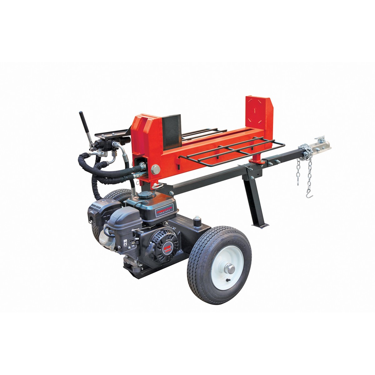

I am envisioning something based on a HF log splitter. Basically looking for ideas on what might work best for a die set or other ideas on how to do this. Maybe press in both directions. Finding a heavy wall pipe like the dies they use might be tough but I can possibly encase pipe in concrete to give it extra strength.

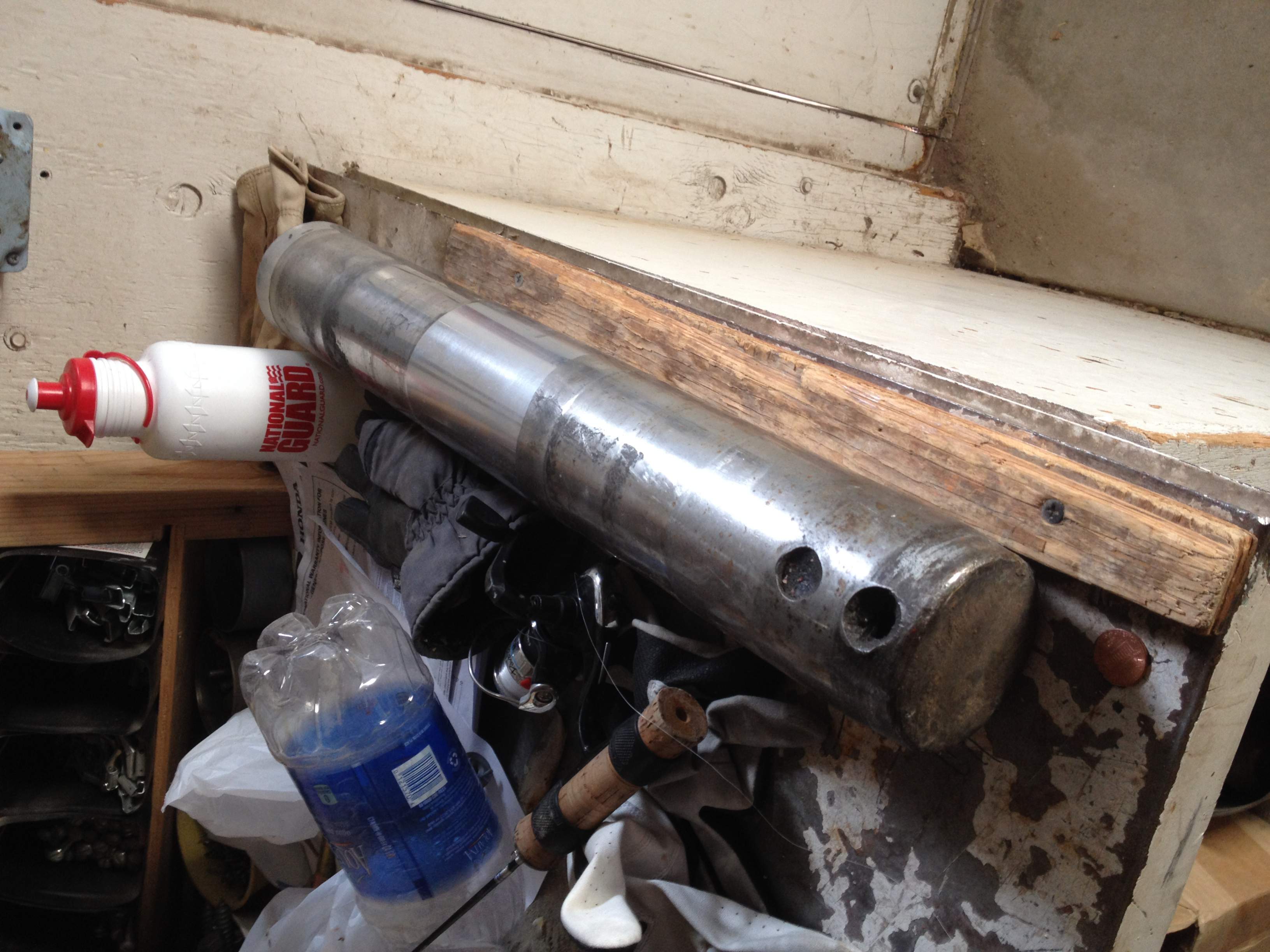

Ran across a piece that I might be able to use for the project. A old bucket pin for an 892 John Deere excavator. Nice big solid chunk of steel that I think might work. Now I need to find a piece of pipe for a sleeve.
<img src="http://www.tractorbynet.com/forums/attachment.php?attachmentid=408116"/>
I wonder if you have a hydraulic shop nearby if they have a scrap cylinder they may give you cheap. Use the piston and cylinder from that. Kinda weird I guess, using a cylinder to compress a cylinder???

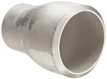

If you're going with 4 inch pipe, just use a reducer at the end. This will force everything to compress pretty good, and it might eliminate the need for an end plate.
That is an interesting idea. I'm going to have to give this some thought. I love repurposing junk parts that require little modification and that would certainly fit the bill.
Tim
I have considered this am and unclear if that would actually work. I guess if it didn't want to come out I could trim the reducer back a little bit to make less resistance. I love the simplicity of that. Could probably rig up a hydraulic knife to make the pieces a uniform length.

This is what I am thinking of using as the basis of the project. After i do some simple testing with my existing log splitter. I'm just going to use pipe and see what happens.
