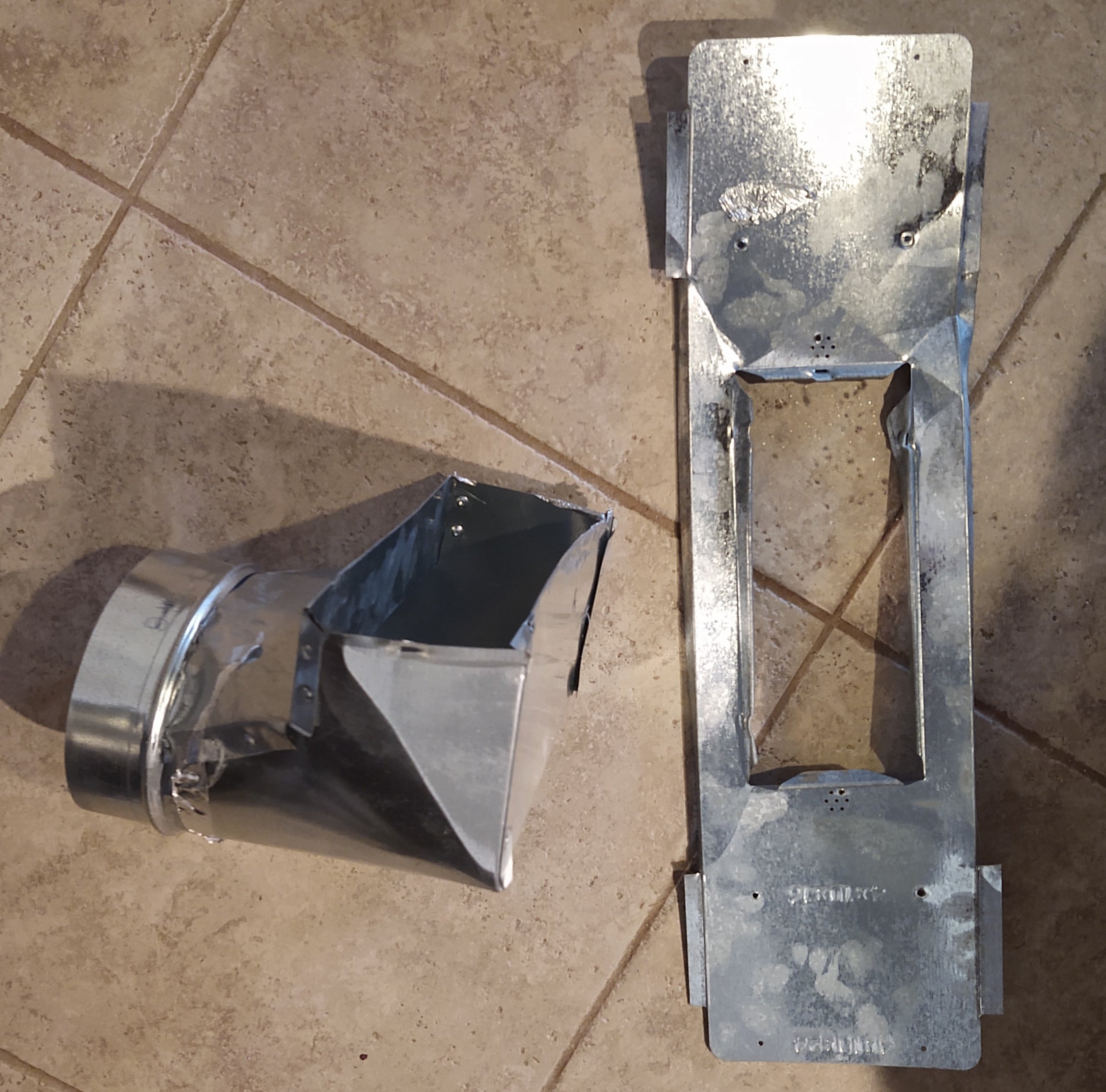

What I'm looking for interfaces BETWEEN what you show, and the actual 6" elbow. right now, I have the flexible ductwork up there, flopping around (dangling down) so it needs to be anchored in place. It's between the joists. They had this metal thing, mounted to the joists and this is what held the ductwork and vent.
I'll be getting a picture in a minute.
/ HVAC ductwork question...
I'm laughing. If you knew the gymnastics I had to go through to get this... heh.
Anyway, the flex pipe comes out the wall at the ceiling. I need to turn it 90 degrees. They had the boot thingy. I bought a 90 degree fitting that you can rotate to change the angles. So I've got the vent coming out of the wall, into the 90 degree fitting...but need something to hold it in space. They had this item sitting on the right.
It was mounted to the joists, the pictured duct was mounted to the holder and all is well.
I've converted to a ROUND vent so would like to find the item on the right, except with a round cutout verses rectangular.
Given I've got a picture, this is more than 1,000 words!

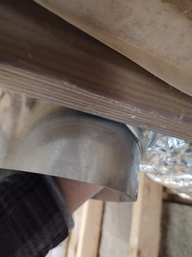

One thing I think I discovered this morning (keep in mind this room was an addition, they left the 10" joists because they either screwed us or since it's a small room.... but this is a different conversation)
Anyway, I've noticed that this ductwork is going to be a snug fit up there. Since it's a "plastic" (no idea what it's made of) liner that attaches to the duct, then it has insulation around it.....it's flexible and looks like it WILL fit.
The issue is going to be by the time I turn the 90 degrees to bring it below the face of the joists... it's going to be extended maybe 1 1/2"-2" because of the depth of the space (or lack of). So I can see that this is maybe why they used the pictured version, it takes up less depth.
Ultimately, all I need to do is bring it into room (ducting already there) attach it to a plenum or something where I can have the air coming in, turn 90 degrees so I can bring it through the drywall and I've got a 10" space to do this.

Item on the left is a simple 90 degree sheet metal boot, round connection from flex to round part (rectangular part to fit the size of rectangular diffuser), then the item on the right is a plaster frame, which the boot connects to.

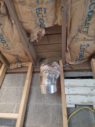

Got two more pictures in place.
You can see how it's currently hanging. They used that brace to hold it up. When I push it up, I have a couple inches of over hang. I figure I can trim that down so I'm not terrified by it, just another bump in the road. If however, I made it straight, I could avoid that and box it in.

Bring duct into the wooden box, then cut a hole in the bottom for the output side.
Don't bring conditioned air into a wooded box. What you want made up is a insulated metal box that you can tap into to move the air where you want it to.
Keep in mind, this could affect your airflow as I'm assuming your bringing in the air from the main trunk duct.

"Plaster Frame"
Thank you!!! Now that I can search on that, I've found it and that is it.
