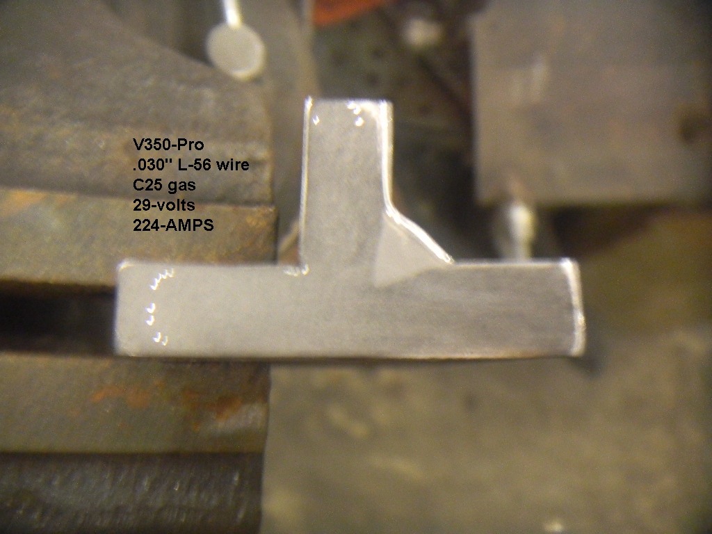

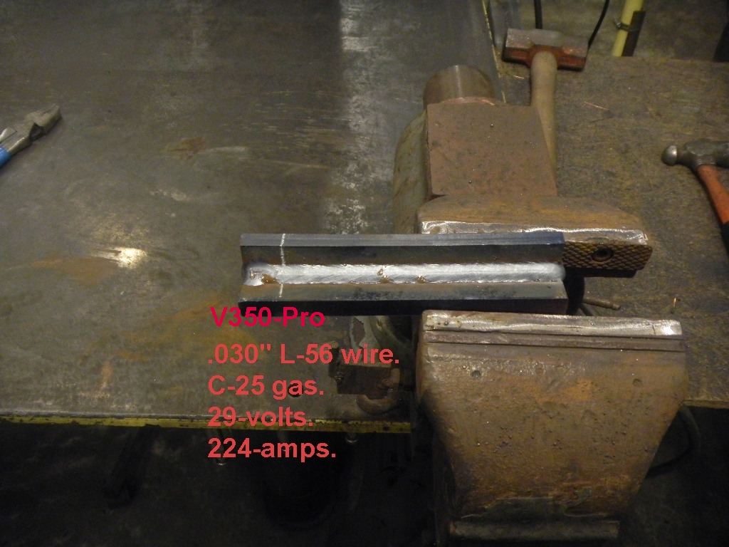

So I am going to go with ArlyA fish plate design. Still working on steel thickness, probably a 3/8 piece I have will be the answer.
Still more questions though.
Would you Mig this or Stick this?
Is Co2 / Argon heavier than air or lighter than air? Wondering about the purge I am planning.
Finally, I assume that the fish plate should be a bit (1/4" or so) smaller than the piece I am welding on to. Meaning, I do not want to make the weld from the side but from the top.
/ How to fix this crack #60
If you have a powerful enough Mig welder, by all means use it. I just love Lincoln's L-56 Mig wire. If you are going to use a stick welder, use 7018!
