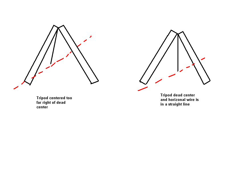

Beenthere, I think I understand your tripod idea. If you clear the top of the hill so that the line is suspended from the ground, a very taught wire will want to pull itself straight.
With that said, if you have the tripod in the incorrect location in the center of the run, the horizontal wire you stretch will want to pull your vertical wire to one side or the other. When you hit dead center, the vertical will be exactly plumb. I have drawn a picture. Please let me know if this is what you mean:
Thanks,
Joseph
Thanks,
Joseph
Great drawing. Just the way I envisioned it. And a plumb line hanging separate from the top of the tripod should help verify being on-line. Setting up on the top of the hill at minimum, and other locations if the wire wants to drop to the ground, should do the trick. Maybe just a two-leg support would work, as long as it doesn't fall over (and it shouldn't).
I'd think that would get you pretty close to being straight.
Now, you won't hurt my feelings if you try something else suggested. :)
