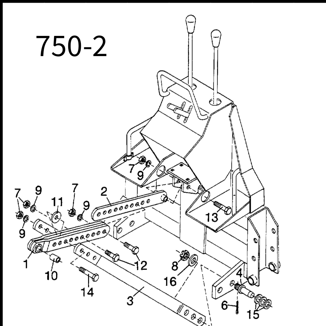

Looking at the mounting for the 750-2, it's nothing fancy:
2 heavy plates to catch the 2 (or all 4) bolt holes where the 3 point attaches, 2 pieces of heavy angle going up to catch the top link bracket and off you go.

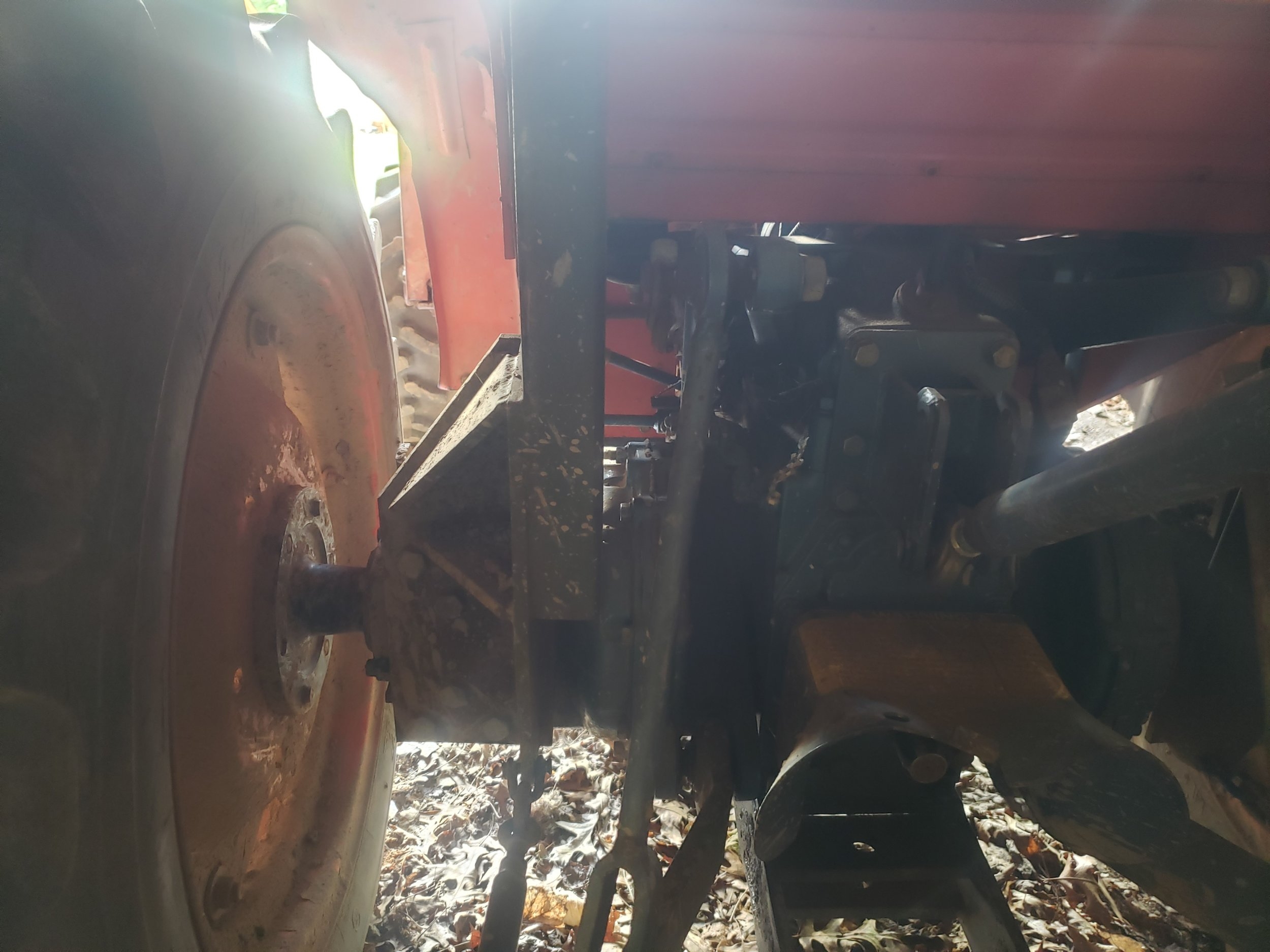

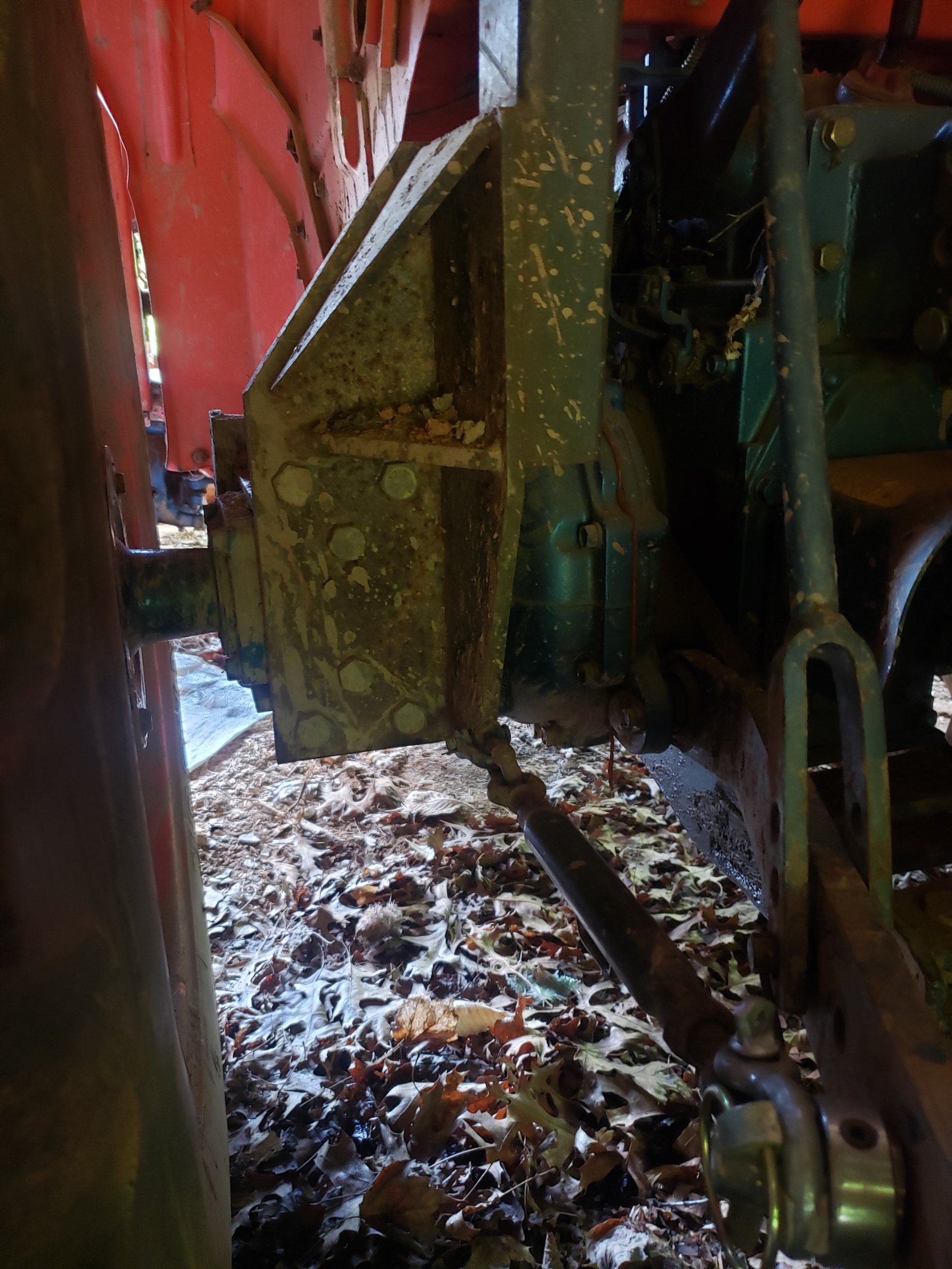

Hello all, first time here. Found this thread researching subframe builds. Very informative info here. I have a kioti lk3054 and bought a back hoe for it. Its a long 1199a. I was going to just 3pt mount it but after searching and reading im not going that route at all. Subframe it will be.
Question 1, is the fel frame a good place to mount to the front of the tractor?
Question 2, what about were the rops mounts to the rear axles?
Not alot of room close the the tractor housing itself so I thought of stepping it out to hit both these points to tie it together. Ill run some bracing to exsisting holes to the tractor as needed. Just seeing if these are two substantial places to start the main frame. Thanks for any advice.

Rear pic
1) The FEL subframe mount is an excellent place for your front support.
2) I have used the ROPS mount brackets for some of the frames I have made. If you can mount your subframe around and above the rear axle housings, attached to the ROPS brackets, that has advantages. you don't want to hang the subframe fully under the axle housing, if practical, since that lowers your ground clearance.
Definitely include a connection to the toplink bracket for added stiffness.

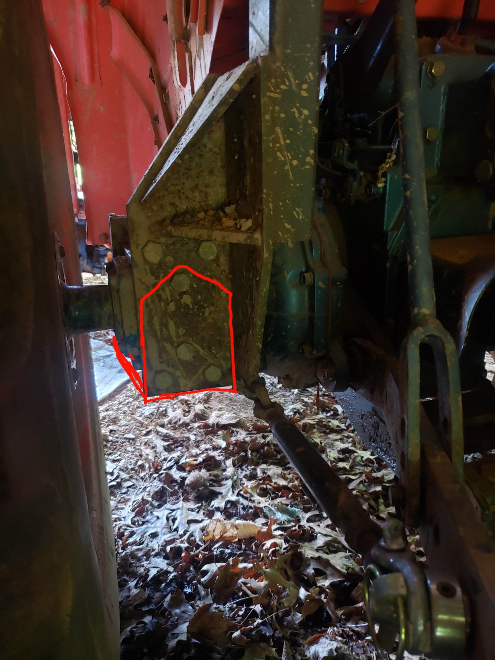

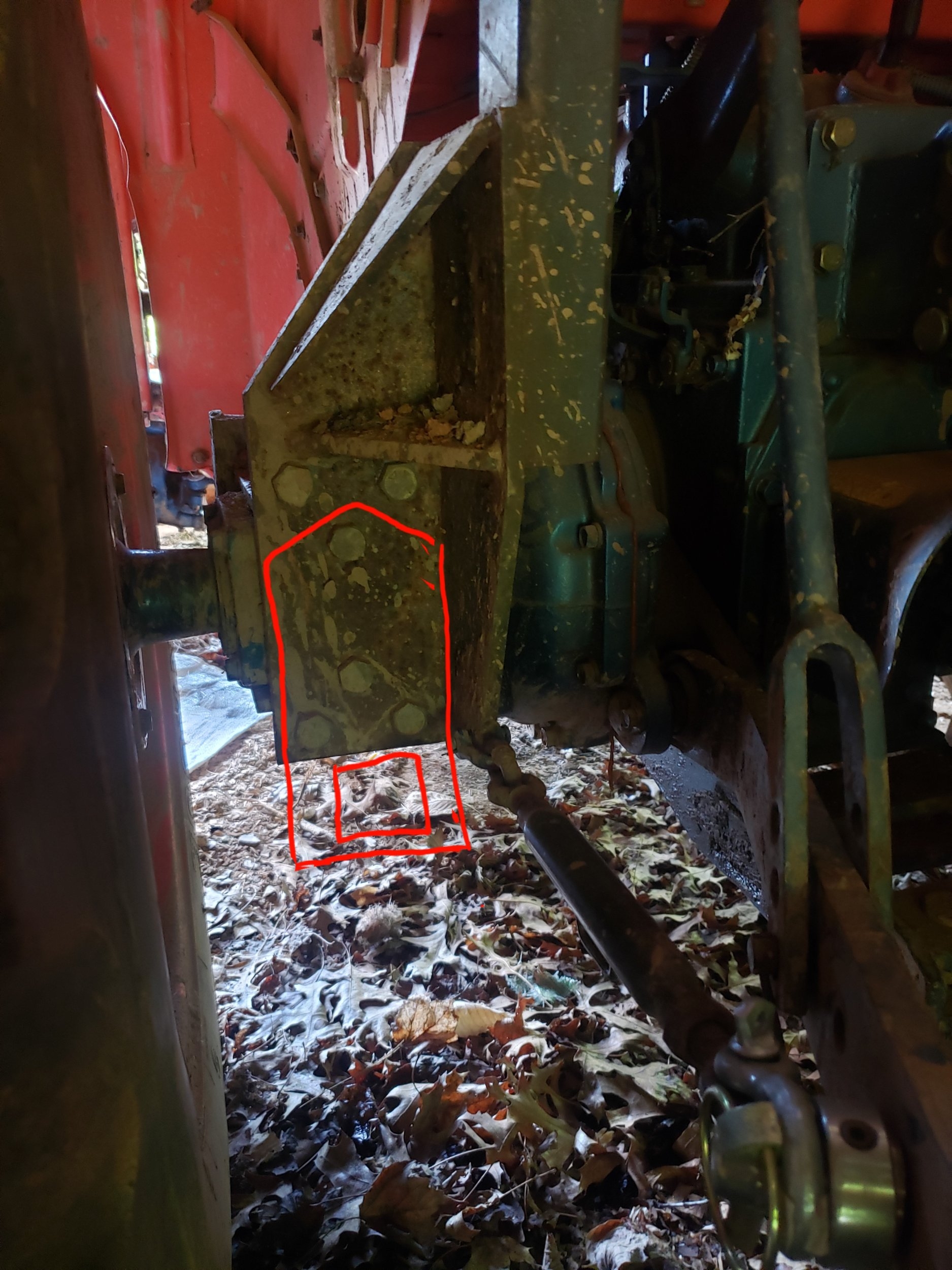

Thanks dfkrug, there's very little room over the rear axle. If I go under the axle it shouldn't be any lower then the center section of the axle/tractor. Only going through ruts..lol.
My thought was to add a bracket to both sides of were the rops attaches to the axle then weld a plate to the bottom of the brackets or weld the square tube directly to the brackets under the axle. I drawed
the brackets in red in the picture if I can get more then one to load at a time. Another question..is the draw bar safe to use? Thanks again for the help.
