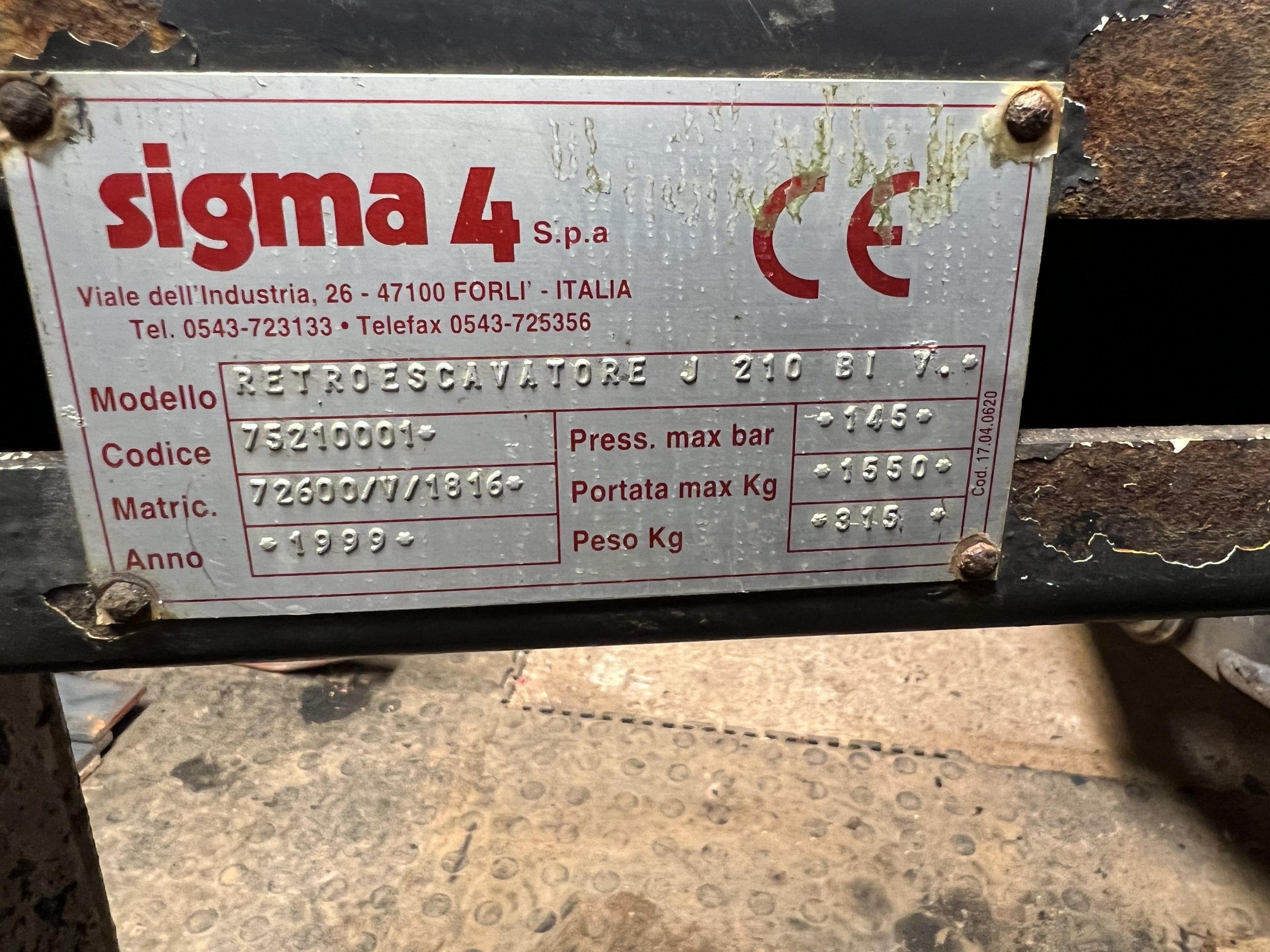

Are you sure your hoe is only 600#? Any side-view pix of it, with something nearby for scale? That is a pretty small Kubota.
I am for close-coupling the hoe to the tractor, for sure. I see you have the rice paddy tires. You can get away with as little as a finger's-width spacing there, but it will require walking on the rear tire to mount the hoe seat.
Here’s a photo of its plate. Originally 315kg. It is only a little one. I haven’t really used it much. So don’t have many photos and now it’s in my garage it’s tricky to photograph for scale. I’m using an extra wide angle lens on these pics so it may skew the scale some.
those are the tyres I got it with. Quite aggressive!

Your wide-angle lens explains why the photo makes it look big.

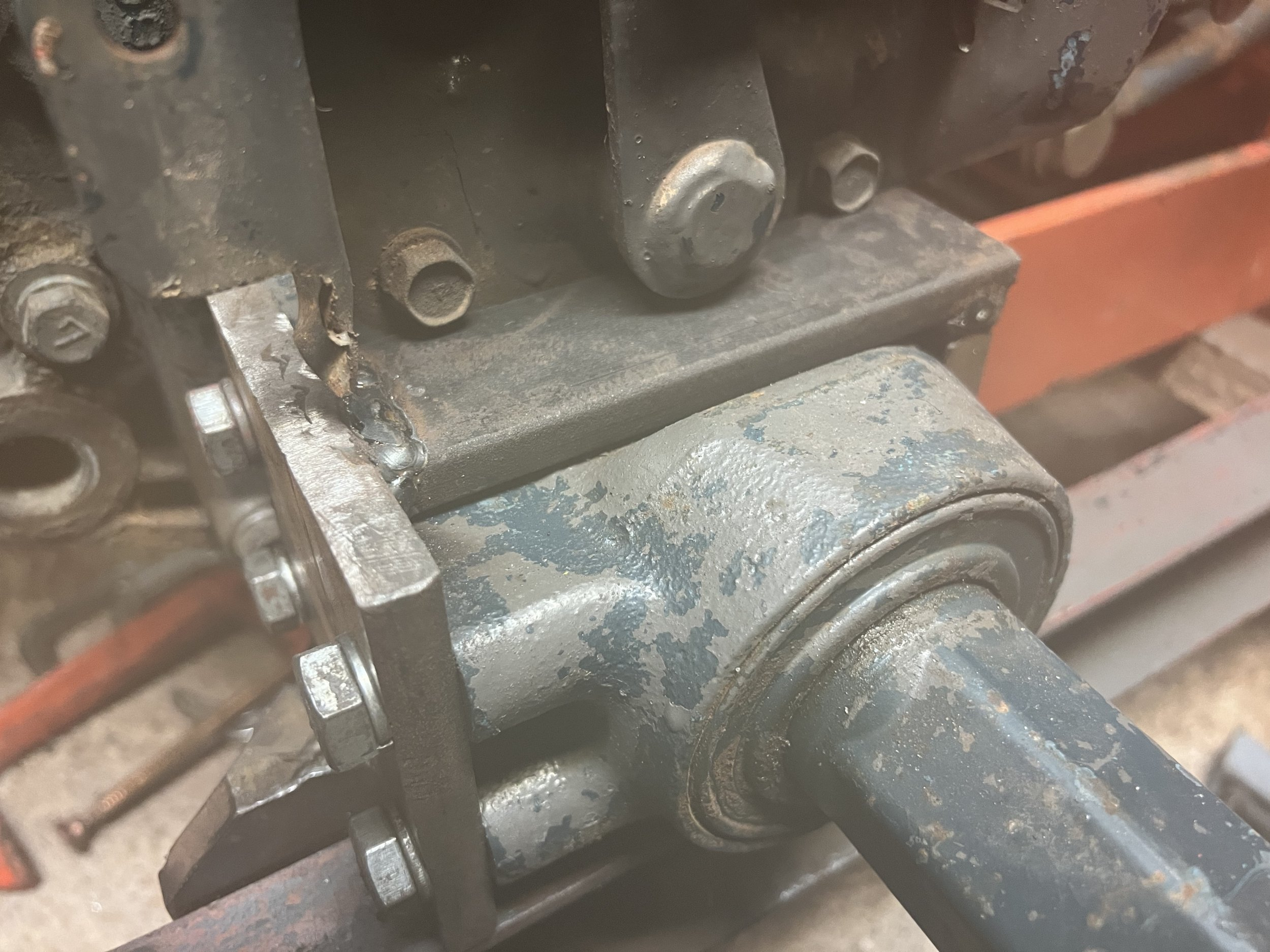

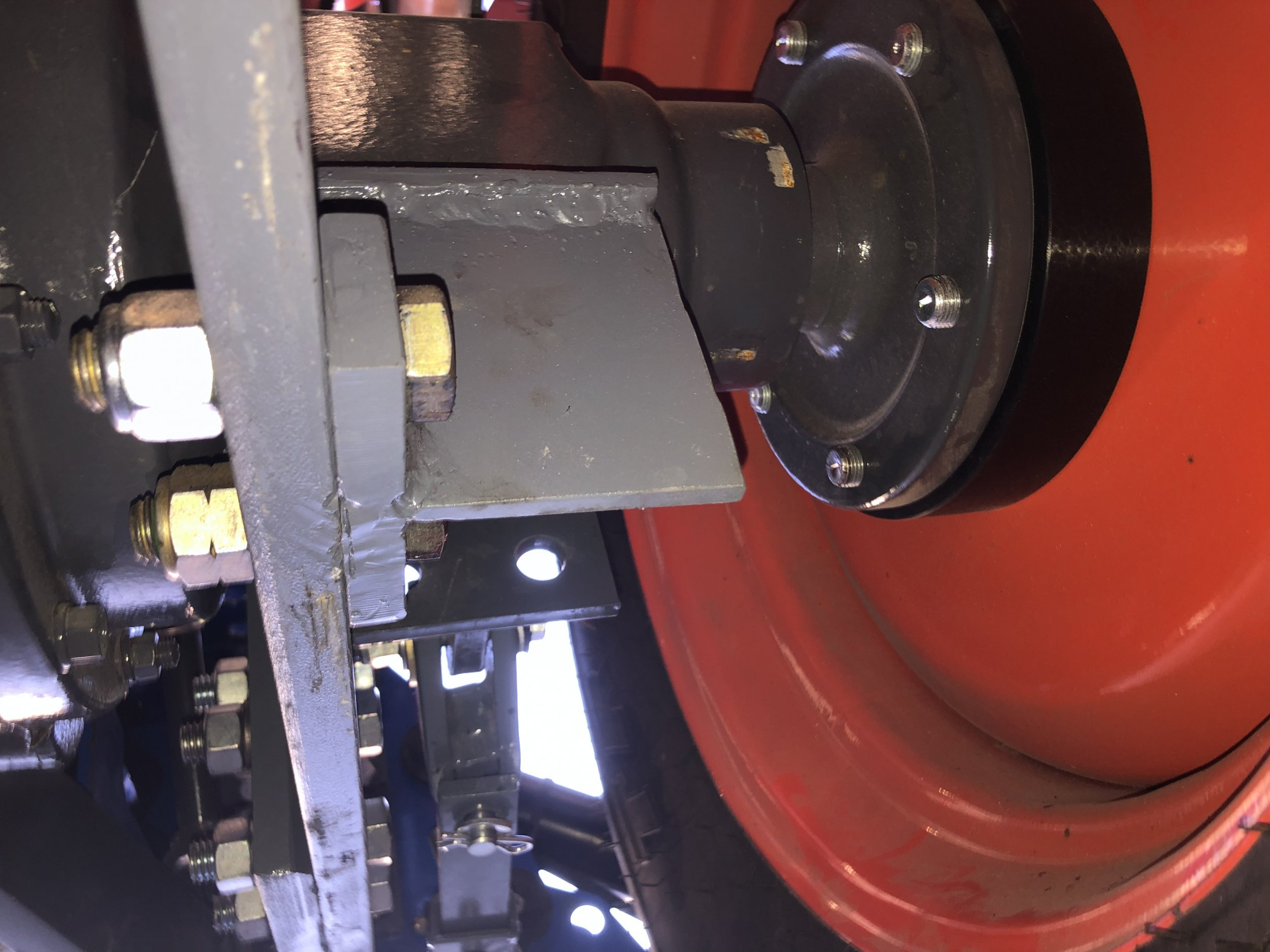

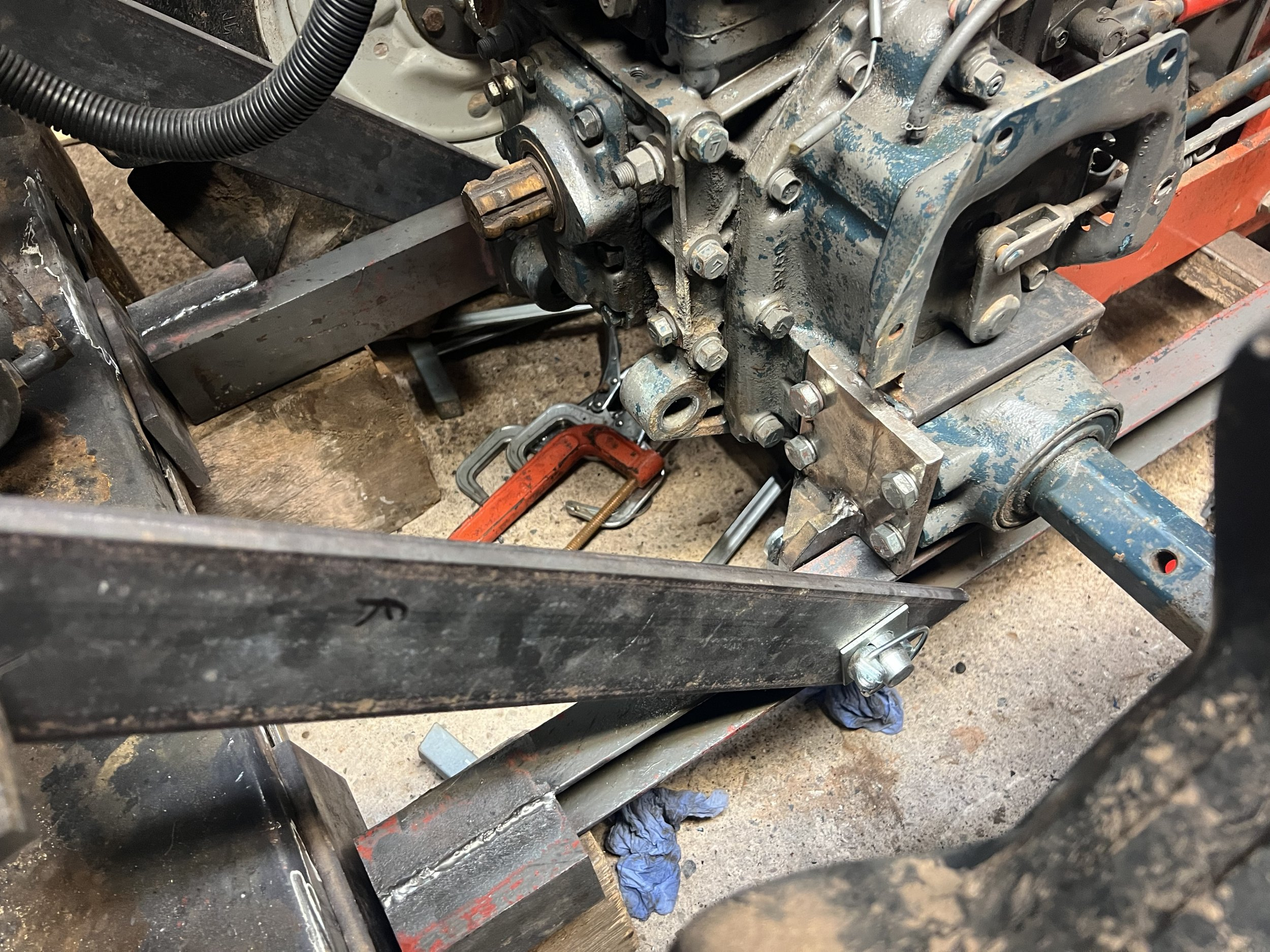

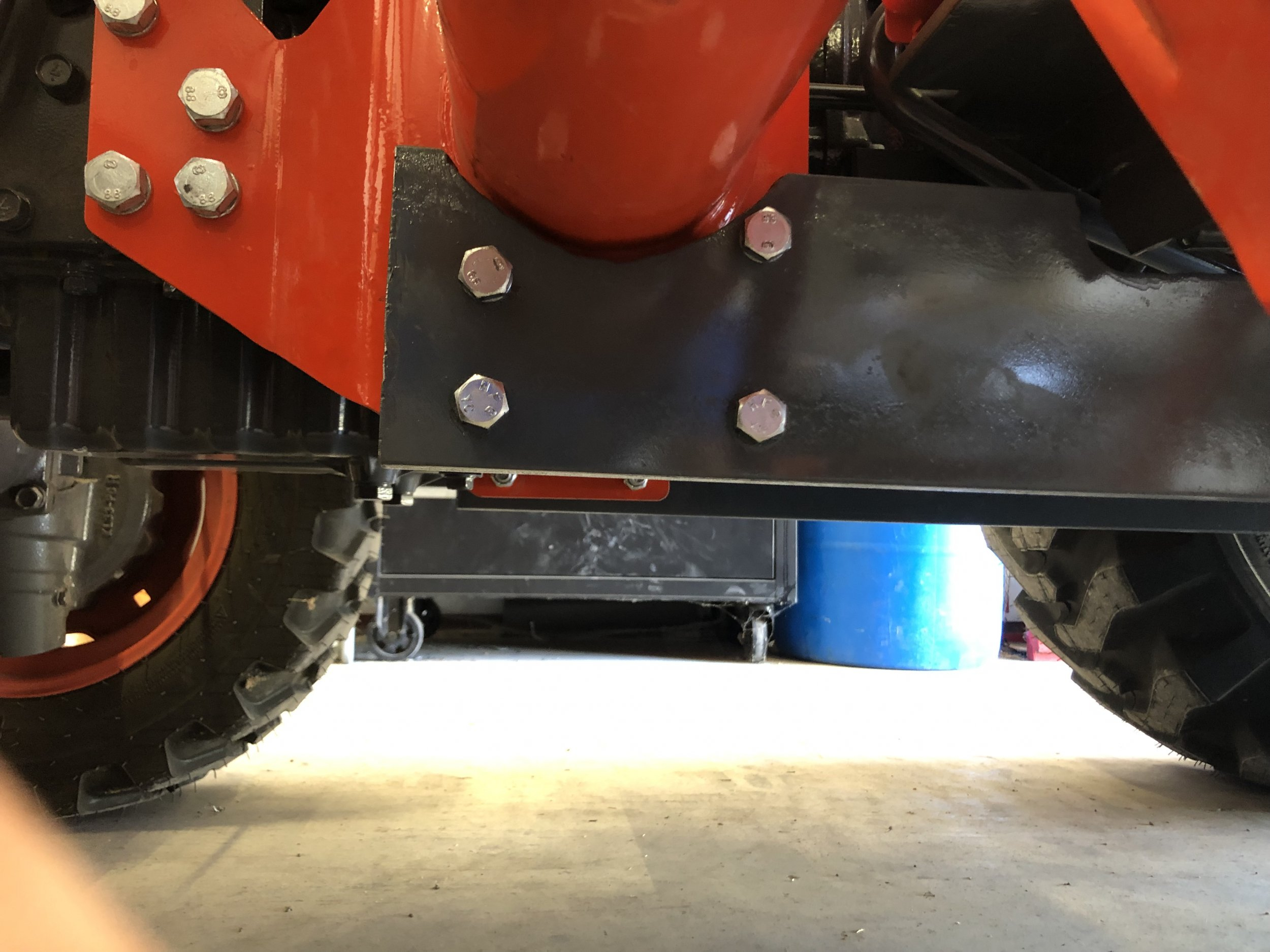

Got the tractor side attached. Might beef up some more of the welds.
I ended up adding some extra support to the rear axle mounts. They are still removable if needed. But I suspect I’ll keep them on permanently.
I’ve gone with pins. I’ve shimmed them so they fit tight. Maybe too tight, so they’ll become a pain to remove. Time will tell. I can switch to bolts with welded nuts if it doesn’t work out.
Hopefully going to get the hoe side welded up and get the rungs on the ladder in the next few days.

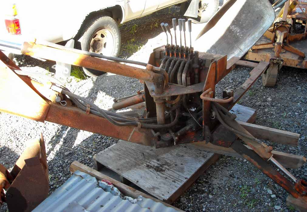

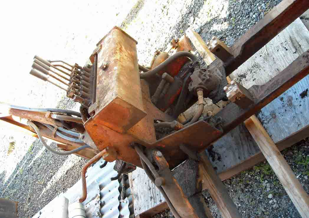

That makes sense. These old Kubs have quite the following. Here is an old Kubota K629 backhoe attachment for old B-series CUTs. With custom subframe and PTO pump. I posted about this hoe before, and it continues to sit, unused, in a friend's backyard.
Hmm, I wonder if that's the one that fits on my old B. It would be fun to dig some trenches with the old girl. :)

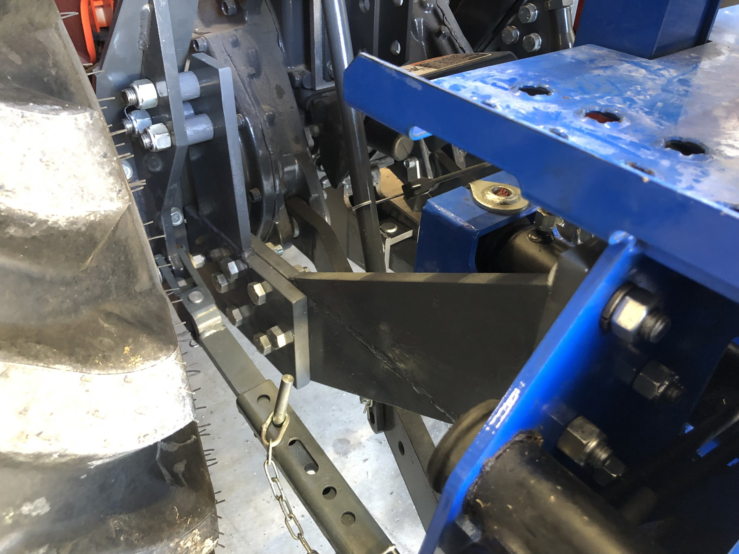

I figured I would add to this thread. Just finished subframe for New Holland 915GH to my Kubota L2501. Purchased at auction for $900. No bucket. Using 5”x3/4” flat stock, I mimicked a typical bh77 mounting from front loader mounts to axle and rops mounting. Using a bolt up connection for mounting plate to backhoe. A little tedious on removal/reinstall, but strong and easy to build. Bought bucket from Titan and modified to fit.
Used a couple of tips from this forum(thank you). Also do not have to remove 3 point hitch components. Total all in about $1600. Could not justify 10k + for bh77.
   / how to build your own custom backhoe subframe
#160
I do not know that hoe. Does it have a toplink connection under the seat? If so, I would connect that to the toplink bracket on the tractor for additional stiffness.
It is a good thing to see how much flex you get while digging. This takes 2 people; one operating the hoe, and the other looking closely at the frame at the rear of the hoe.
Looks good. Killer deal.
