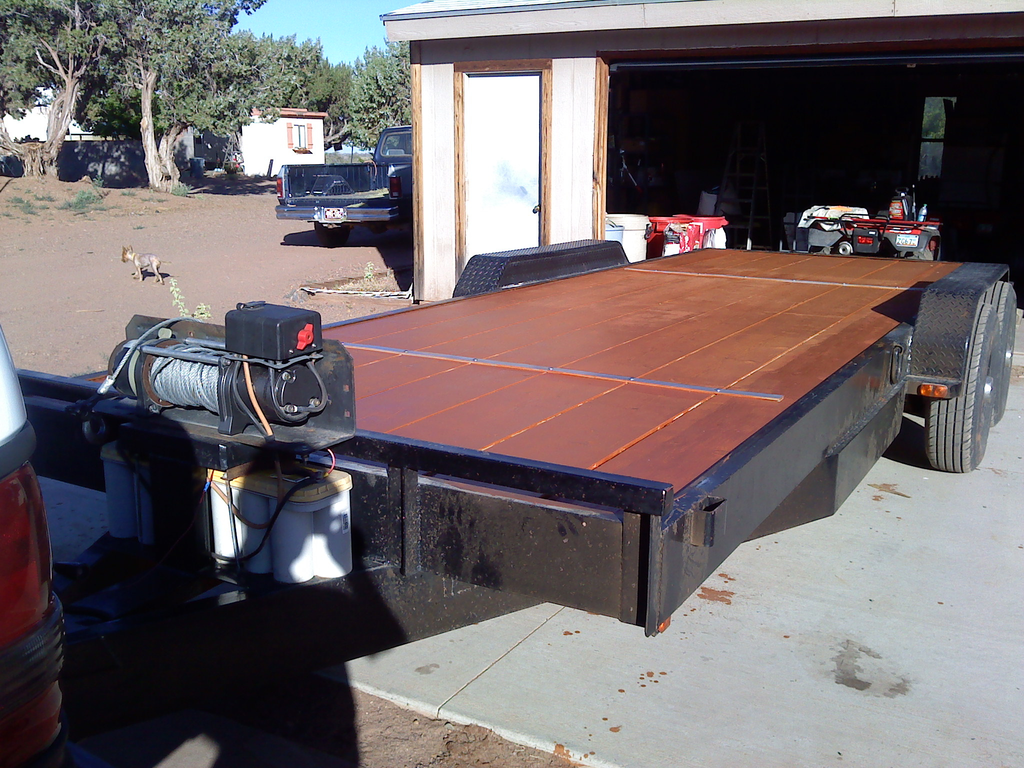

Bought a 10k rated dual axle trailer with brakes on both axles and auto stop box and wanted to add a winch to the front to hoist either of my tractors onto the trailer if they fail to crank. So I bought a HF 5000 pound rated winch and was planning to have a mount welded to the trailer for this purpose. Now, a buddy of mine who does a lot of welding and has built trailers from scratch tells me he had a 5000 pound Warn winch on his trailer and it would not pull a Ford Mustang onboard. He says I need to buy the 12,000 pound rated winch at least for tractors. Has anyone else had experience with winching tractors on trailer? How about opinions on Harbor Freight winches, especially the 12k models?

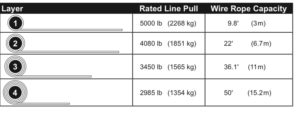

Remember the winch rating is for when there's only one layer of line/cable on the winch. Each subsequent layer of line/cable is rated for substantially less. So if you are pulling with three or four layers of line wound on a 5,000 lb winch spool your actual pulling power may be a half that or less. I seem to recall that Warn had a chart on their website at one point that showed the actual pulling power at each subsequent layer of line.
