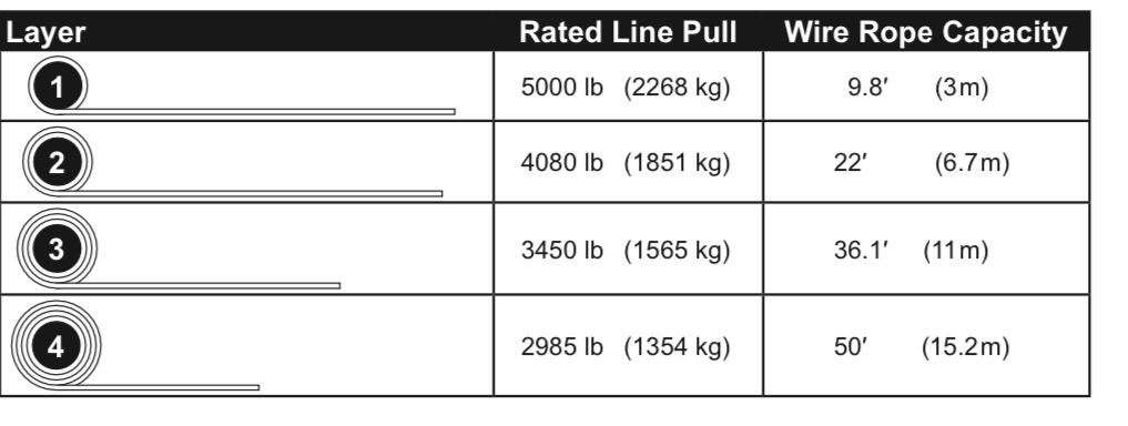

That is all good information. Where did you find this?
Go to the HF web page for the winch, then download the owners manual.
Bruce

Yep, it's a 10,000 winch then.
Doubling using a snatch block is certainly useful but has several caveats. Namely it runs at half speed, you have 1/2 of your usable line length (irrelevant though if you are just loading a tractor), takes a bit longer to set up and put away, and all of your rigging components need to be rated for 10,000 if you are actually pulling that weight

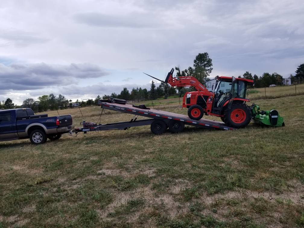

This is as far as my Harbor Freight 12k winch could pull my L4060. As it sits with the loader & flail, probably 7k lbs or so. Tractor ran fine other than leaving it in gear with the brakes locked. I was testing out the 2" reciever welded on the front of the trailer to see if everything would hold. Welds, front brace & cheap Amazon winch cradle all held up.
It would pull things fine if it could roll at all. If the drive train was locked up I'd have to double line it.
Only used the winch 3 times in the few years I've had it. Loading some logs & 2 dead but rolling vehicles. Nice to have just in case though.

I have a trailer very similar to the one in post #24. I used a 2 ton come-a-long to load a 1993 Cadillac STS and had to resort to using a snatch block to double the power in order to get it loaded.
Only used the winch 3 times in the few years I've had it. Loading some logs & 2 dead but rolling vehicles. Nice to have just in case though.View attachment 767513
Good to know. Nice picture.
