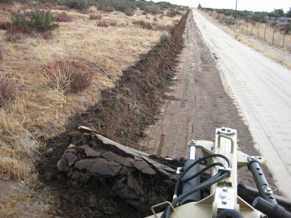

The point made regarding the length of the blade or box and the pivot point from the fixed arm is a good one...
Of course, another way to increase the degree of tilt (one way or the other) is to change the offset of the blade; extend the blade either direction - right or left.
My 7' rear blade is offset a foot to the right (location of the tilt cylinder) so, when I tilt the blade up or down - the resulting angle is greater for every inch the cylinder moves compared to when the blade is centered along the horizontal plane of the 3pt arms.

Re-thinking my earlier post... I guess the angle does not change relative to the plane of the 3pt but the change in the amount of material that the far end of the blade cuts is dramatic! :D

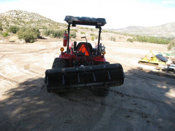

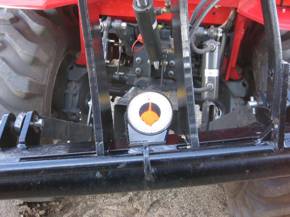

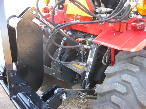

Here is some more info regarding my "TnT" setups. Both of my tilt cylinders are set so that the hydraulic is at mid stroke when implement is level.
My cat 1 has a 2x4 cylinder. I get 8 degrees of angle in each direction. With a 66" wide implement that is about 8" of movement in each direction on the cylinder side.
My cat 2 has a 3x8 cylinder. I get 11 degrees of angle in each direction.
With an 81" wide implement that is about 12 3/4" of movement in each direction on the cylinder side.
I guess what I don't understand is why do you guys want to be able to cut a steeper cut? It's not like you are going to get a 22 degree cut 18" deep in one pass. :confused: And for those of us that have rear blades with tilt, between the side tilt on the 3pt and the rear blade tilt, we can get close to 45 degrees if need be. So with just the 3pt, if you put your tire in the first cut ditch, then the second time you can get around double the angle of the first cut. And most likely you will need to make at least 2 passes anyway.

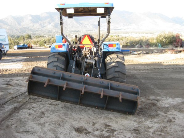

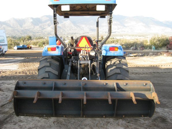

Brian if you refer back to posts 25 or so I have a picture of my boxblade and your post below it has a picture of your rearblade. In my picture that is the maximum amount of tilt I can get with the single cylinder but that is with a range from level to this tilt angle. If I add a second cylinder it is to provide tilting the same degree in the opposite direction.
With your all hydraulic blade I can't see where you would benefit from this until you changed to a different implement.

Steve, do you know, or can you check how much of an angle you can get on your box blade? Maybe check how much travel you get with your hydraulic side link. It looks like you might get 15 degrees?
OK, I guess that I understand your reasoning. So if you have your hydraulic side link set at the midway point as I have mine, then your implement is too low to the ground for your liking? :confused: Or you just want that much tilt angle.
